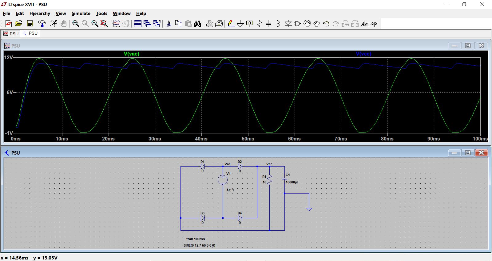

Have a look at this. Here is a 9 volt (so 12.7 volt peak) transformer feeding a bridge rectifier.
Notice how the peak voltage equals the transformer peak voltage less the diode volt drops.
Also notice the ripple voltage across the cap. That voltage must never dip below the regulator drop out voltage.

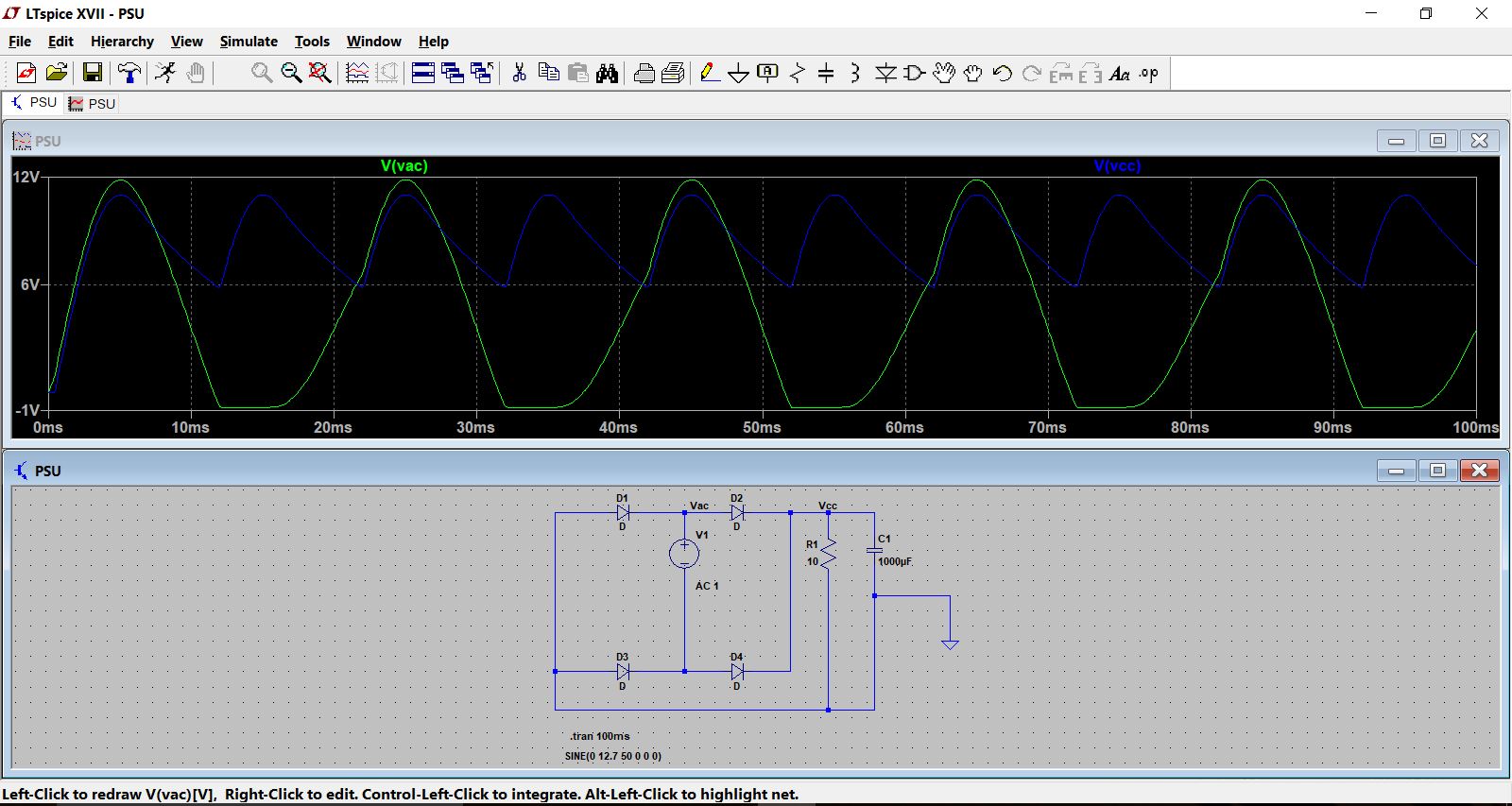

In the second picture we have made the cap much larger to reduce ripple.

Thanks a lot again, thats very pedagogical 😉Have a look at this. Here is a 9 volt (so 12.7 volt peak) transformer feeding a bridge rectifier.

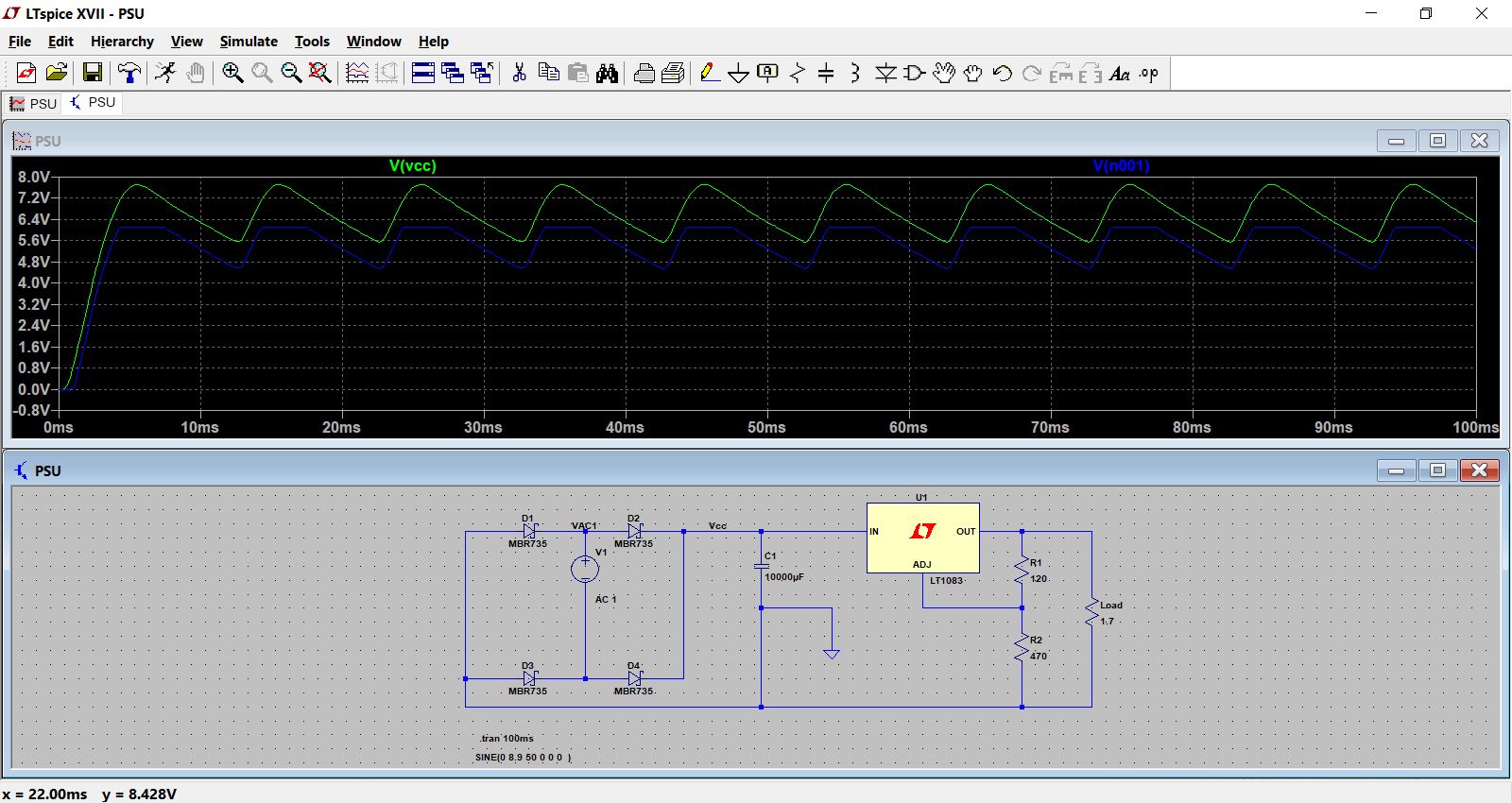

I am probably thick skulled but can I ask how you estimated that (the 7.5)?Its to tight for comfort imo.
6.3 Vac is only going to give around 7.5 volts DC under heavy loading and with a large reservoir cap.
It seems 16% lower than expected, so if this is the regulation you compensate for I don't understand why it is necessary to adjust for this at full load at all, if the nominal voltage also is indicated under full load. Seems to me it would be necessary to adjust for regulation under small load, and adjust it upwards. I clearly have it wrong
The transformer regulation is something you have no control over and is simply the amount by which the secondary voltage will rise at light loading. At full load the voltage should be equal to the rated voltage.
So 6.3 volts multiplied by 1.414 (root 2) gives 8.9 volts peak. When we apply that to a bridge rectifier we have to include the two (because there are always two diodes conducting) volt drops of each diode. A normal silicon device drops around 0.7 volts across it when it conducts. So we subtract 1.4 from 8.9 to give 7.5 volts DC.
6.3 volts is the stated voltage of the transformer and is correct when the transformer is loaded. When drawing little current that voltage will rise by the 'regulation percentage' of the transformer.

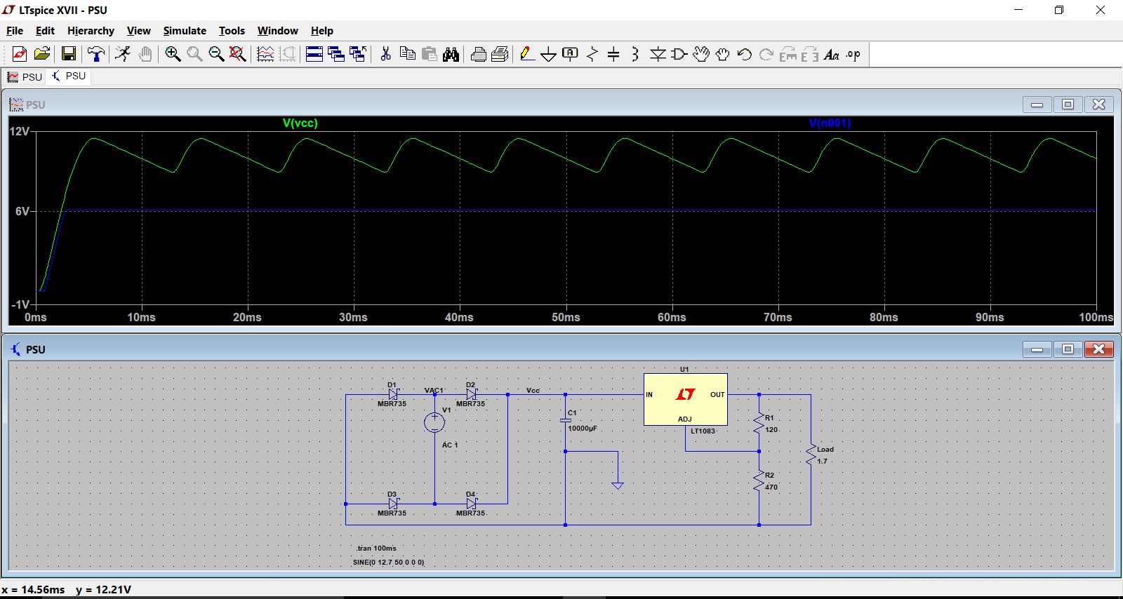

Look at the ripple voltage in post #9. That is the problem. The DC voltage 'peaks' at around 7.5 volts but then falls as the voltage has to be supplied by the reservoir cap until the next half cycle comes along and tops the cap up again.
So when we draw current from the DC rail the ripple voltage increases. Look at the dips in the voltage that go below the regulator drop out voltage. Those are the problem.
The smooth DC when lightly loaded has changed to 'dirty' DC with lots of ripple as we draw higher current.
