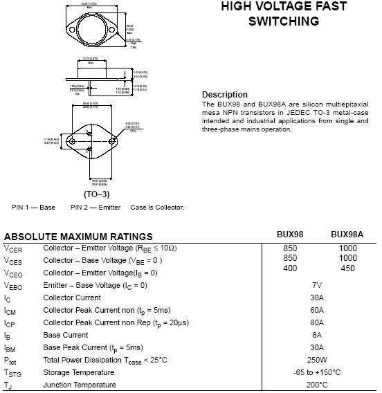

hi all,
noyan emailed me and asked me about wether it is alright to use a BUX98A in this PS. He sent me the data sheet which i did a screen shot of, and cropped down to attach here.
i told him to come here and see what other people have to say, but for now i am saying (guessing) that based on the ratings of this device, he should be fine to use it with a voltage doubler as oposed to a straight bridge safely because it looks like it is used as a sort of floating regulator, where it's referenced off higher voltage than ground, so pot. diff on all conections should be within ratings right???
