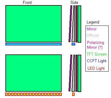

I fully understand the Star-O's, and how incredible they are. 🙂 I've posted about them extensively, including alot of calculations about them. I think they're wonderful.
I mainly just want to spend $25 or so in LED's to see if I can get a reasonably bright image with a simple LCD panel, and not have to mess with the heat sinks and other such things of the Star's.
Also, to line an entire LCD panel bottom edge with Star's would cost a fair bit of money (in order to get even distribution)... If a row of 10k mcd's is a whole lot brighter than the single CCFT that normally lights LCD panels (and you can project an okay image just using that CCFT), I think we can get a pretty good image if the row of LED's is 5x or 8x brighter than the normal backlight.
Thoughts?

I actually want to illuminate the LCD from the side, as in the attached picture.
This uses the existing optics (which spread it evenly), and just replaces the light source with a much more powerful one.
However, as I really have been unable to find information regarding the brightness of a CCFT, I don't know how much brighter a row of LED's would be.
Anyone know how bright a row of 10,000 mcd LED's would be in comparison to a standard CCFT? If it's not at least 3x brighter, I don't think you would get a decent projected image.
--Clint

The Luxeons require a heat sink because of the amout of power they can generate. Using standard 5mm LEDS, will generate as much heat (actually more because they tend to be less efficient), it just won't be concentrated in as small an area.
If you want to backlight an LCD, the standard Star is not the way to go. Luxeon makes a side emitting LED, essentially a Star with a cone on top that makes the light go out sideways. This will make it much easier to design. However, the way to do it is not with white LEDS, but with Red, Green, and Blue Luxeons. The basic design of a side lit backlight makes the mixing of the LEDS colors easy. Luxeon has a demo backlight for I believe a 15" LCD that if passed through a panel would generate somewhere on the order of 1,000-1,500 NITS, maybe a bit more. I believe it uses somewhere on the order of 28-35 Luxeon LEDS in a combination of 5 watt Blue and Green Luxeon's and 1 watt RED Luxeons. Mitsubishi has just released commercial panels using Luxeons, but not as bright:
http://www.lumileds.com/newsandevents/releases/Dec_04_2002_Mitsu_PR.pdf
However, at this point in time, you could generate the same amount of backlight for about 1/2 the electrical power with CCFL tubes.
For the Luxeons, you can order any that they have from http://www.future-active.com/ . They are the official distributor for the product.

Alvaius: I guess I'm not looking for a huge number of NITS, in fact I don't even know what standards are for that number. Do you not think a row of high-output LED's would work Alvaius? It's simple, it's cheap, and I think it could work. Why would you agree/disagree?
Thanks.
--Clint

Thank you for adding absolutely nothing to the conversation Remp. You can take all the shots at me you want, but if you read my post I am not telling people not to do it, just cautioning them on the results. In fact, if you actually read my post I tell how to best produce a backlit LCD using high brightness Luxeon LEDS. I am sorry that it bothers you that I like to prove out concepts on paper before committing time and money. That way I can save the time and money for the ideas that have the best chance of succeeding.
To that end, Han, would it work and be bright enough. That depends on how bright you want your image to be.
For me personally, something on the order of 500 lumens is suitable for a good size image in a dim room. I would like brighter, but I can live with this. Dependent on the LCD, you may be able to get 15% transmissivity. If I had to hazard a guess, taking the backlight efficiency into account, the optics efficiency, etc. I would expect that at best, you would get 50% of the light out that you put in. So, the overall efficiency will be on the order of 0.15*0.5 or 0.075. Light input will need to be at least 500/0.075 or almost 7,000 lumens. For arguments sake, let's say the 1 watt Luxeon's are on there order of 30 lumens (color dependant, but an okay average). You would need on the order of 200 of them. You could use the 5 watt (actually they are exactly 4 times as bright as the 1 watt) and get that number down for at least the green and blue portion.
In my mind, the minimum brightness that would be acceptable, and this is way on the low end would be 200 lumens, so you could get by with say 80 or so 1 watt units. Those 1 watt LEDS are at least 5 times as bright as any 5mm superbright LED that I am aware of. You can use pulsed operation to get higher perceived brightness, but it is my experience that the superbright LEDS can not actually be run with a high maximum pulse current. You can do it, and it will work, but it will actually very quickly degrade the LED in an application like this where it is run continually. So of those 5mm superbrights, to get good brightness you would require on the order of at least 400 and possibly more like a thousand of them. That sounds like a lot, but I think my math is accurate and I have seen backlights (pre Lumileds) that used on the order of that many LEDS to achieve a solid state, daylight readable backlight for a standard 15" or so panel.
200 of a $10 LED may seem like a lot of dollars, but on a per hour basis, you are looking at 4 cents an hour versus 15 cents for a typical bulb. Of course if you were buying those LEDS in volume, the cost would come down.
I would also be very careful using the white 5mm LEDS. The interaction of the heat from the die, the phospor, and the epoxy tends to degrade the output quite quickly compared to non-white LEDS. I have seen on the order of down 30% at only 10,000 hours and accompanied by a significant change in the color of the output. You are much better off mixing Red, Green, and Blue LEDS for both life time, and then you can control the color temperature of the back light.
