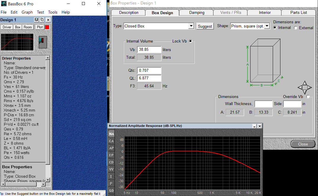

Got a pair of morel MW265 and 267 and the plan is either make -a pair subwoofers or part of my 4 way design (crossed at 500hz) using one of the pairs, although the 267 is in favor since its simply a better driver.
the goal is reaching 30hz before the roll off... but in a sealed box.
from what i have seen around 50hz is the limit for a sealed design with these woofer, but i want to make sure.
so, is it possible?

I got WinISD but either im doing something wrong or the driver simply gonna roll off at 100hz no matter what I do as long as its in a sealed box.You can use WinISD or Hornresp (steeper learning curve) to figure this out.

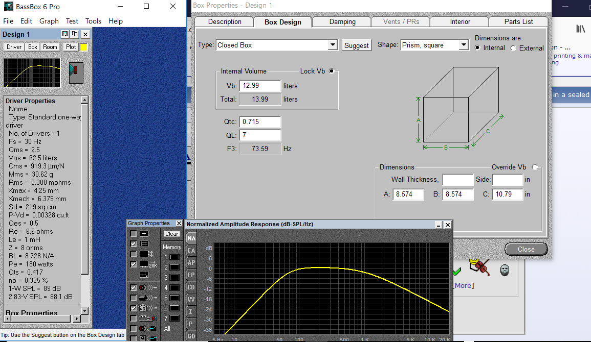

If its not a good idea it doesnt necessarily needs to be a sub then, it can be used as a midbass but the goal is reaching 30hz properly. with the cabinet i got atm (of about 45liter) they reach until 50hz, after that they have extreme roll-off.The 267 doesn't favor sealed or vented. A vented box doesn't look bad but is a more advanced build. I wouldn't use them for a sub.
I just want to get the most of this driver in a sealed design but im not sure if its possible since i dont have the knowledge (which is why i rather go for sealed because i dont know how to plan a vented box.

The best sealed volume for 265 is 21liters and 267 13.5 liters. The good thing about sealed boxes is they are more forgiving in box size.

thats extremely small, doing it would make the opposite of what im trying to achieve, are there any benefits of doing so other then having a smaller sized speaker?The best sealed volume for 265 is 21liters and 267 13.5 liters. The good thing about sealed boxes is they are more forgiving in box size.

about the dynaudio, from what i have seen around the forum the 24w75 likes to sit in a sealed 80-110liter box?
hell, i can do that but someone here just suggested 13liter box so im starting to get confused.
