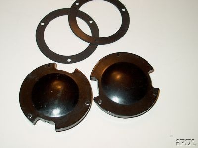

Hey Guys,
Last night I spent a lot of time reading and re-reading Wayne Parham's paper on passive crossovers. Learned a few things. 😎
The peaking problem on compression drivers was making me nutz, but Wayne's paper cleared it up for me. Did a little rewiring of the hi-pass filter on my Selenium dirvers and they went from awful to smoooooth. Makes me less nervous about the 806 drivers now. Getting the damping right is so important.
My driver attenuation was pushing the 2K peak thru the roof. Tamed now.
So tell us about "loading caps." What the heck are they? They are talked about all the time, but I can't figure out what they are. Is a capacitor? Or a part inside the compression motor?
My nasty experience with improper damping and driver attenuation makes me cautious of any cap in front of a horn driver. Even with an active filter it can cause problems if not choosen well.
Greets!
I assume you're referring to the woofer's non-flat break-up modes summing with the horn's output across the XO BW. This is why I recommended the impedance compensation which will lower it. That, or a notch filter can be used. Anyway, you're right, proper damping is key to good performance and what the matching impedance series resistance on the horn is for.
True compression drivers are so highly damped that the small Vb rear cover 'cab' actually represents a near IB Vb, so to increase power handling down low requires the driver to 'feel' a much smaller Vb 'cab' just like a point source driver, hence the loading cap replaces the rear cover (though on most models Altec still put the rear cover over it on ones sold individually), reducing rear chamber Vb to a small fraction, typically reducing it to ~the same as the front chamber's by being shaped to conform to the diaphragm's contour (see attachment). The trade-off of course is a loss of low end extension and some mild peaking at Fc, just like a point source in a Qtc = 1.0 sealed cab.
GM
GM

Hi GM,
Thanks for the photo! That helps a lot. It really is a "cap."
The peaking I was refering to is impedance peaking in the 1" compression driver. That is what was sounding so awful. The big spike in impedance at 2K was playing havoc with the hi-pass filter.
AFIAK a 2nd order filter is a must to run the 806/811 down to 800Hz. As you hinted at above. Maybe even 3rd order would be good.
OK, back to woofer talk now, as that is the subject of the thread. =)

panomaniac said:Thanks for the photo!
Greets!
You're welcome!
Hmm, which horn/driver is this? The driver's peak is supposed to be damped by the horn.
Well, some folks have used the 806/811 with 800 Hz/1st order, but I don't recommend it unless it's not attenuated at all and power limited with a flea power SET amp. Yeah, 3rd order is an option for high power apps, though for whatever reason Altec chose to use the loading cap instead.
