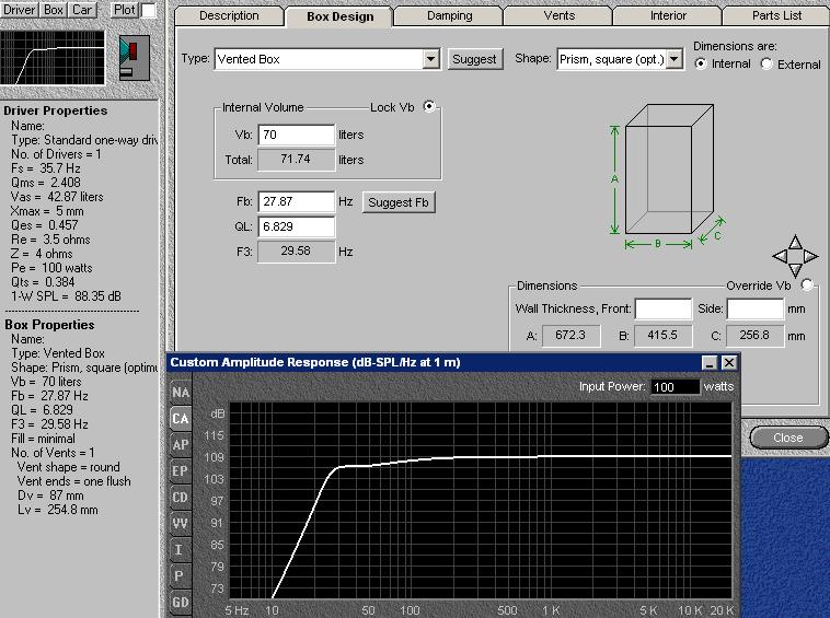

8" Venom Sub from Jaycar.....ported
i used winisd to design an enlosure for this su driver, i am wondering how low i can tune it to saftely, i can fit an enclosure of any reasonable size (140L MAX)
but i would prefer a small cabinet as this is simply a 'fill in sub' until i buy a shiva at the end of the year.
how can i maximise this driver,
thankyou🙂

michael said:what is that program u used to model that???
It's Bass Box Pro. bought it a few years ago, don't know if a trial version is available.
