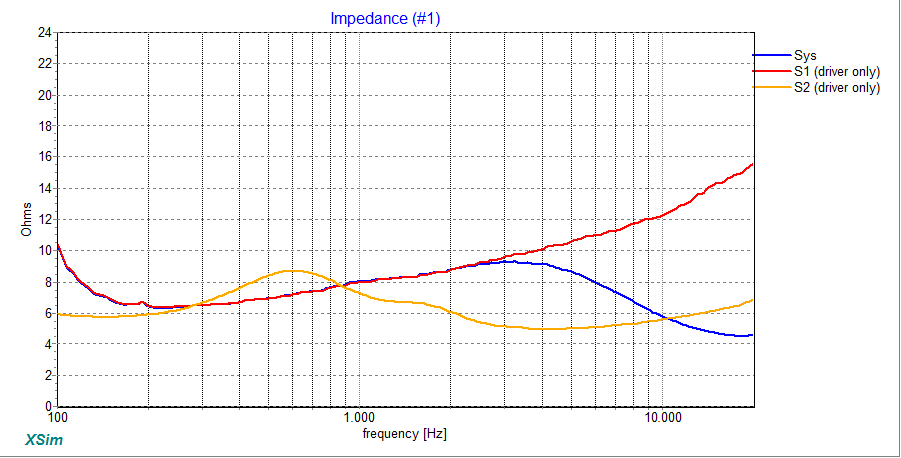

The full range has inductance in the voice coil so its impedance will be higher at the frequency the tweeter starts to be active.
So here you have an example - a 8 Ohm Peerless midbass driven fullrange (red line), with a 6 Ohm Seas tweeter with a single 2.2uF cap as a HP filter (yellow line). The combined impedance is the blue line.
With a nominal 4 Ohm tweeter the impedance will be even lower. Surely nothing too critical.
Ralf
