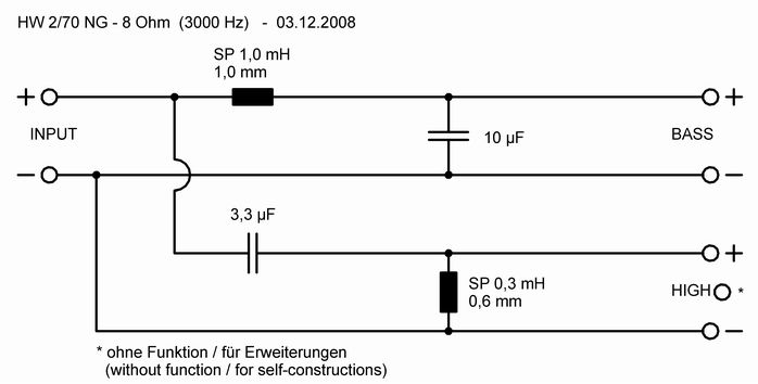

I don't think a 5" bass is going to be very loud anyway.
This Visaton 8 ohm stock crossover works well enough with a 4 ohm 5" paper bass, IMO. See, they've left room for an attenuator on the 8 ohm tweeter too. 🙂

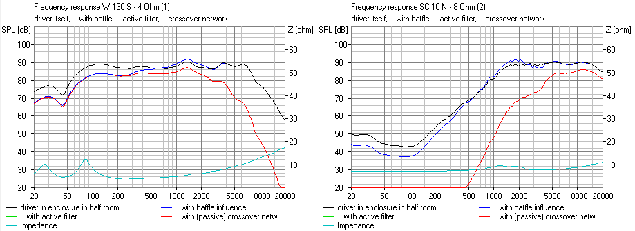

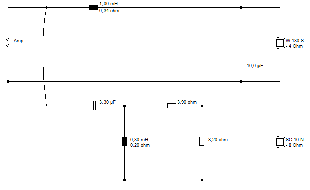

FWIW, I just modelled two similarly loud drivers in this configuration, and I needed around 3.9/8.2R attenuator.

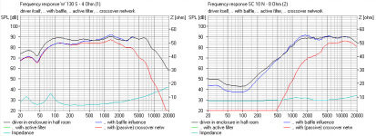

Since we're enjoying ourselves here, here's some very rough modelling with similar drivers. All works well, IMO. Should be a nice speaker.
You always have to fiddle about with tweeter level, and I don't think you'll get that Visaton midrange bump.

BSC (a sort of bass boost) comes with the filter. For 5" 4 ohms, 1mH and 10uF is about right. For an 8 ohm driver you might be nearer 1.8mH coil and a 6.8uF capacitor.

I can't think of many drivers this stock one would work with:
But 4 ohm 5" bass and 8 ohm tweeter, happily, is one of them. 🙂

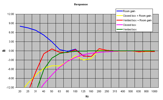

Visaton Boxsim shows many interesting aspects, like how a small box away from the wall might reduce bass. Or putting it near a wall increases apparent bass.
Then you get the boom from the room called room gain. A small speaker shouldn't be too affected by this.

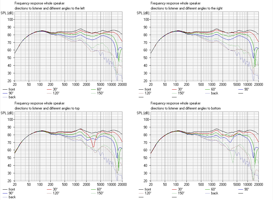

I always find dispersion interesting. Here's the typical plot. Above and below axis you get a hole in the mids with even order filters. Looks quite good at 30 degrees to the side. So forward facing at ear height, perhaps on stands away from the wall, I'd say. 😎
