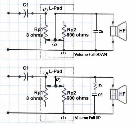

you know the sort of thing above. As an 8ohm L-pad it is only ~
correct and there is an ideal total resistance for each attenuation.
I'm curious at to what total value is used in these pads, the ideal
value varies with the attenuation you want, e.g. if 6dB then the
total would be 12R, 4Rpad + 8R_Driver||8Rpad = 8R.
But this gives 5R at no attenuation, 8R_Driver||12Rpad.
I'm guessing around 20/25R is used, any measurements ?.
🙂/sreten.

Attached is a diagram that shows the internal workings of an L-Pad.
Note that each leg is 'open' in that only one end and the potentiometer wiper is in the circuit. The other end of the resistance leg is not connected. That's why you have 3 connection points instead of 5.

The Variable L-Pad should work just like a normal Fixed L-Pad. You have a series component which is some percentage of 8 ohms, and you have the parallel (parallel to the speaker) component. When the parallel component is combined with the parallel speaker impedance, and the series resistance is added in, the result should always (more or less) be 8 ohms.
Consequently, these would reasonable represent potential resistor values -
-0.25db= 0.25 series, 274 parallel = 3.1% reduction in voltage signal
-0.5db = 0.45 series, 135 parallel = 6.3%
-1.0db = 0.86 series, 65.6 parallel = 10%
-2.0db = 1.65 series, 30.9 parallel = 20%
-2.5db= 2.00 series, 24.0 parallel = 25%
-3.0db = 2.34 series, 19.4 parallel = 30%
-4.0db = 3.00 series, 13.7 parallel = 37.5%
-6.0db = 4.00 series, 8.04 parallel = 50%
-8.0db = 4.82 series, 5.29 parallel = 60%
-10db = 5.47 series, 3.70 parallel = 68%
-12db = 5.99 series, 2.68 parallel = 75%
-14db = 6.41 series, 1.99 parallel = 80%
I think you get the picture.
First, it doesn't seem to a linear taper on the potentiometers, or at least not in the calculated resistor values.
Next, I'm not sure how small a signal reduction you can hear. If -0.25db is unhearable, then the highest value of the large value potentiometer is probably, like I said, about 125 to 150 ohms.
If -0.25db is detectable, then perhaps the highest value is closer to 300ohms.
At any rate, I think the large-value section of the L-Pad has to be at least 10 times the value of the speaker impedance for it to have minimal affect on the circuit when it is fully in parallel with the speaker.
Perhaps, I've misunderstood the original question, but none the less, hopefully, there is some value to what I have added.
And for the record, I didn't actually make the calculations, I used in on-line L-Pad calculator.
http://www.sengpielaudio.com/calculator-Lpad.htm
Steve/bluewizard

I have a Visaton L-pad with pins as per a normal pot. Looking from the font, left pin 1 (ground), centre pin 2 (wiper), right pin 3 (input).
It has 2 linear resistors with 8R attached to pin 3 (input), 35R attached to pin 1 (ground), pin 2 (wiper) contacting the resistors at the same angle.
Some measured values between pins,
LEVEL: 3-2 (input to wiper), 3-1 (input to ground), 2-1 (wiper to ground), (Z out)
MIN : 7R8, 8R0, 0R1 (wiper shunts to ground)
MIN+ : 6R8, 7R7, 1R0, (0R87)
¼ : 4R7, 15R2, 10R7, (3R26)
MID : 3R6, 22R, 19R5, (3R04)
¾ : 1R9, 27R9, 26R1, (1R77)
MAX-: 1R0, 31R6, 30R7, (0R97)
MAX : 0R1, 35R, 35R (input open to wiper)
So the output impedance varies (if I've calculated correctly) and could never be 8R on this L-pad.
BTW, I was always told a normal 2 resistor L-pad does not to alter the impedance of the filter..... true or false.
Hope this info helps.

Hi Rabbitz,
8R and 35R sound reasonable values for two linear tracks.
The output impedance will vary, Zout is not the issue.
(I assume you correctly measured Zout with 3+1 connected.)
What is supposed to stay constant is the input
impedance with 8R connected to the output.
Starting the input track at 1.5R works but prevents zero attenuation.
(rabbitz example seems to start at 1R, giving 7.5R in)
Otherwise with above values input = 6.5R at zero attenuation.
Full attenuation = 8R.
midpoint = ~ 4 R series with ~ 17R||8R = ~ 9.4R.
🙂/sreten.

Just to dig up this thread - I had a close look at a stereo (2 gang) L-Pad today.
One element (of each gang) is 8R, the other is about 50R. Both linear.
With an 8R load, the total resistance varies from about 7.5R to 11.5R. The 11.5 is found near the mid point of the wiper travel. For the most part it stays near 8-9R.
The 2 elements don't match very well, tho...
FWIW, it has a total inductance of about 0.08mH. That's a LP of 16Khz at 8R. Don't know if it really rolls off on top - I may measure it.

Thanks for that. It seems the 8R track is standard and the other track
somewhat variable, depending on what error you want to minimise.
So if you are designing to use L-pads for mid and treble say at
nominally - 6dB +/- a couple of dB around this point you really
should measure the L-pads and not assume 8R.

Yeah, I would say so.
Over most of the range it's no big deal, but in that 11.5R range, you're gonna shift that x-over point, for sure.
Another problem with the cheap ones is that the wiper contact isn't very good. (There are 2 wipers) Scratchy, noisy and easy to get strange values if you "park it" in the wrong spot.
The bigger 100W L-Pads I've used were much better in that regard.
