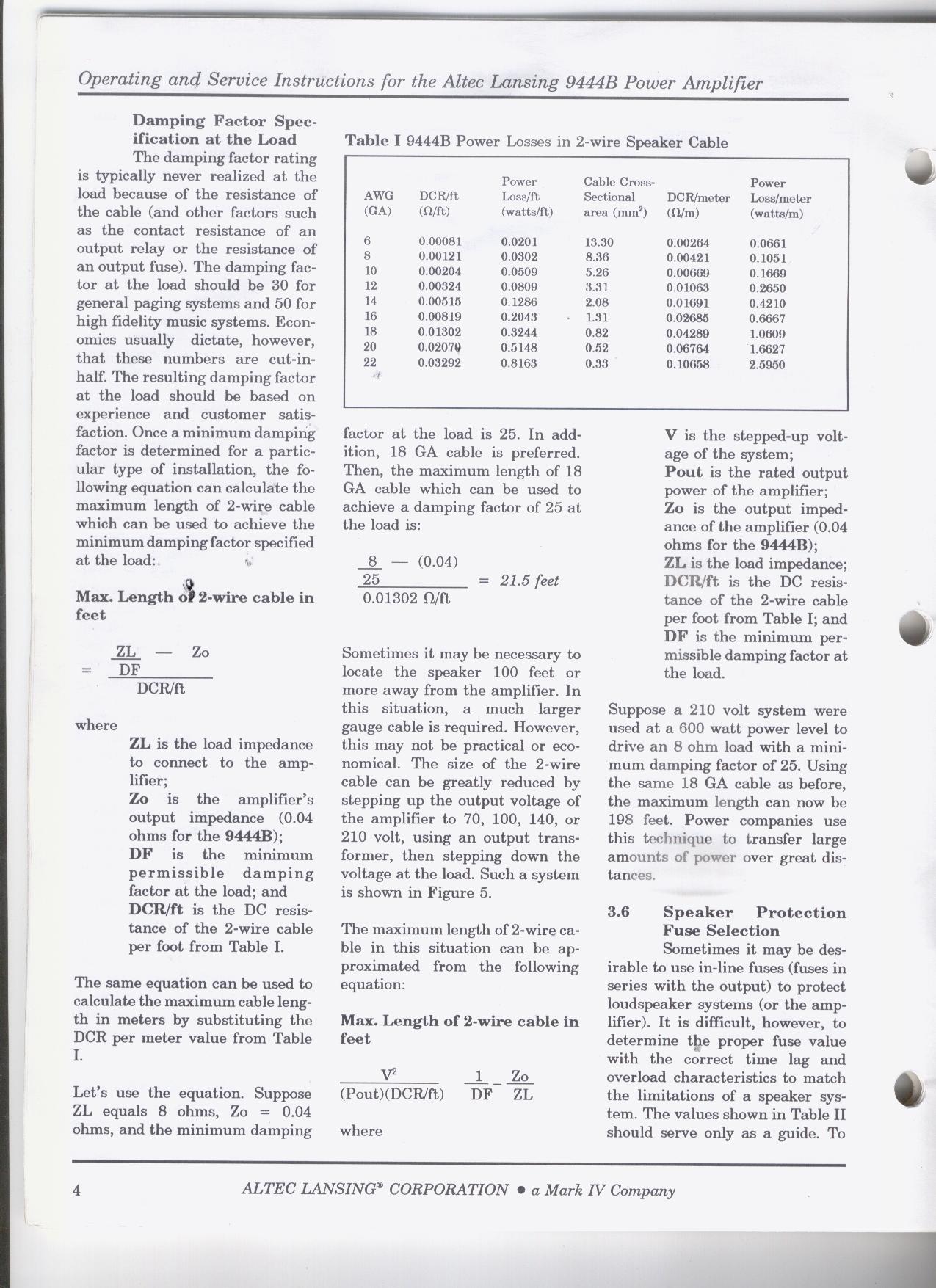

I myself would go for the highest impedance available. A 250' pair of 14 gauge wire has a resistance of about 1.3 ohm and you loose a lot of power in the wire (16% with 8 ohm speakers at 250'))
