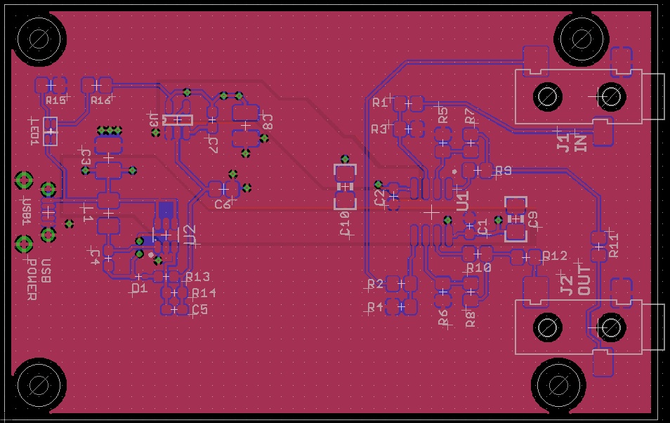

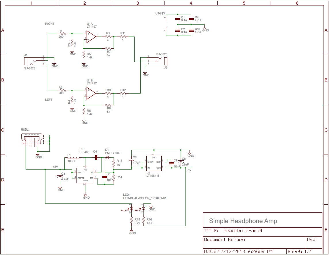

I've done something similar. I built a small board (1.8"x2.8") that is USB powered that derives the +5V to generate a split supply, +/-5V. The reason for this is to avoid using coupling caps when a single rail is used. I have audio technica M35 headphones which are 65 ohms. I wanted to have a gain of 5 to boost the level from my iphone, and both intended to be powered from a computer's USB ports. Sometimes I like to crank it at work. The max output is ~2.5V rms which is close to the max allowed for the headphones, 100mW.

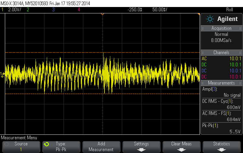

I tested the amp and looked at the supply rails while pushed to the max. The inverting switcher does have occasional problems under severe rock passages with heavy bass. More decoupling is needed. Also plan to use a mini USB connector instead of micro B. Also looking into seeing if the 3483 can be operated in continuous mode (runs burst mode now). While music was running, I put a scope on the output. When I saw the drops outs of the -5V rail, I was somewhat surprised how little effect it had on the sound. The rail was dropping hundreds of mV. But as you can see from the scope shot, the peaks were hitting about 3V which was very loud. Let me add, this little amp sounds very clean.
