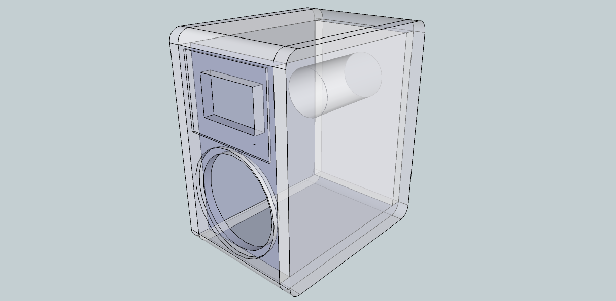

So I came up with an idea to build a small speaker using cheap pro drivers (higher efficiency) to drive them with some cheap tube amp.
Drivers used should be Beyma SM108, B&C DE10 (ME10 or XT120)
attached are sketch ups.
My Qs are:
-any good CNC wood cutting near Amsterdam? (considering I dont have to provide wood, just drawings)
-any good source for the drivers in Netherland?
also would like to hear your suggestions 🙂 (critics welcome)

The SM108 is almost textbook for a B4 alignment: 11.3L net, f3=69Hz. You can work out the port.
ME10 works well with the DE25 for about a 2k xover, but unsure of the DE10. I also like the XT120.
You are still going to need to design a xver for it.
Re wood: do as I do and go to a kitchen maker with a large accurate table saw and get them to cut it. Usually doesn't cost much.

brett thanks.Perhaps I can consider another 8" driver, because I have something like 25-27L net volume (driver, port, bracing already deducted).
Any suggestions? I'd like to get the driver down to cca 60Hz, at least, with some EQ, so the driver has to have a bigger xmax .
I've been considering a B&C 8NDL51,a little bit expensive for what i want, but good xmax.

I've modeled it in WinISD with linkwitz transform circuit, and taken down to 50Hz in 23L closed box, it showed that i wont reach the Xmax. but perhaps i'm doing something wrong 🙁 also the sensitivity was around 94dB ...
can somebody model this driver in a different program if he get the same? i'm little bit confused. anyway, i will be ordering the drivers after new year holiday.

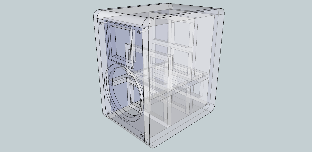

Hi all,
a small update. Wood should be cut this month, horns are ordered. only think that changes is the color, nothing important ( light maple sides, white vinyl mid section).
First important change is the 8" midbass. I'm thinking of a B&C NDL51.
....................... (input your comment here 🙂 )
But more important is the change of layout. These speaker stay as they are. the only thing is, a subwoofer (supporting bass cabinet) will be added as money will allow.
So it will be a modular speaker (sub crossed somewhere around 80Hz).
I spoke to Tony Gee, I had an idea of placing two identical woofers in one cabinet, the other one on the back side, same axis, connected opposite faze, to get higher efficiency and to cancel out vibrations. He told me that is a bad idea, that to control the faze shift would be impossible.
Any thoughts on this?
Danny

A quick sim shows 130Hz f3 sealed, so either a pair EQ'd or ported would be needed to get 80Hz.
They will behave like a spaced bipole like this. Whether you consider this a plus or not for your design I dunno.I spoke to Tony Gee, I had an idea of placing two identical woofers in one cabinet, the other one on the back side, same axis, connected opposite faze, to get higher efficiency and to cancel out vibrations. He told me that is a bad idea, that to control the faze shift would be impossible.
