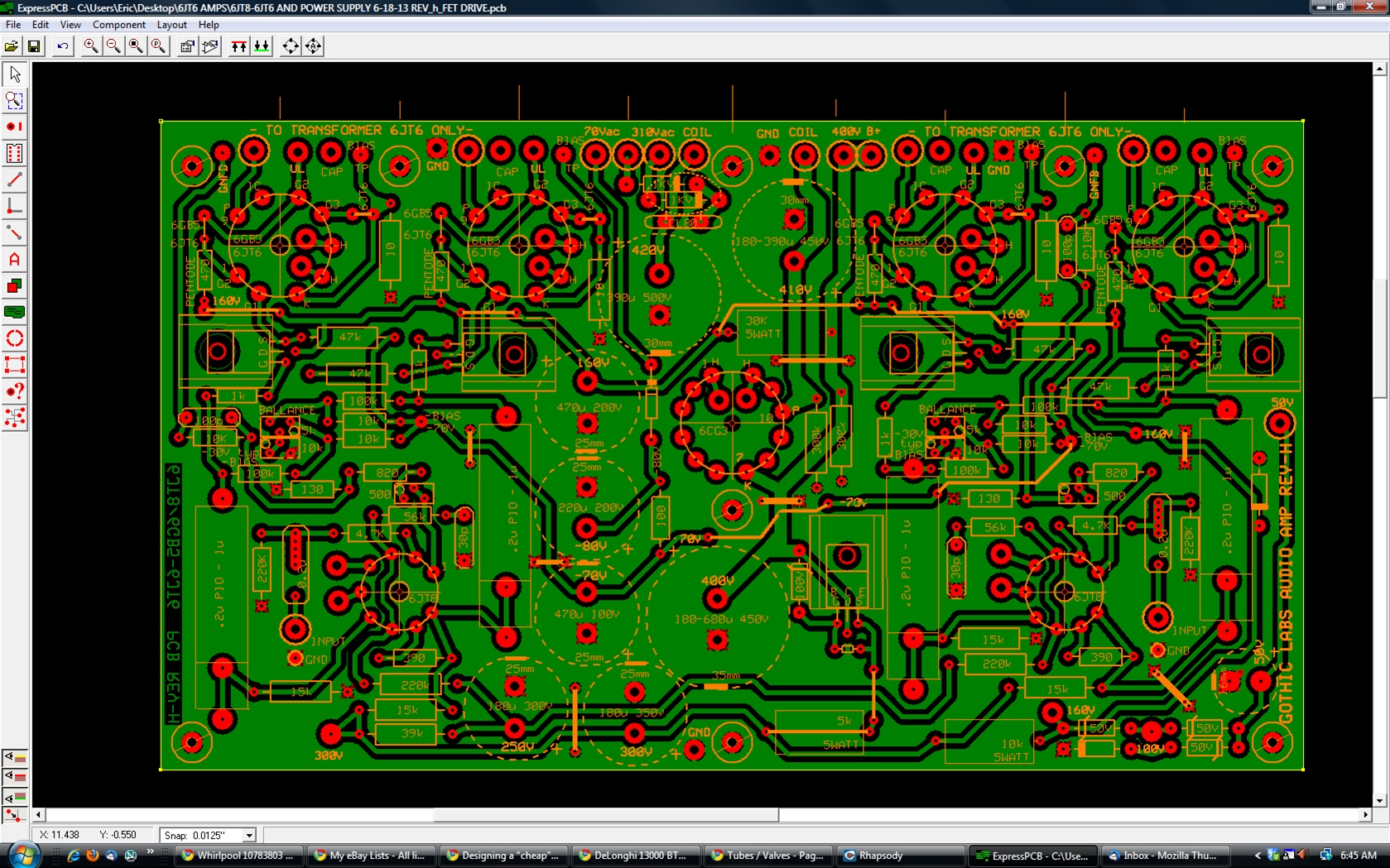

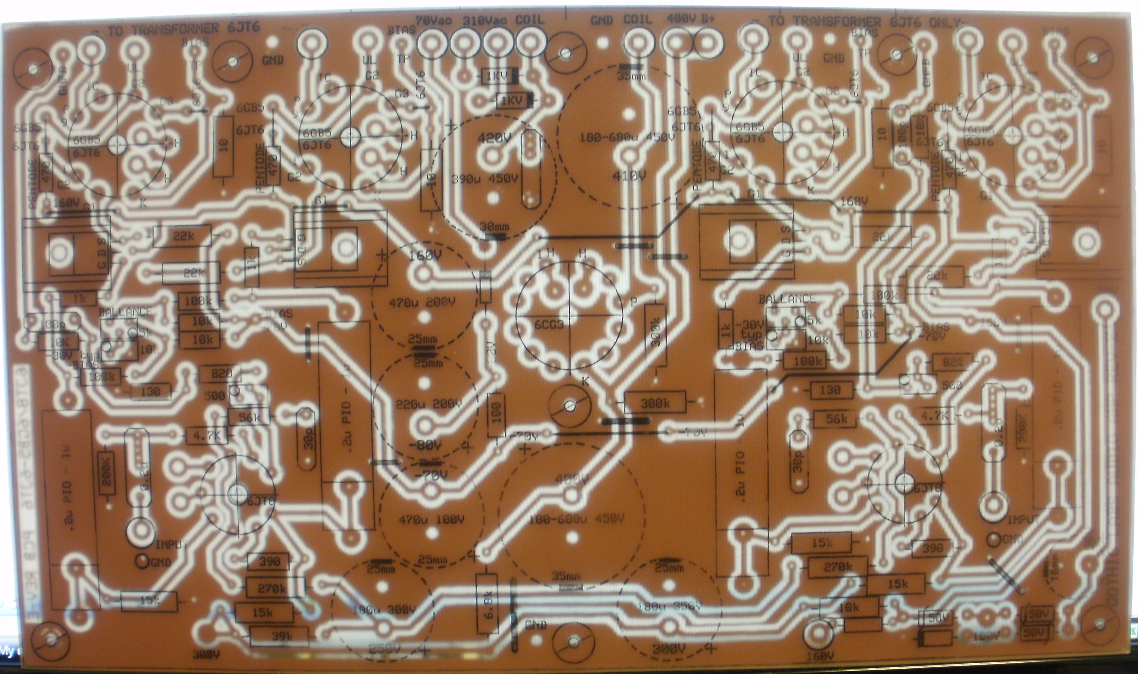

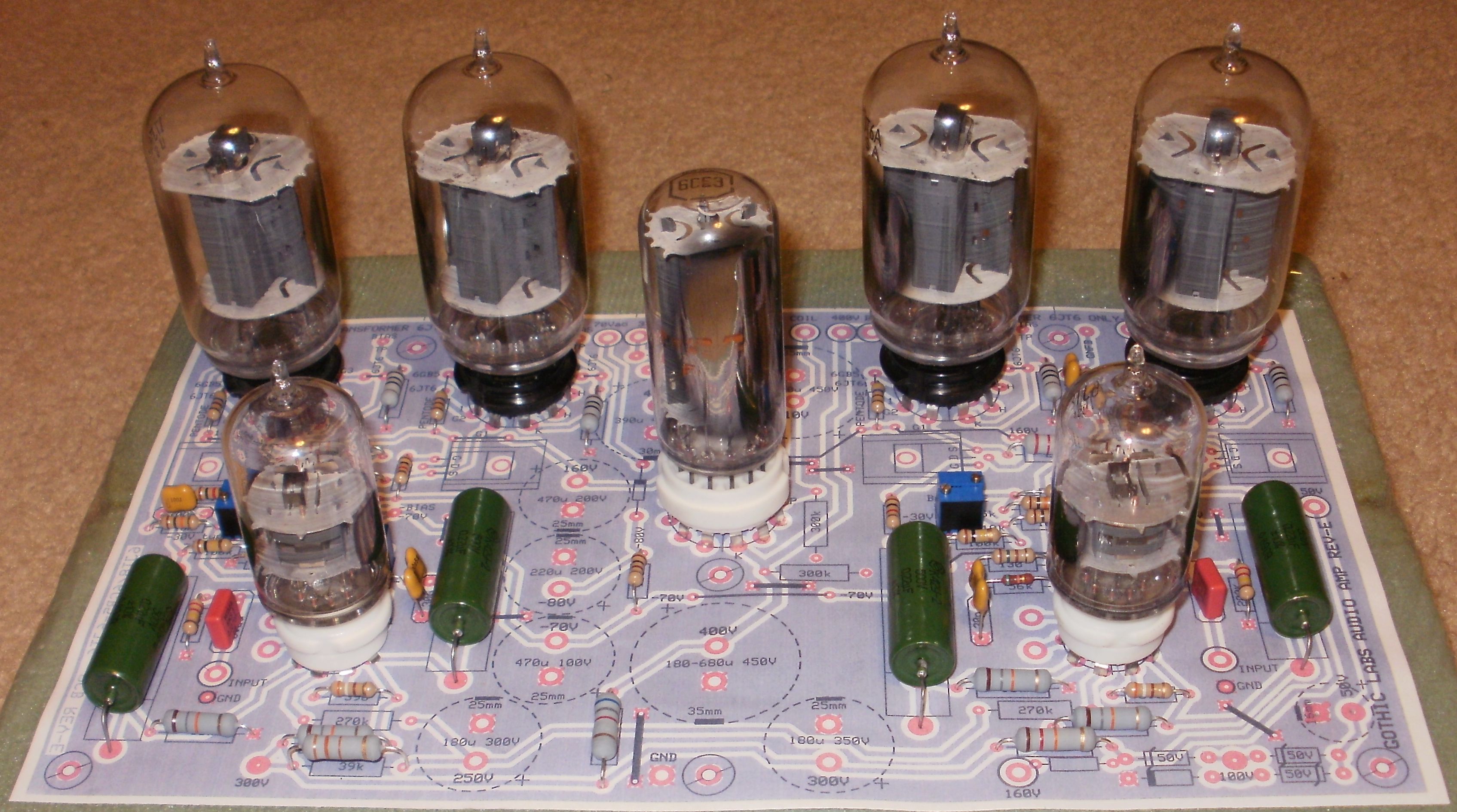

My latest amp in process targeted for 40 walls/channel... using low cost sweep output tubes

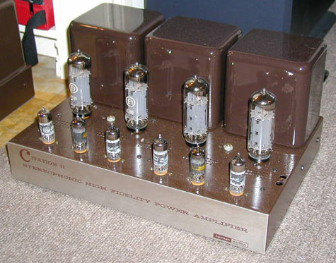

Uh - huh! I've uploaded a photo of a H/K Cit. 2, which is a stereoblock good for about 65 WPC continuous and better than twice as much instantaneous. The brute weighs about 75 pounds (34 Kilos). The bandwidth of the O/P transformers is out of sight, at both frequency extremes. 😀
BTW, the Cit. 2, AKA "Deuce", blows the triode myth away. There's not a single triode in the circuitry.

The fabulous O/P "iron" in the "Deuce" was wound by Freed of Brooklyn, NY.
Somebody whose taste leans towards the euphony of 2nd order HD will not like the sound of a Cit. 2. The "Duece" is honest, in the extreme. Artifact free reproduction is what you get.
