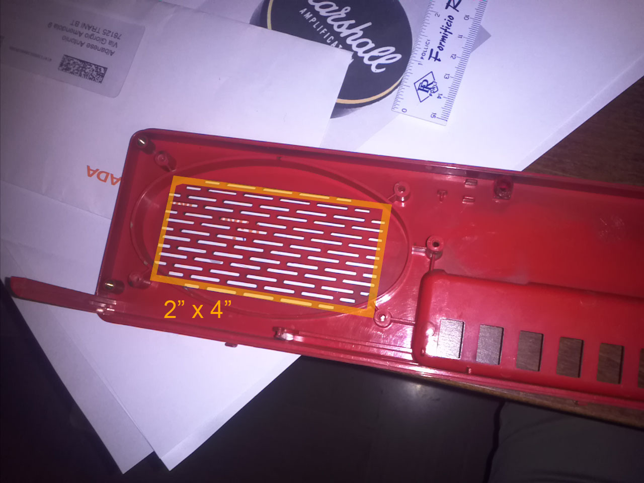

My first project is turning this old 70's cable radio speaker into a good quality speaker for portable mp3s, ipod and so on, with both jack and bluetooth connectivity. I was thinking for a T-amp as amplifier, like Dayton Audio DTA-2 or something TA2024 based.
My question about driver:I want to replace the 3"x5" with a really good full range speaker...but with which? I don't find other 3"x5"..maybe it is better to use a normal 3" like HiVi B3N or Tang Band W3-881SJF?
What are dimensions of speaker box? Is it sealed or ported? Is it stereo or mono? Since you are suggesting 3 in driver I would go with a 3.5 in if room allows. Use a Vifa TC9FD driver great sound and great value. You might want to check out rectangular or square shaped flat drivers (Balanced Mode Radiators). You might have room for two and do stereo. I would go with a TPA3122 amp rather than TA202x. TI's sound better in my opinion.

Thank you very much Pano, xrk971. The box is 4.75" x 3.5" x 4.5", sealed (but I could open a port if you seggest me where 🙂).
You see in attachment the front back. The "drilled" area is 2"x4", maximum allowance is 3"x5". Maybe 3.5" is too much...what can I look at? Good idea having a stereo" maybe 2 pieces of maximum 2.5". What do you think?

The Dayton is a nice unit - terrific deep bass for how small it is at expense in efficiency and high freq performance, The Vifa TC7FD is nice too for this application, If you want clear vocals and brilliant highs go with Vifa, deep bass go with Dayton ND65. You can get PE in Italy with reasonable shipping?
