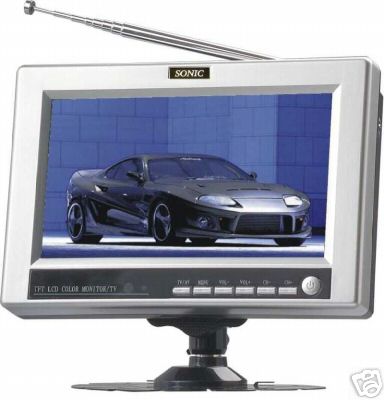

Less than 2 weeks before the big day i've decided to build a projector using this 7" sonic lcd Tv with a built in tuner here are some pics of the project up to date.http://www.hostclip.com/dl/42c532d1cf8d3e5f90fb4c35fb39ea86

after doing a few tests with the pojector built i have a poblem with the picture being displayed out it's not showing the full sceen only the centre of the screen is this from the lense as thats why it was used with the small LCDs.
Frens the lcd is in place when i turn everything on including the lcd the image that is being projected is the centre only of the LCD not the entire Lcd only a small portion of the centre about 2inches square right in the light path .The lense is from an epson 700c do i need to change something in the lense in order to get the full size of the LCD.
