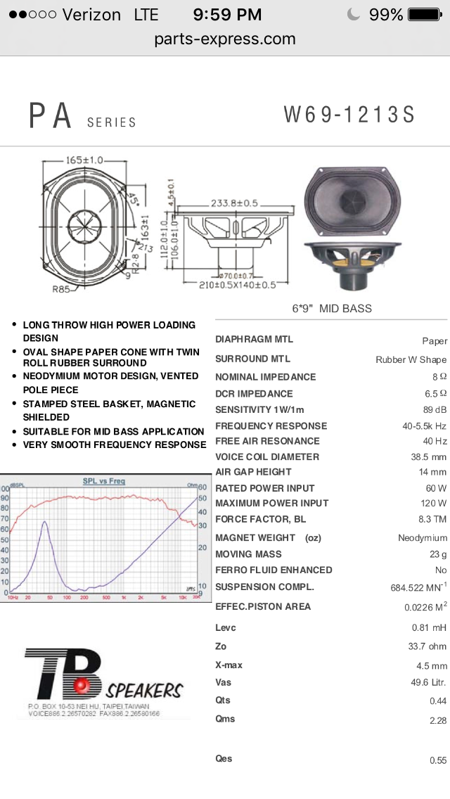

Found one more , closer to requirement.
http://www.parts-express.com/pedocs/specs/264-836-tang-band-specifications-45160.pdf
Unfortunately Parts Express lists that driver as "no longer available"
Tang Band W69-1213SB 6"x9" Neodymium Woofer
yes I saw it later so went to tb and took a look. There are three 6x9 , two have paper cones.
they are pricey though.
The truncated frame is great for a head.
W69-1213SB - 6x9" Paper Woofer - TB SPEAKER CO., LTD.

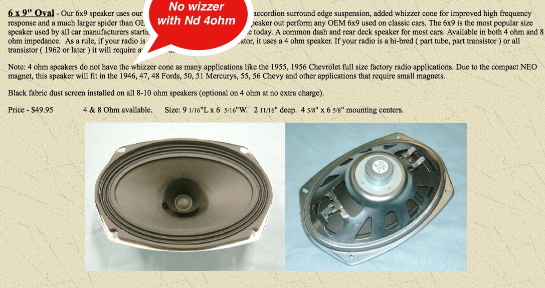

I used a pair of the factory 4" x 6" speakers from my 97 ford F150 to make a small practice amp and they sound great - the 'head' is the amp from a pair of computer speakers and a zoom g1xon for effects.
Yep I suspect they sound 'better' no standing wave from round.
I just noticed this is available in Nd 4 ohm no wizzer !
Perfect for tpa311x but have to power limit.
The hybrid stealth speaker head is saved.

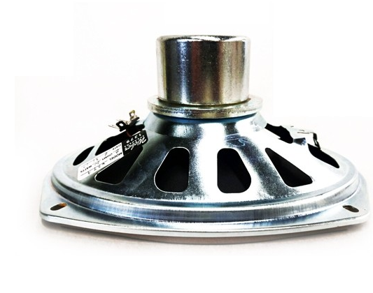

The old Ted Weber Co has made them available again. Nice to see these back.
4,8,or 16 ohm 20W. Its just basic physics, a round speaker has weird artifacts such as cone imbalance harmonics. IMO non-round is better.
6x9" - Vintage Series - Speakers

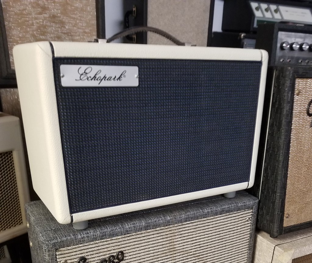

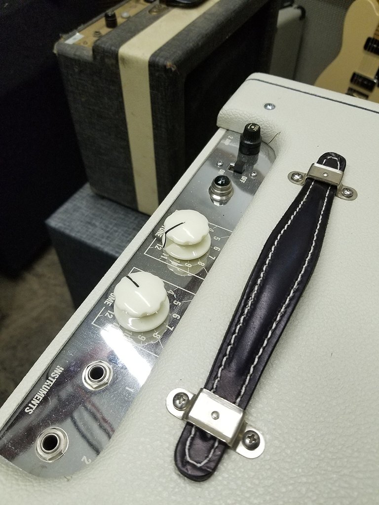

Here is the a product that uses the new Weber. I have no connection with this company.
White - Producer Model – echoparkinstruments
