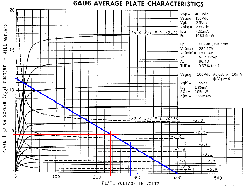

Pentodes in pentode mode are quite forgiving with low Ia... they sound good with lower noise. Of course there are exceptions... EF184, EF86, etc. sound quite nice burning at 9mA 🙂
How do you even deal with something like that? The plate characteristics for the 6AU6 don't go that low. This loadline certainly doesn't look too bad, and it has the current reserve to slap around whatever grids you connect as the next stage, so no slew rate problems either.
Miles, it's okay if you misunderstand the design 😉 The driver limitations are not a problem with a pentode output stage. And if you need to drive something more serious, you can easily bump up the idle current, reduce the plate load, and tweak the feedback. I bet the 50W version of this amp (linked above by wrenchone) would give a Citation II a run for its money.

From the 6V6 Spec sheet:
Crt= 0.7pF
Cgk= 9.0pF
Cpk= 7.5pF
From the text, the voltage gain of the 6V6s is 15:
Cmiller= Crt(1 + Av)= 0.7(1 + 15)= 11.2pF
Figuring a Cstray= 10pF (bare minimum if your lay-out is outstanding), then:
Ci= Cstray + Cgk + Cmiller= 10 + 9.0 + 11.2= 30.2pF
At 30KHz:
Xc= (2pi X 30E3 X 30.2E-12)^-1= -j175.7K
That's paralleled with a 330K DC grid return, so figuring the equivalent impedance:
G= 1 / 330E3= 3.03E-6
Bc= 1 / -j175.7E3= j5.69E-6
Y= 3.03E-6 + j5.69E-6
Z= 1/Y= 72.9E3 - j136.9E3
| Z |= 155.1K
Given the stated output, load resistance, and voltage gain, you need to swing the 6V6 grids 23.6Vp.
This gives:
Ip= 23.6 / 155.1E3= 0.152mAp
By the "Rule of Five", you need at least 0.76mA of plate current in the driver, and you have less than half of that. You will actually need quite a bit more, since you can not be sure how much stray capacitance you might actually have. This takes into account just the current you need to drive the input capacitance to avoid slewing. It does not account for clip behaviour when a transient comes along and attempts to take the control grids positive. That'll really make those 6AU6s roll over and die.
You've got a slew rate problem all right. Throw in poor clipping behaviour, grossly excessive NFB to make that clip behaviour even worse, and it's no wonder you have folks complaining in here that they bought a hollow state amp that sounded no better than a solid state amp. That thing is sure to have that great transistor sound.
The simplistic explanation you see all the time, that Class A*1 finals just need voltage, not current, is just plain wrong. It doesn't take into consideration the fact that capacitance needs current to charge, and that the grids aren't going to see the true signal level until that input capacitance charges. Not enough charging current, and you'll get slewing at the high end: loss of detail, and your highs just won't sound right.
You still are missing both the context and the potential of the design, but hey, feel free to deprive yourself of clever circuits. This scales up wonderfully, and since this is DIY we are under no obligation to idle our 6AU6s at .4mA. Your analysis shows that it can make it to 20kHz, albeit while satisfying a more relaxed "Rule of Three", which I'll admit is a bit chintzy by today's standards. But 20kHz was likely the benchmark used by the designers in the very early 1950s, before there were many commercial Williamson amps to compete with for numbers and bandwidth. Change a few resistors and the above problems are solved. Add a balance pot, as with the 50W version, and there is even less to complain about.
