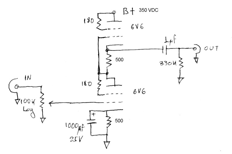

Did anybody build or listen to a 6V6 triode connected line preamp? I think it may be interesting to build one since I have some NOS. Maybe SRPP.

salas said:Did anybody build or listen to a 6V6 triode connected line preamp? I think it may be interesting to build one since I have some NOS. Maybe SRPP.
BudP have one in his preamp.....as CF , dunno is it triode 😉
Feasible then...
- The info that 6V6 is already used in line circuits with good results is positive. Thanks!
- Here is a basic circuit I came to graphically. Does anybody have a 6V6 model in some sim soft package? I sadly don't have it in my sims.
- If yes, lets see if the operating point and B+ are nice or there is better.
Re: Feasible then...
these simple tube circuit deserves that you learn graph-ruler-calculator routine.
you don't need sim for that ; or you'll never learn how tube works
I did already. But it would be nice to double check.
Cheers.
Cheers.
Re: Re: Feasible then...
ok-then you did already what sims can do just worse ;
double check with dvm and cro and whatever you have
Cheers.
6V6 models
Try these models. They work on LTSpice.

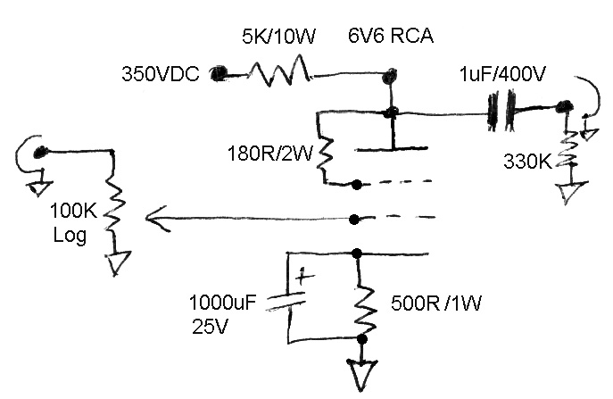

Thanks Bud!
BudP answered my email very kindly.
He confirmed use of 6V6 as a current sourced CF (driving an SE to balanced output conversion transformer) after a 6G6 CC stage. He said it sounds much better than with smaller tubes. He uses 16V cathode op. point.
I chose 15V (I hope it proves there about in real test). So all lights are green.

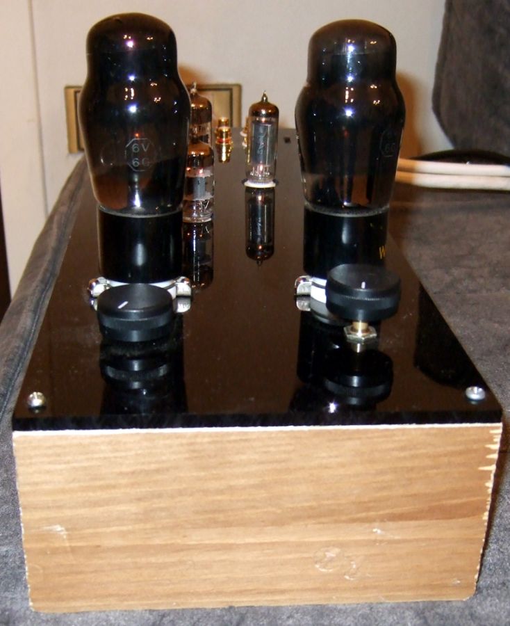

Initial test done!
Hello again! Rough test gave very good results. The regulated supply did not hold up to more than 260 VDC B+ so I used a 17mA ,11.2V cathode operating point. Wire wound sandcast plate 5W resistors, 680R 1W generic carbon rk and generic Matsushita ck. Basic white Mundorf (SCR) coupler. The common cathode circuit was tested.
Well...bigger 3D, no edge, more reverb and depth info, more musical detail than the 6SN7 cc&cf or SRPP, or grid leak cc&cf, or 12AU7 cc&cf that have been used previously in the system.
Piano sounds superb and big drums too. Lots of air and body but no flatness or edge nowhere. Voices more liquid and human, better defined with better front to back spatial resolution. Strings are velvety, basses huge and open with no pace loss. Very good drive, optimal gain. Treble stems out seamlessly from upper mid naturally, not like a distinct entity.
Microphonicity is confined to a glassy low level 'ding' sound when hitting the 6V6 glass with a fingernail or when turning the stepped attenuator located right next to it. No locking with the feedback from the speaker just 0.5m near. After half an hour some periodic 'hsst' sounding transients showed up accompanied with woofers travelling on right channel but I am suspicious of the small regulated supply 12B4 pass element getting taxed with heat. Maybe it was the right 6V6 heater aswell, but I doubt it bcs of the cone travel, looks like a DC shift. I will test with heavier supply in due time. Now its given away to be further auditioned and inspected in longer term in another system by a fellow DIYer. If it turns to behave well in the long run it will very probably get adopted as my premium pre with proper custom PSU, best parts and antimicrophonic box build (there is more performance to be expected given the compromised B+ and generic components first test). Will keep you posted.
