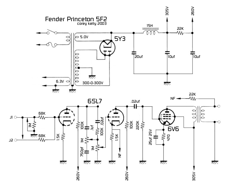

Here is my version of the Fender Princeton guitar amp. Basically changed the power supply and replace the exsisting tone stack with a gibson style. I remeber reading a post by someone who recommanded these changes. Thanks whoever you are. It is a great little guitar amp, I highly recommand it. I am currently using a old Fender 10" alinco speaker but also have a Vintage 30 Celetion that I would not mind trying.
Anyone have any recommanded changes?

A 10k-100K resistor in series with the output-tube grid drive will mellow things a bit when you overdrive th amp. Works for me very well in a EL84 amp.

I always thought the fender-style tonestack was superior to gibson's, but i guess guitar is a lot about personal preference.
a lot of the little SE fender amps melt the **** out of their 6V6's (ie. ~350 volts), so keeping a 6V6 within ratings (305v) may change the sound some... but it is more friendly to the tube.
