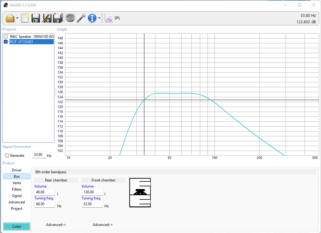

I just tried a couple sims in WinISD with that driver, 6th order with 25hz and 95hz chamber tunings produces a nice bandpass response but the -3dB point is 47hz and it hits xmax right at 800w producing about 124dB. A reflex alignment with the same driver will take 1000w before hitting xmax and gets 3dB louder so probably safe to say a bandpass isn't ideal for this driver.

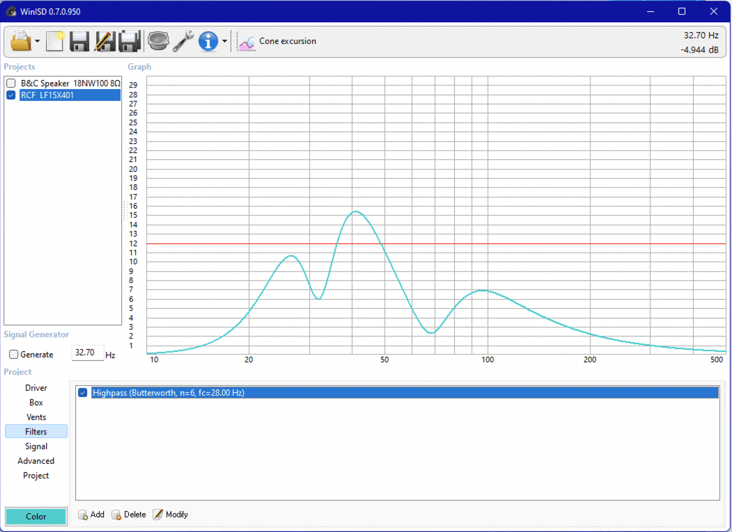

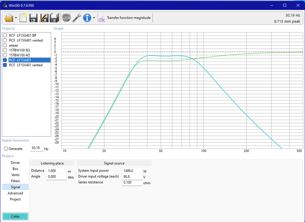

I've tried it with RCF LF15X401 now. This looks good right? Excursion is well over xmax on 1500W but well below xlim. What do you think?

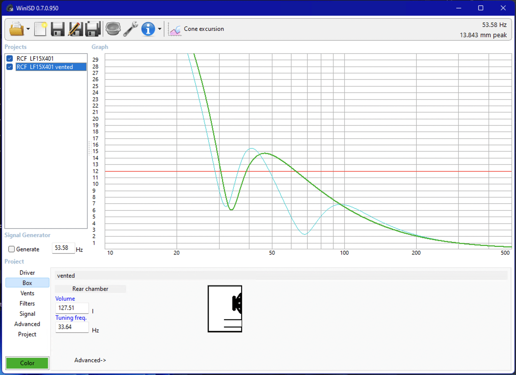

Yeah that looks good, how far over xmax is it and how does that compare to the excusrion of the reflex sim?
Pretty close actually.
Green is reflex, blue is 6th.
xlim (max before damage) is 50 mm, xmax is 12 mm

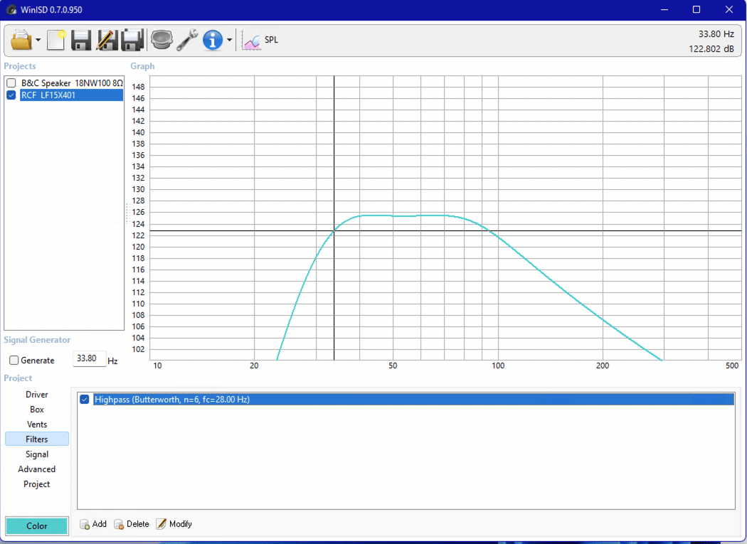

With vented boxes and PA power levels you really need to use (and model with) a high pass filter to cut excursion below tuning.
That might give your sims better results. (use the filters tab in winISD to add a highpass around 28Hz on the above sim)

Indeed! Better still is to tune it higher as the BP sim shows, so the pioneers went with a Vb = Vas/1.44, Fb = 1.56x Fs = ~104.16 L/56.16 Hz Fb/Av = Sd vent x 44.4 cm handles full 1600 W/Xmax/Fb, so if wanting a solid 40 Hz, then a ~ 26 Hz Fs is required.
Build it as a box within a box since the vent has to be so large.

As for the RCF, from the excursion plot it ideally needs a somewhat higher high-pass or at least a DSP'd notch to get it down to ~the red line.
