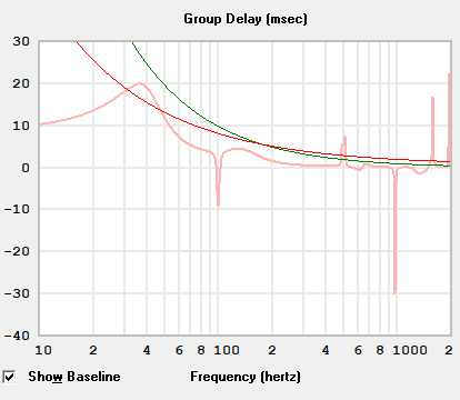

6th order group delay tolerances
Equing it, it correct group delay.
Double clic on time scale on hornresp let appear guiline curves.
Moreover in the example below, the ~3ms delay at 100hz can be substracted while analysing the group delay chart when crossed around this frequency.
And crossover, on it own, add it own group delay deviation. It need all to be considered.

Group delay that low in frequency isn’t much of an issue, it tends not to be very audible

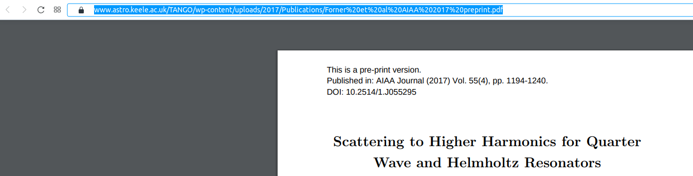

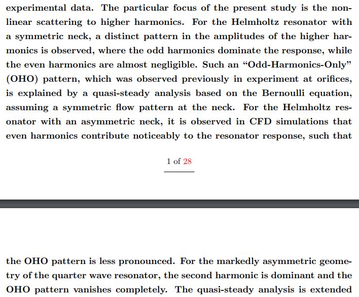

Some group delay below 35 Hz can add a "impressive" and "massive" quality to the bass in car audio setups. Quarter wave devices tend to sound better then Helmholtz with high GD, which I believe is due to the lower Q, greater bandwidth and dominant second harmonic distortion character of the quarter wave resonance compared to Helmholtz (which is typical third harmonic distortion dominant with lots of port compression and turbulence on top of that).
You believe a lot of thing, but what is your test protocol ? You seems to keep repeating the same stuffs. As already explained, the Q you talk about can be equed easily, linked to phase, and so to group delay (unless using FIR, but at those frequency, it's actually excluded generally).
Quarter wave have less bandwidth than bass reflex since they inherently acoustically low pass their output. Third harmonic dominant of bass reflex... ?? I don't recall this. Can you explain ?

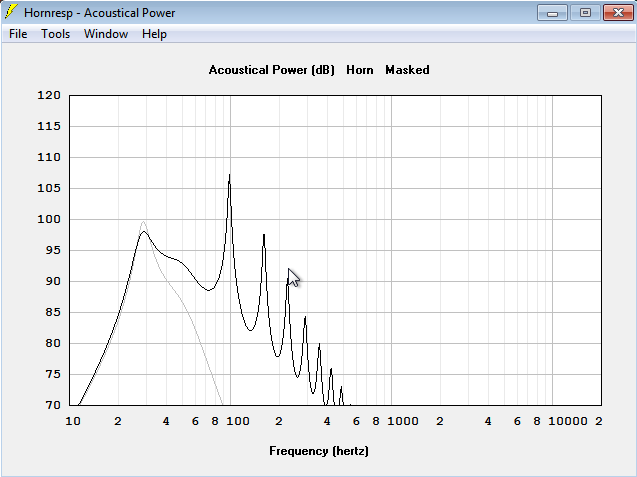

This is just a simulation, but I am confident enough in Hornresp to show the general behavior correctly of this comparison between Helmholtz and Quarter wave.
Both spl response curves are from a 4th order BP to isolate the port output. Both examples are with a 200 liter closed box enclosing the back side of the driver.
One is with a 100 liter box and a 120 cm2 port 30 long (Helmholtz) front section and the other curve is from a 500 cm2 quarter wave front section without the 100 liter chamber.
Can you guess which is which?
