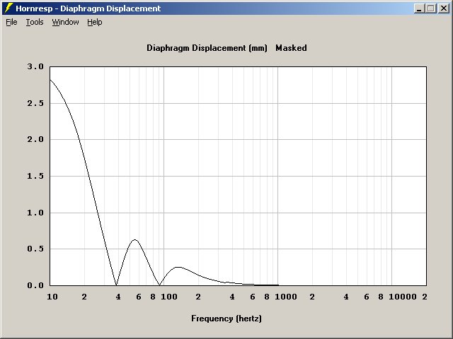

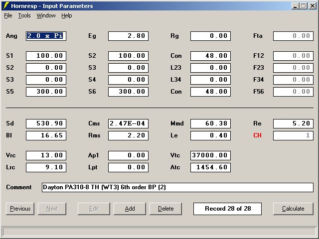

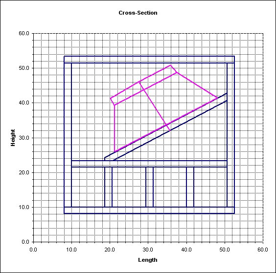

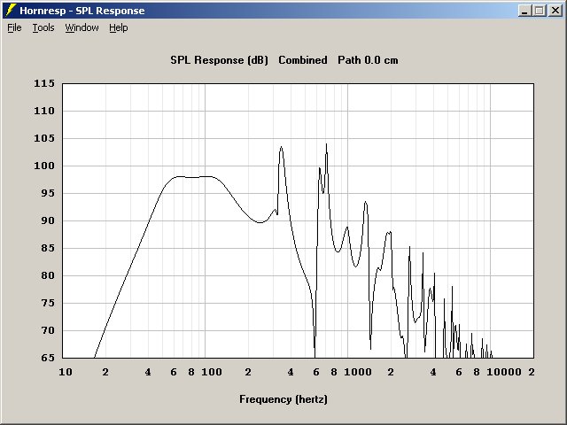

Thanks! I've been running through numerous possible TH alignments for a 12" driver I recently purchased, and it looks like I might get results more to my liking (size vs. performance) if I go with a "simple" 6th order BP alignment instead . I'm looking for some layout ideas to accomodate the alignment I've come up with - those links should come in handy.
Kind of a tight fit, but theoretically 0,-3dB from 50 Hz to 150 Hz, 98dB SPL, and a box under 4 cu.ft.... tempting! I might build both this and the larger TH to see which one sounds better...

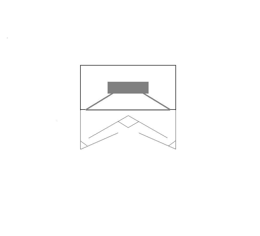

You can't play bass with just a bandpass sub.
Talking two boxen here and a crossover. N'less
yer higher tuned port hole, or slot is centrally
located and phased to double as the indirect
radiator for midbass.
ofcourse not 🙂

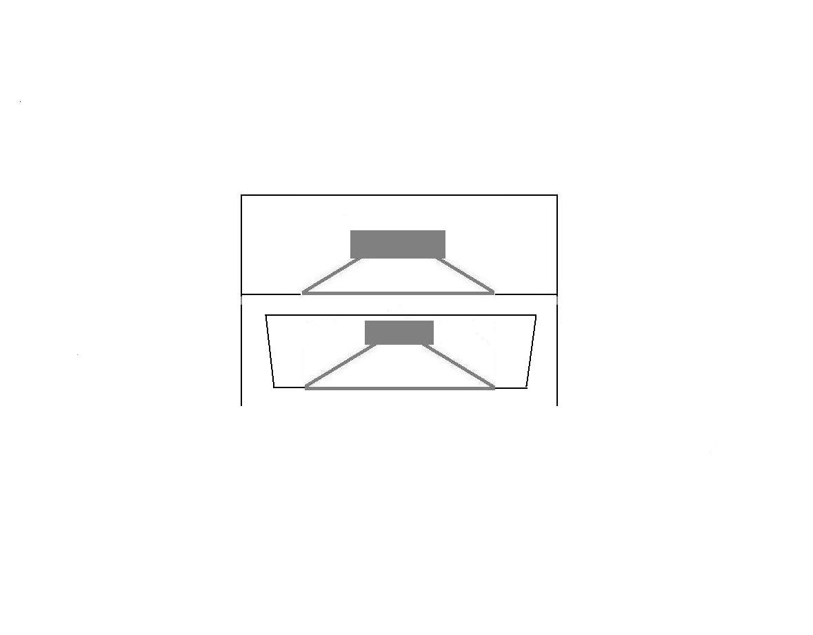

while you posted I drew another one, implementing the front driver
personally I think its a daft idea 😛
anyway, the idea was to use a smaller woofer, and still get SPL, and control
and front driver not playing low bass could be chosen for much better upper range, and thus have strong motor with very low Qts
Im not sure it needs much xo, if any at all ?

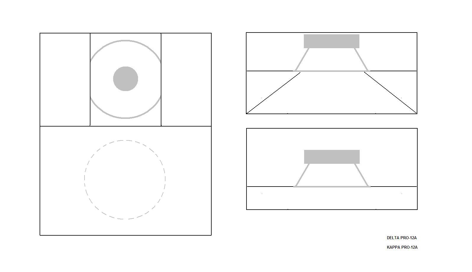

anyway, next devellopment
Eminence Delta pro-12A, and Kappa pro-12A
Delta in top "waveguide", and Kappa in bottom 6.order bandpass
Delta in small closed box rolls off around 105hz(-3db)
Kappa, around 40-100hz bandpass
It will do 115db with 120 watt
Could look like "over-ingeneering"
but woofers are "affordable"
Its just more work 😛
