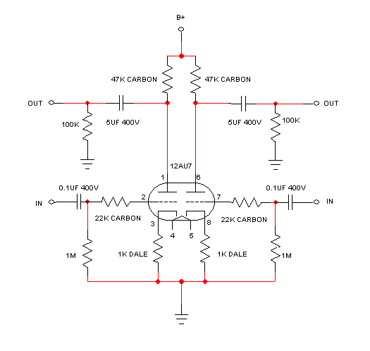

...plese for the tube experts out there,just have simply question,plese help me to become right data ,to put together a simpy anode folower for 6sn7gt tube,to become a plate current about 8-10mA,for best linearity and good sound.So plese tell me how much must be B+ voltage,how big anode resistor and how big cathode resistor for good operating point?
I will use one triode for bouth chanels,so half triode per chanel.
Plese for help!!!😕
6SN7GT operating points.....
...sorry just forget to mention.I will use this anode folower for output stage of my cd player,this will be directly fited with signal from dac that is about 1,5Vrms.I just have see this simply schematic from Decware audio,for 12au7 tube,but becouse I have some 6sn7gt tubes at home I would try this with this tube in the same configuration.

After rect. You will have about +230 v. If You will want 160-180 anode v and 8 ma current, You must use anode res. about 8-10 kohm, that is too small load for 6SN7. Good load is about 20 kohm and more. And Your current must be about 4 ma, that is not good. Better go to mode 120-130 v, with 20 kohm and 5-6 ma. Cathode res - less 470 ohms. Problem is that Your main transformer is not suitable, IMO.
This circuit is not an anode follower.
It is an ordinary common cathode circuit and it has gain about 20 dB or a bit more.
Because you have quite high input level (1.5 Vrms) you actually do not need gain.
Therefore simple cathode follower would may be best, or a real anode follower with gain of 0 dB.
Below is the cathode follower with 8 mA anode current. This kind of circuit is very linear. The distortion is below 0,1 % at 3 Vrms out.

You can use that 180 V toroid you already have.
The output level I mentioned, 3 Vrms is just and example and value I used for simulation.
You can connect this circuit directly to dac and get some 1,3...1,4 Vrms out.
This circuit has some - 0,6 dB gain (0,93 times the input signal).

Generally spoken I still have to hear a ECC82/12AU7 that I actually like.
6CG7, 6SN7 are much better.
The MF X10-D is just a buffer. It won't make a big difference no matter what valve you use.
A few years ago I have presented a simple line stage with one 6SN7 per channel that was well received. It has a little gain and a buffer as well so it should be closer to what you're looking for I believe.
