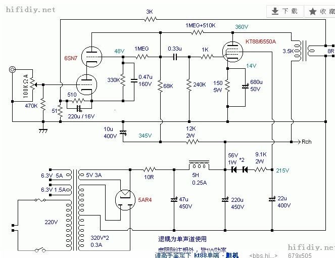

My first thread here, hopefully some members could direct me to the right place if this has already been discussed. I would take the following schematic and run the power tubes with KT88 and possibly a tube rectifier. I couldn't find any schematic available for 6SN7 paired with KT88. This was the closest thing I could find on one of my books. Any suggestions or possibly direct me to the right area of research and discussion for this newb. to read up on? Or anything t take note on? Thanks in advance.
Seems to be a classic design. Dual triode preamp and driver and ultralinear output single ended pentode. NFB from transformer.
The key item is the output transformer. Can you get it?
The schematic BOM requires 2 x 5k primary and 8 ohm secondary at 15w power rating. Should not be too difficult for me to locate, I believe Edcor or Hammond might have something similar?Seems to be a classic design. Dual triode preamp and driver and ultralinear output single ended pentode. NFB from transformer.

The difference you are going to find is a KT88 is gonna need more voltage swing from the driver than a 6L6 does. That first design shows the output tube with -28V on the cathode (and fixed bias on a SE amp...), you are gonna end up with -40 to -42V with a KT88 and I'm not sure that cascaded 6SN7 will do it.
You might instead try the cascode 6SN7 front end I used with my 300B amp (which is what that second one you posted is doing), and replace the 300B in my amp with a KT88 and use some plate to plate feedback like they did in that second one, but try a bit more like around 300K. And I would then skip the GNFB. Looks like the seconds one is wired in pentode instead of UL, with UL use something like a 1.2K screen stopper and with UL you can probably get away with just using "Schade" feedback like that blueglow/Kegger amp did. I like simple/fewer parts in my builds.

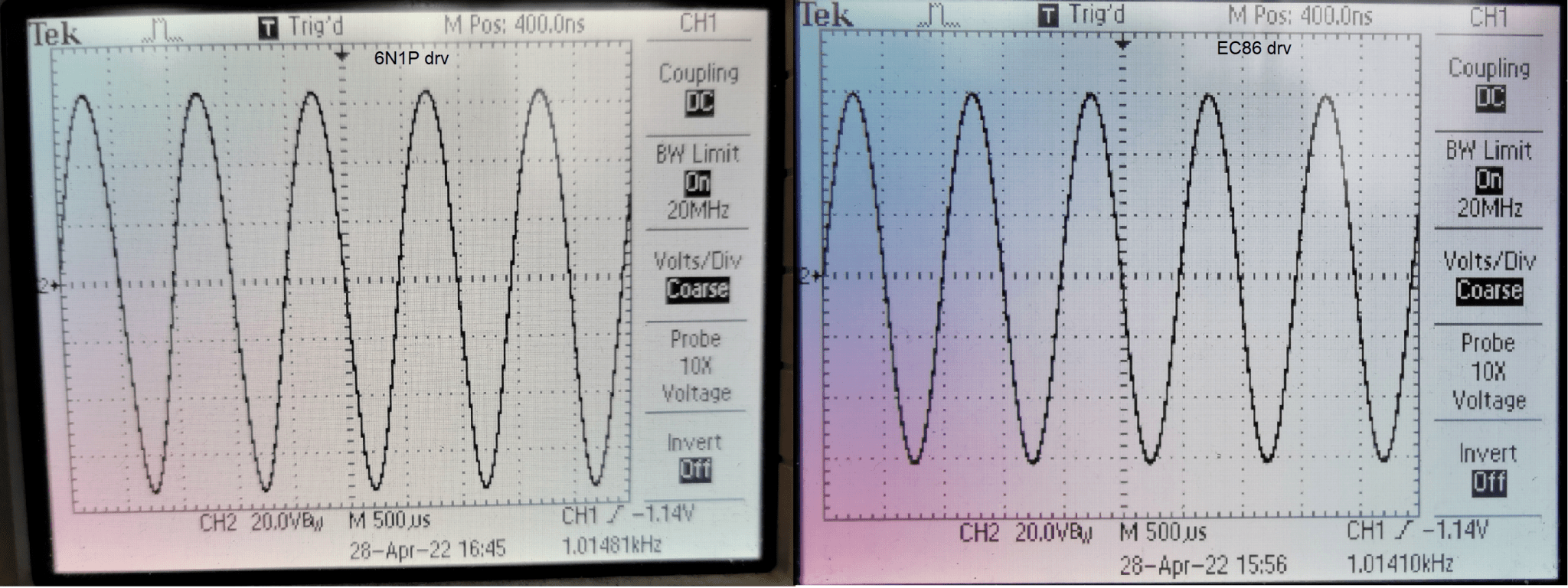

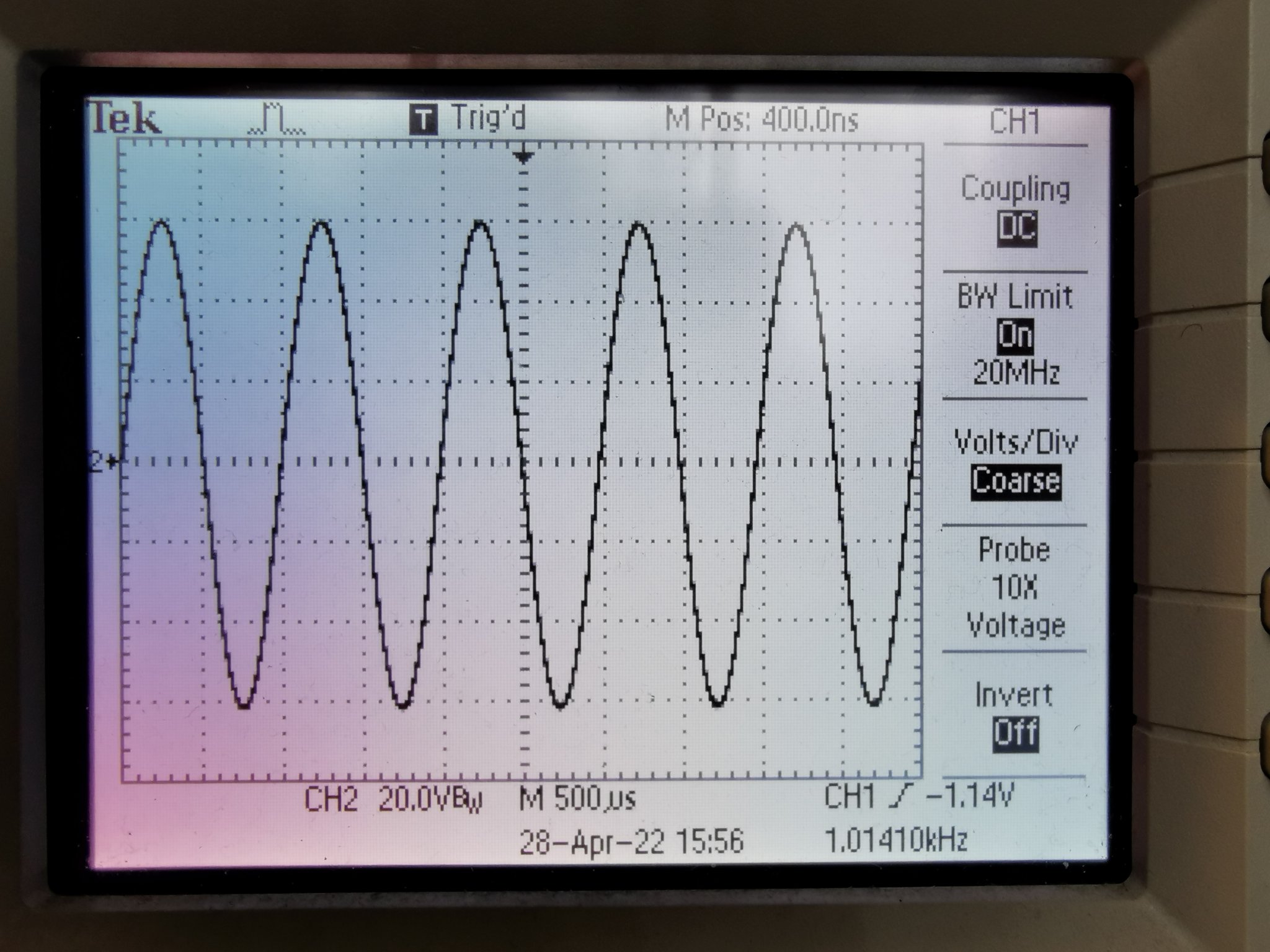

If you have flexibility for the input tube, there are other options that would make your life easier. I have used EC/PC86 triodes, very linear, easy to get 60Vp (120Vpp) with low distortion, u ~60.
