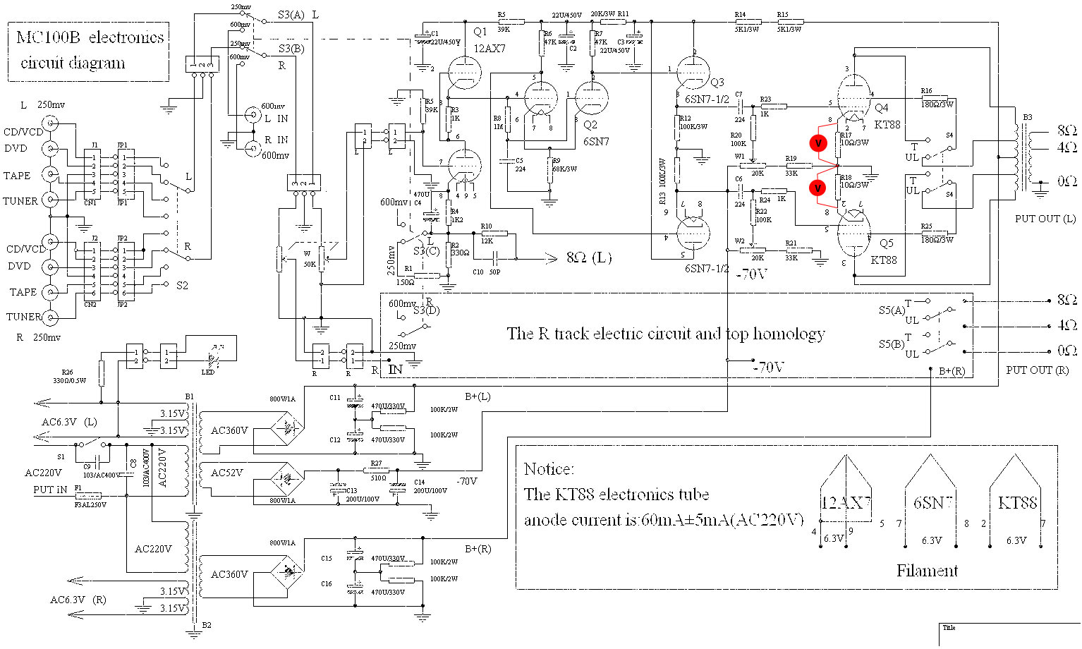

My amp has KT-88/98 output tubes (4), 12AX7 (2) tubes that can be called "input" tubes, and four 6SN7 tubes. The amp sounds a bit bright and is missing some midrange and some tightness in low tones. I hear about rolling output tubes, and I believe rolling the 12AX7's would also impact sound. Would rolling the 6SN7's impact the sound also? This amp can also accommodate 6N8P or 6H8C tubes in place of the 6SN7's. How do these other types compare with the 6SN7's?

Seriously, your question regarding "rolling of tubes" is pointless without a schematic and even with one, replacing tubes with identical tubes (slightly differing in operational parameters) would result in less a change than a redesign of your amplifier would.

Those symptoms sound like the result of too high a source impedance. That's not trivial to correct. Tube rolling will not have much (if any) effect in that regard.
Thank you. Would this impedance problem be impacted by limiting AC input voltage. The limiting of input AC voltage to below 106 V was suggested in another thread, specific to this particular amplifier. Is this the "too high a source impedance" problem you mentioned, or would it be addressed this way. Again, I appreciate those who are patient with newbies like myself. I am ignorant, but not necessarily dense.

So the two problems you mentioned:
1: Amplifier sounds "bright" compared to what is presumeably SS amplifier with huge NFB (= very neutral sound). This is normal for tubes. If you want it to sound less bright, reduce the harmonic concent. The easiest way to do it is to use more NFB. The obvious way to do it (but not the easiest) is to change the operating points of the tubes so they operate in the more linear region.
2: "Tightness in low tones". I'm not sure what this is but I guess what you are trying to say was that the bass is somewhat lacking (not as "booming" as with your SS amplifier). Again this is something very common with tube amplifiers but unfortunately can't always be fixed as easily as the first part. This can be a result of too severe filtering throughout the amplifier (easily fixable), not enough subsonic filtering throughout the amplifier which saturates the OPT (note that is is directly the opposite of the first point ! also easily fixable) or a result of inadequate OPTs (not easily fixable).
Now what you really should do is try to locate the actual schematic of your amplifier. This will enable us to see where something extremely obvious pops out (and the thread I linked to above suggests such construction flaws, which is fortunate for you because it is rather easily fixable and very cheap - cheaper even than replacing tubes with the same type 😀 ).

Oh. One more thing. Schematic:

NFB is negative feedback - you'll need a lot of homework to understand it well. OPT is the output transformer. Less homework.
Are you listening it in UL or triode mode?
Triode.
