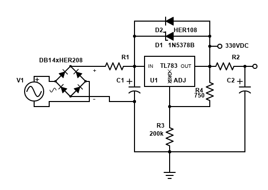

Personally, I'd just ditch the VR and modify it to use a TL783...
Here's my version for 330V or so out from 400V in. It'll be cleaner than the entire supply in the schematic the OP shared and cost less than the price of the choke alone. I build with R1=560R, R2=100R, C1 and C2 100µF
Modify the resistor ratio to change the output. This is good for about 50mA if it drops 75V total. More with a larger heatsink.
I made PCBs for this if you want one...
Your PSU is interesting. Can you post the PCB? It should be handy.
