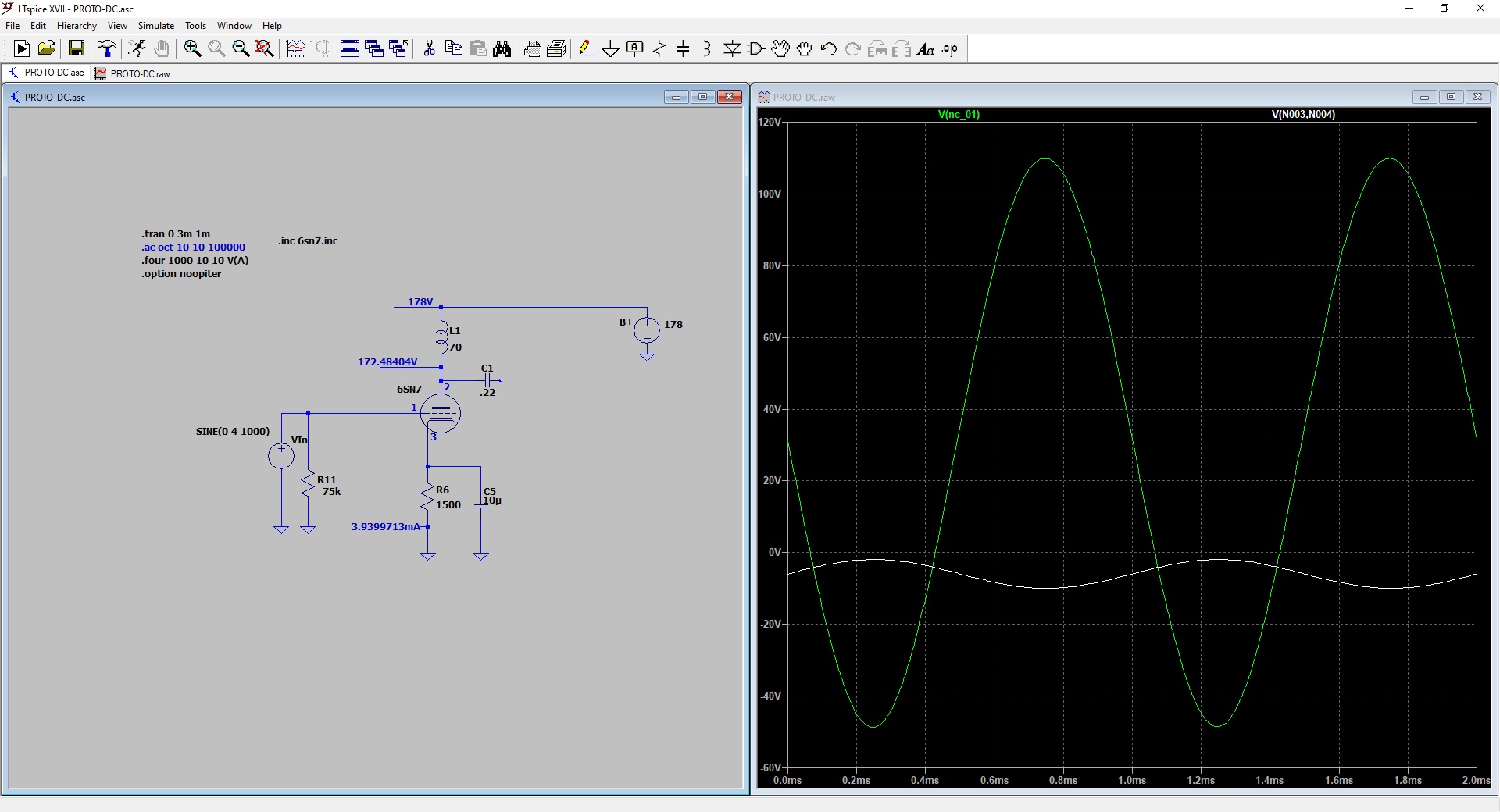

Attached (hopefully) is my schematic for the circuit in question. Please excuse the personal notes on brands etc. This is a plate reactor loaded 6sn7 with which I have limited B+ to work with. I am wondering about the voltage at the cathode resistor which is 7V. My DAC puts out 2v and my lineamp is unity gain. How can I figure out if I am in danger of clipping or if this operating setup is safe? I don't hear any problems but don't have a scope to test. I know that my cathode resistor value is higher than most at 1500 ohms but am very happy with the sound in this setup. Just don't want to damage anything. I experimented yesterday with raising the B+, lowering the cathode resistor value etc. but ultimately preferred the sound with the higher value cathode resistor (much tighter bass). This is the first time I have not used a resistor on the plate of the 6sn7. The 2 sections are paralleled (don't think I mentioned that on the schematic.) I am used to seeing closer to 2v at the cathode resistor.
No a 2V signal is not going to clip if you have 7V at the cathode. Yes it's operating safely at <1W dissipation. The cathode resistor does't have to be any specific value or range of values, it depends on biasing (what operating point you choose). If you're happy with the gain and distortion of that stage, you're good.
A quick sim shows that you can go up to 4V peak without clipping.
