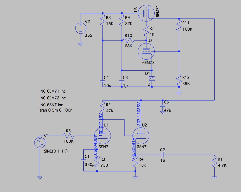

I'm using LTSpice and PSUD2 to model a 6SN7 linestage preamplifier inspired by George Wright's WLA12A line preamp. The WLA12A is the only tube preamp I've ever heard, so I'm trying to match experience with book learning here to figure out how such a circuit might work and possibly to build it.
Project goals:
* No ICs
* 6X5 rectifier
* 6EM7 series pass high voltage regulator
* 2 x 6SN7s set up as voltage amplifier and cathode follower
* B+ supply of 267V (measured by an owner)

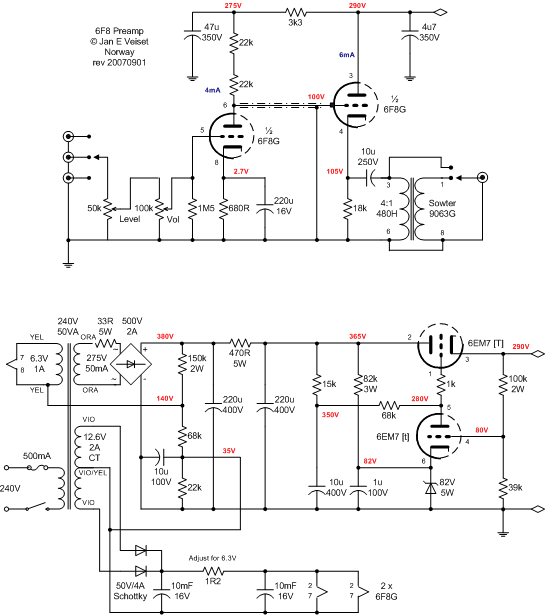

I read up on tube series pass regulators, almost all of which used pentodes as examples. My only experience thus far is with triodes, so I found this 6F8G preamp with a 6EM7 regulator: http://www.diyaudio.com/forums/tubes-valves/71300-photo-gallery-179.html#post1334490/
After looking around for examples of 6SN7 voltage amp/cathode follower line stages, the Vacuum Tube Valley Octal Line Preamp project from VTV magazine (issue 11, Spring 1999) seemed close to descriptions of the Wright preamp. Another builder modified the power supply from an RCRC to a CLCRC filter (6SN7 VTV Line Stage), which was interesting.

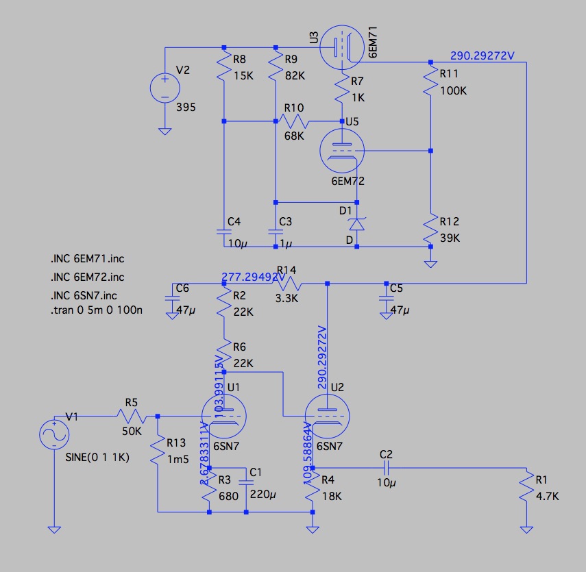

In order to get a handle on all of this, I decided to mash together in LTSpice the 6EM7 regulator stage of the 6F8G preamp with the signal section of the VTV linestage, just to see what the simulation looked like (attached screenshot). Using a DC supply of 365V in front of the regulator stage -- low and behold, it happens to result in a B+ of 267V on the second 6SN7 plate.

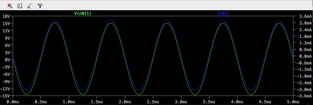

With a 1V AC 1kHz input signal, a 50K resistor between input and first tube grid (i.e. at half the specified 100K volume pot), and with a load of 4.7K on the output (i.e. the input impedance of the power amplifier which follows the line preamp), we get a nicely shaped sine wave that swings between +15V to -15V and a current of +3.1mA to -3.1mA (attached screenshot).

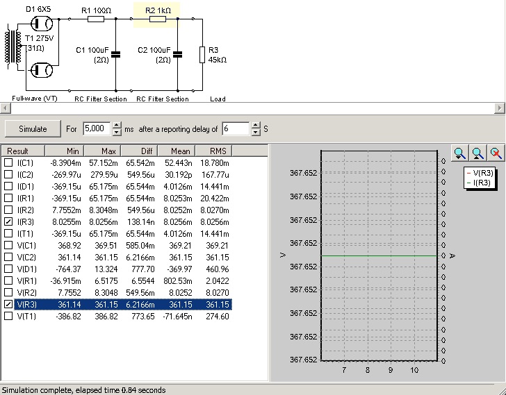

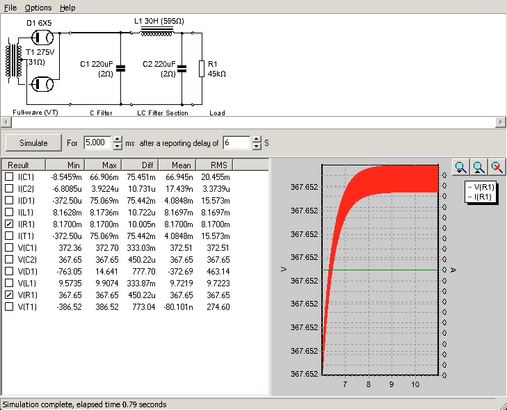

I've also attached two power supply sims done in PSUD2, a version of the original VTV PS (RCRC) and the modified VTV PS (CLCRC), both with a 6X5 rectifier (attached screenshots). They result in about 361V and 8mA with a very tiny Diff measurement on the load resistor, which is set to 45K, which I guestimate to be roughly the load resistance presented by the 6EM7 when run at that voltage. The values can be tweaked to get the 365V, and I'll fiddle with that later.
So my questions are, Does this seem like a viable start? Does either of the power supplies seem better applicable to the project? Any suggestions on how/what to change?

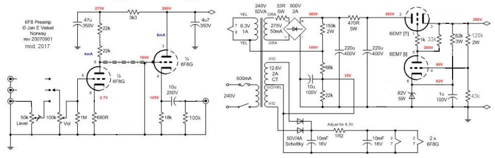

I simmed the Jan Veiset 6F8G circuit listed above, swapping in 6SN7s, and got results close to those listed on the schematic, which we can get closer to by manipulating the DC power voltage (attached screenshot).
The three circuits so far give the following sim measurements:
Jan Veiset 6F8G --> 6SN7 Conversion (6EM7 regulated)
B+ = 290V

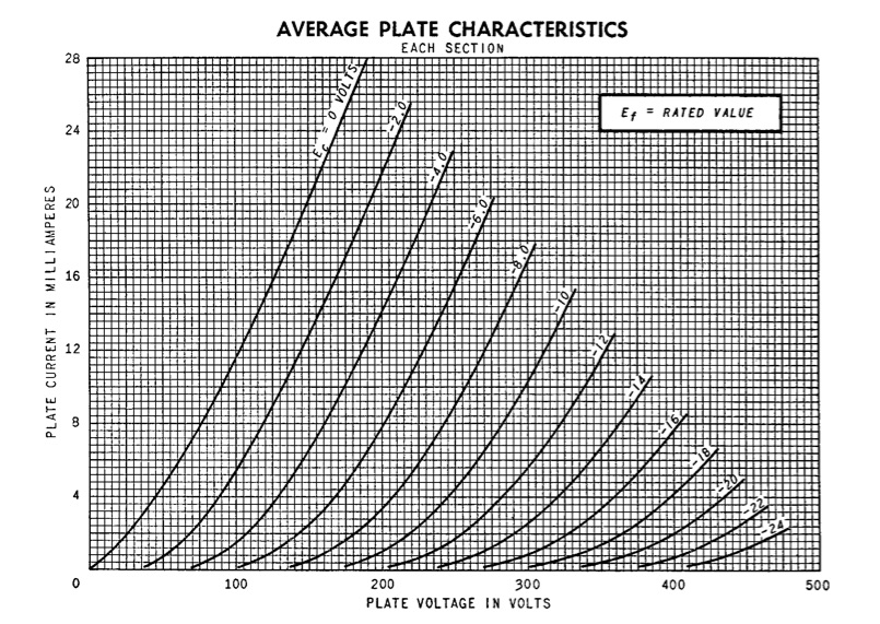

I started looking at load line graphs in the 6SN7 datasheets I've collected, and I'm a little overwhelmed. The easiest one to read is the GE version, which covers the GTA and GTB variants. (attached screenshot)
So now my questions are:
To go about choosing operating points for the two halves, should I start by picking the most linear (i.e. evenly spaced graph intersections) across a line from the X to Y axes?
If so, does "Plate Voltage in Volts" on the bottom of the graph mean Vpk or simply Vp?
Does any of the sims above seem preferable, given your experience?

In the above LTSpice circuit is a mistake. R9 and R10 are connected together, but in the original circuit they are not.
One simple (and maybe most effective) way to find the most linear operating point is to connect the distortion meter at the output and adjust the bias to minimum THD.
Good eyes! Thank you, artosalo. I fixed the model.
Since I started working with that schematic, I've been wondering where the lower outbound connection (diamond shape below the 39k resistor) in the power supply attaches in the signal section. I assumed it was a mistake in the schematic, but is there something more experienced eyes can see?

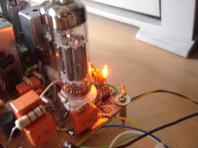

Several years ago I made a linear regulated based in the 6EM7, and it worked pretty fine, but if you want "all tube" like me, then I may suggest to replace the zener with a neon bulb (Without its resistance), it also works very well. Also, a version of the "see saw" amplifier can be used as regulator, with good (or better) results for me. Like this one post #107.

In respect to the neon lamp, take into account that most of them are around 60-80V and needs a higher voltage to strike, and remove any cap in parallel with them, they will oscillate (Relaxation oscillator made), and with a current of about 100µA is sufficient to keep them lighting.

Osvaldo: That's a cool a way to get a pilot light, rather than simply adding one at the on/off switch.

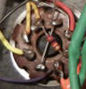

I'm looking at the 6EM7 regulator in a Wright WLA12, and there appears to be a possibly 200K resistor from pin 3 to 8 (cathode 2 to heater) (pic attached). What would be the purpose of this? To elevate the heater supply (6.3V) so that it operates within the 200V Vhk maximum?
