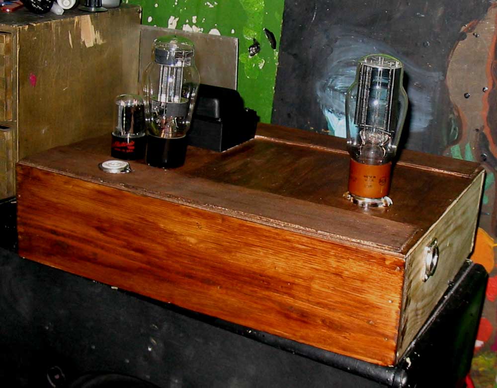

Progress so far. Wine box.
It doesn't work. 0 volts at the 6sn7 cathode. No music, nothing,nada.
CCS= 310 VOLTS IN, 307 VOLTS OUT.
LED's light up. What could be wrong? If i had miswired a transistor would i get 307 volts at the plate?
Any ideas for troubleshooting the circuit?

Clearly, there's no current being drawn. Disconnect the CS from the tube and verify its operation- from the CS to ground, connect a 20K resistor. Is there 200V across it? If so, the CS is working.
Most likely, you've got a wiring error.

About the schematic i posted: css didn't work. Voltages are ok but when is time for the music...oh my! Volume up and down, scratches, weird noises...etc. Voltages do not oscillate. Everything is allright, only i could have mistaken the emitter for the collector but i doubt it. Emitter is the one with the arrow pointing to the transistor right?

Now this is getting funny. I did recheck and tried again the ccs and i don't know what i have built but i know it's weird. It kills some musicians and keep others...i only heard the drummer in the last song... sometimes voices come in and then disappear... all with some scratchs now and then as if a crazy dj had remixed all my cd's.
One thing i have noticed: the 150k resistor to ground(1 watt) gets too hot, i am going to change it to 2 watts, is this normal?

The CCS circuit was fine, it was the current (too much), i lowered it to 5mA and now works like a champ. Thanks to those who helped.
