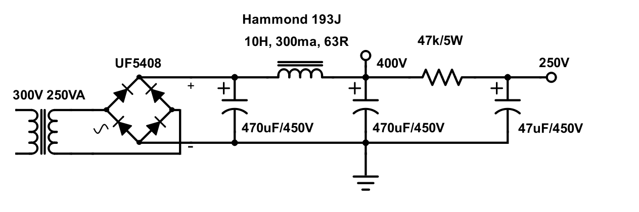

Hi
I have embark on a making 6SL7 preamp using the attached schematic. When the power is on the tube will light up and all seems normal. The entire circuit will trip once the ground of the input is applied to the Ground copper bus. All other ground is via the Ground copper bus except for the heater cct. Kindly advise where did I went wrong?😕
Any comments or suggestion to the circuit will be most appreciated.

Check your layout. The schematic will work, albeit, too much smoothing and 220v at 4.55A is a bit excessive!
Quite unclear from the diagram what your grounding arrangements are.
The PSU has far too much resistance, which can lead to subsonic problems. Fortunately you only have one stage so you should get away with it.

You don't need anywhere near 4.5A from your transformer. The circuit will only require about 2ma per channel. You're using a 1000VA transformer for a <10VA load...
I Also agree with DF96. The large resistances make in the PS make for a very high Zout from it.

Is there any "workable" model/ schematic I can use for the PSU?
The PSU should be able to power up a KT88 SE with the 6SL7 as preamp / driver.

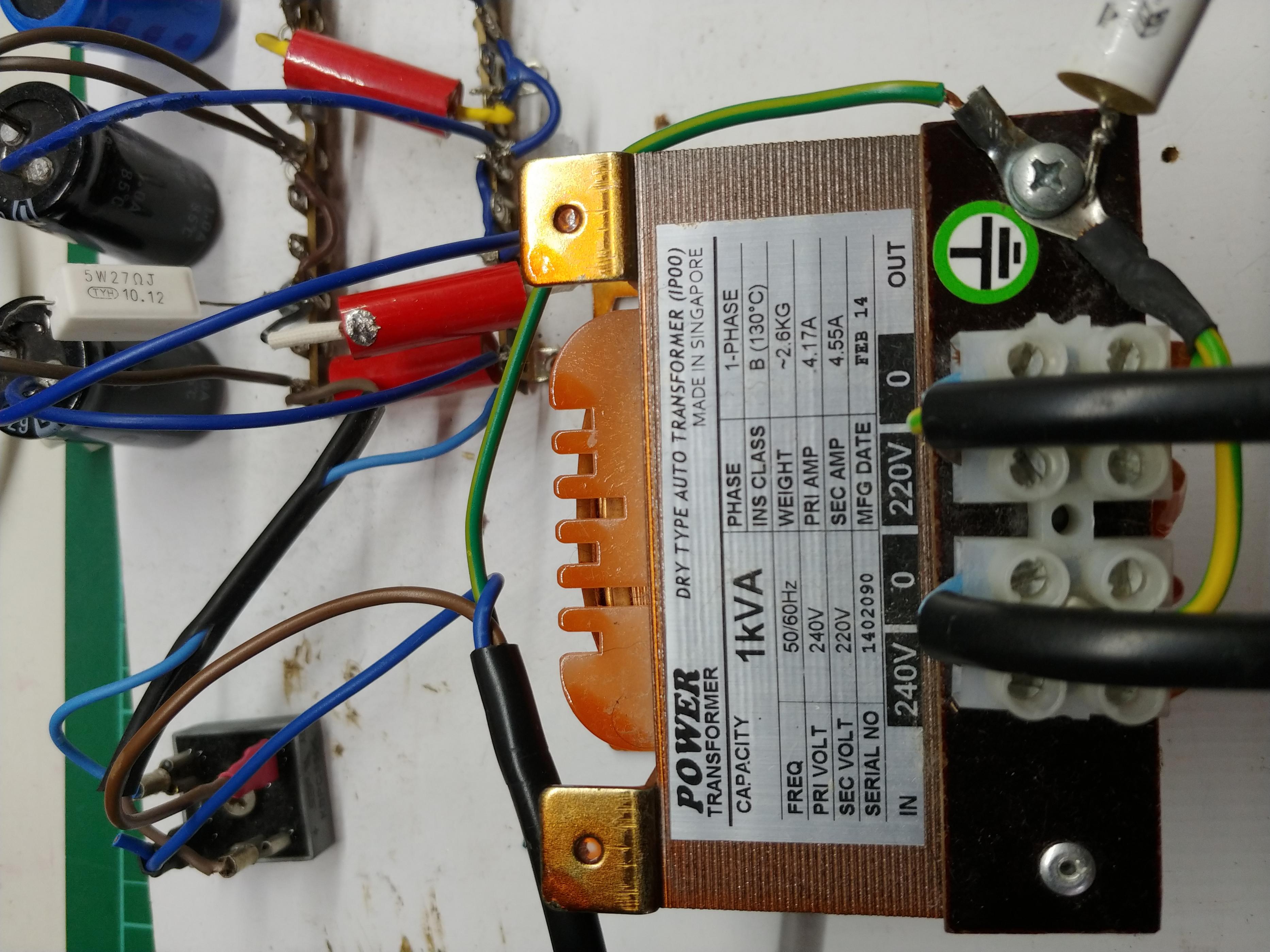

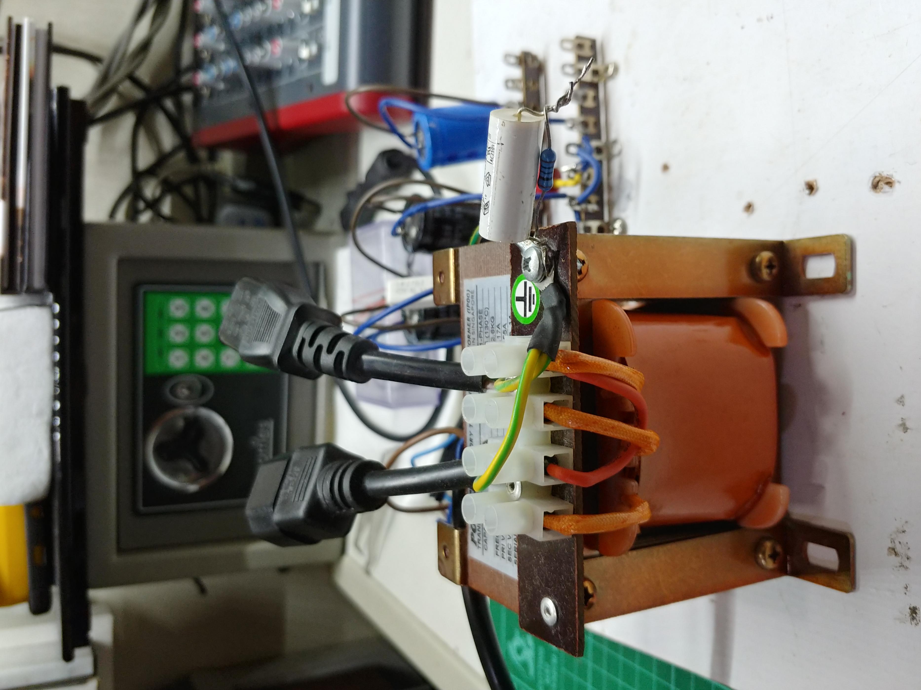

The transformer is definitely a proper power transformer (pls see attached pic) but with a high amp rating.

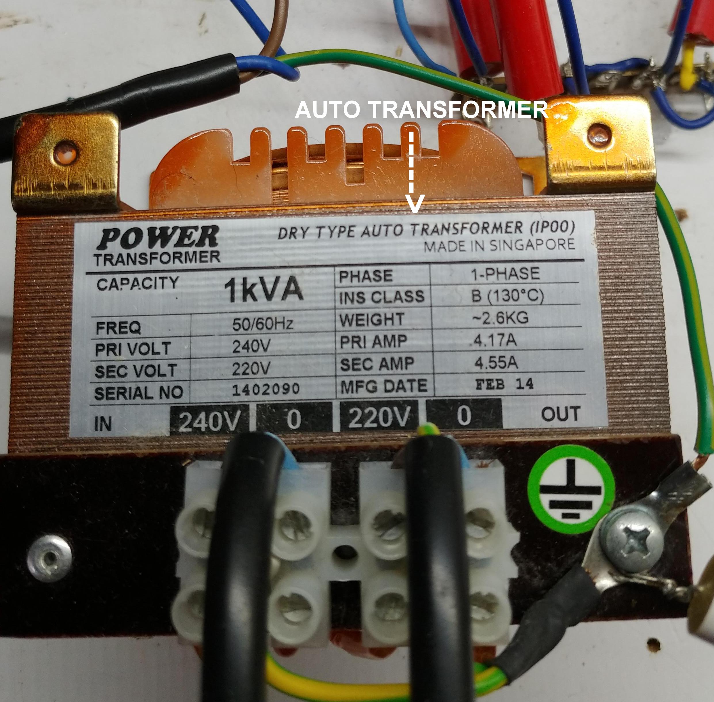

Err, no it is not.

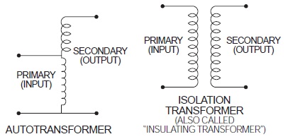

It HAS TO BE an 'Isolating Transformer'. That is Two separate windings with No connection between them. So mains cannot get onto your power supply circuits.
That is an 'Auto Transformer', it actually says so on the label, a tapped single winding. That connects the mains voltage directly to your power supply, and eventually, you, your family and pets. Dangerous - Do Not use it...
Please get a proper isolating transformer before continuing.
Your 'trip' has worked fortunately and already saved you from harm. As others say there are issues with the grounding layout generally, but after you change that transformer...
Err, no it is not.

How can I test for an isolating transformer or an autotransformer if there is no marking on them?
Thanks once again!!!!
How can I test for an isolating transformer or an auto transformer if there is no marking on them?
Easy if you have a multi-meter.
Select either the 200 or 2K Ohms range. Make sure the transformer is not connected to anything of course and clip one meter lead to any lead/tag on the transformer, then touch each of the other leads/tags in turn.
- If it is an Auto Transformer, every lead will give a resistance reading.
- If it is an Isolating Transformer, only one or two of the leads give a resistance reading, but all the others will read 'Open Circuit'.
Go and test the low voltage one you have and see.
