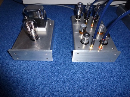

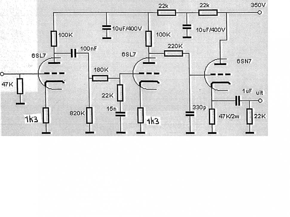

I have built a phono amp and it doesm not sound as I suspected and as promised 😡the high frequencies sound compressed and there is no air around the instruments. Are there comments or remarks about the scematic that I use?

I'm not surprised: that design is hideous. The first 6SL7 is loaded way too heavily. The design nominal plate resistance for this type is 44K, and with a 100K plate resistor, and the RIAA network, the effective plate load is right around 62K. Triodes like very light loading in order to operate in a linear manner. That would be bad enough, but the cathode degeneration drives the effective plate resistance even higher, making the loading that much worse.
The second 6SL7 stage still has a barely adequate 100K plate load, and that would be the case without cathode degeneration. Adding in the extra plate resistance makes that 100K far too small for this type. I've used 6SL7s before, and I like a much lighter plate load. That's simply the nature of the beast: the lighter the plate load, the better the linearity to the practical maximum of CCS plate loading. The 6SL7 is one of the better audio triodes, but it doesn't work magic, and it can not compensate for a fundamentally bad design.
This was designed by someone who really didn't know what he was doing. There is a lot of that going around these days, and tubes aren't transistors. Unlike transistors (or vacuum tube pents) what you hang on the cathode affects the plate characteristics (and vise versa). Here, the designer overlooked that detail.

If you are serious about getting into DIY and want to learn some things, don't dismiss this project so quickly. Although it has it's flaws as some pointed out, it can still be made to work. Will probably not be the best phono ever, but surely can make a good learning piece. Since you already built it, why don't you get more into it, undestand it and learn enough from it to make your next one better.
The RIAA networks seem in the correct region, they probably did not take all the stray parameters into account, but surely are not way off.
I'd get a iRAA and measure it, then see were it deviates from the ideal and try to correct the RIAA. Most likely the 330pF needs to be lowered to give more 'air' at the top end. I'd also bypass the cathode resistors with 47 or 100uF.
The output is already unecessarily loaded with a low 22k. I'd increase that to 220k to ease the load. Even 1M is good there..

In the schematic you posted, the cathode bias resistors have been altered, why?
In the original circuit, were they capacitively decoupled?
Have in mind that the plate resistance from tube (Rp) is added to (mu+1)RK to form the definitively output resistance of the entire stage, and it then modifies time constants, given fixed external resistors and capacitors. So, the zeros and poles (Time constants) of RIAA are out of place in the freq/amplitude response chart of your amplifier.
Good luck!
Hi Thomas,
You're right !!!! I've bypassed the cathode's with 100UF caps
And the 330PF reduced to 220pF (I had no other values😉 )
and the output load increased to 220k , It is much better already !!!!😀😀

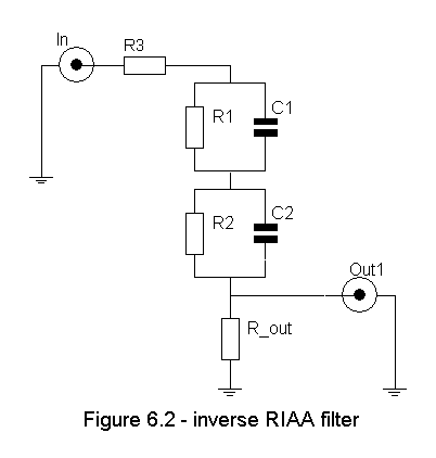

What is the best way to measure the riaa network , i have made a reverse riaa network but I can not verify the accuracy😕
Once again. The output impedance seen since out of the tube (Including Ra or Rp), enter in the times constants RIAA needs. The cathode circuit of any valve (Triode, pentode, etc.) also indirectly makes this Rp. Suppouse a triode, your case. When the cathode resistor is UNBYPASSED, it reflects to the plate circuit as mu+1 bigger than the resistor itself. Example: say rk= 1k, mu = 20 Ra = 100K, umbypassed resistor is seen in the anode as:
RP = 100K + (20 +1)1K = 121Kohms.
In the example, bypassing the resistor, becomes rp only, then RP = 100K Then the output impedance is 21% more when unbypassed. The same result happen if you change the resistor value. Let reduce 1K to 500R:
RP = 100K + (20+1) 500R = 110.5K
The final value of output node is this RP in parallel with R load (The r from plate to +B).
Ergo, modifying ANY in the circuit, including plate resistor values DOES modify time constants, the RIAA response WILL be modified. Then, the audio response will be lost.

As for the iRIAA:
Use low tolerance (1%) parts to build it. You can verify it by running a frequency sweep and compare the output against a RIAA frequency response table. Or verify it with a known to be good phonostage. It should provide a linear frequency response if you feed it from a signal generator through the iRIAA.
