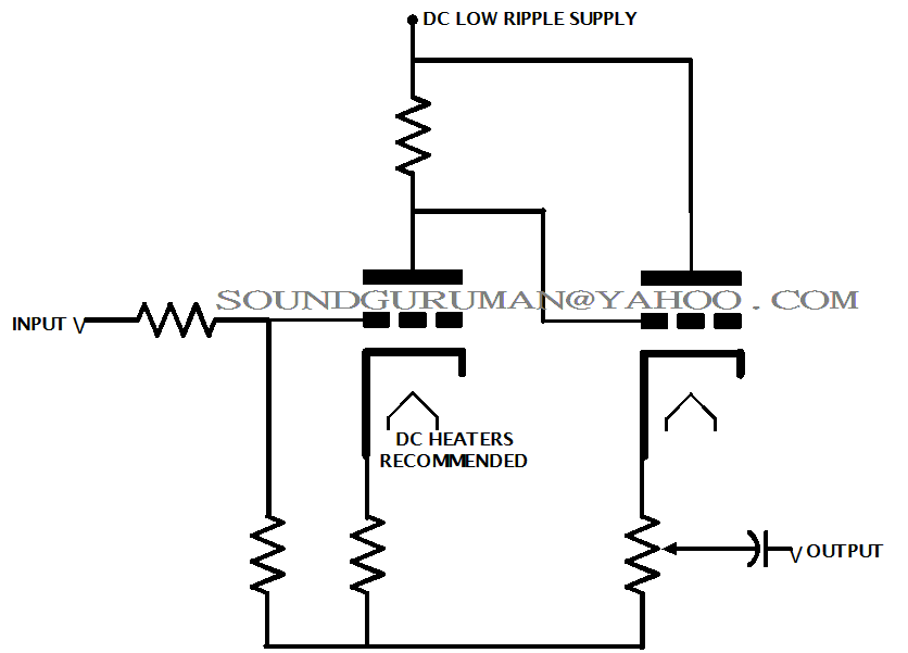

So I have a handful of the following tubes, 6SL7, 6J5, and 6SN7. For a fun small project I'm thinking of building a very basic unity gain line stage for my computer/desk. I have a small pro-sumer balanced audio interface and a pair of KRK powered studio monitors. The problem is I don't really want/need any gain between my DAC and powered speakers but I'd like to introduce a little tube sound to warm things up a bit. I've been playing around with load lines for the 6SN7 but even with the steepest line (low Va high Ia) I still end up with an 8-10 volt swing on the output (way too high for my monitors). So I'm wondering, is there an operating point or circuit using a single 6sn7, 6J5, or 6SL7 (one side for each channel) or other variant listed above? I'm trying to keep it as simple as possible and will use nothing more than a blocking cap on the O/P. Any thoughts?
I'm trying to post a schematic, see if it worked...
How does the second triode get its anode power supply?
The first stage is a gain stage to saturate the grid of the second stage..that will give it some tube harmonic overtones.
The second stage is an attenuator, there is no anode voltage. It still must have a heater, though. That's why DC heaters...
A unitiy gain buffer will NOT introduce much "tube sound". If you design it correctly it will have so little distortion as to be completely undetectable by ear. Every unity gain design (stating with the cathode follower) has "tons" of negative feedback so the thing will sound just like a length of wire.
If you want to introduce that "sound" you have to amplify the signal. Then if unity gain is designed attenuate the signal back to a net effect of "unity". The extreme case of this is the preamp section of a guitar amp. They create a voltage gain of say 60x and then send it to a pot to reduce it.
If I wanted a buffer to introduce a "tube sound" I'd use a 12AU7 common cathode gain stage and run the output to a voltage divider. The result will sound like a triode amp.

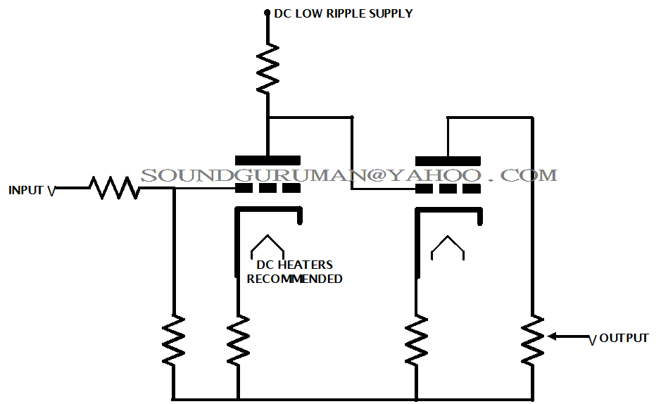

second way, more current?
This circuit is EXACTLY what was asked for. The output pot is the voltage divider I was talking about. Two fixed resisters would work too as would a trim pot. (once you set this you will never need to change it so don't bother with a knob unless you are building a guitar amp.)

I see what you mean Chris. I didn't notice the pot on the output before. The unity gain "sound" makes sense, if you're not amplifying the signal no coloration or HD. I'll give soundguruman's circuit a shot. I still want to stick with the 6SN7's since they're what I have, and I like octals anyway. Perhaps I'll run them modestly so as not to have too much to attenuate. I happen to have an unused 269AX just sitting around that'll be good for 350v or so after filtering and I'll DC the heaters.
