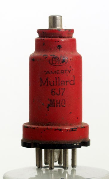

I was thinking 6zh7 is a 6J7 not a 6J8
6J7 has a top cap
6J8 didn't has a top cap
but now I'm confused
K
6J7 has a top cap

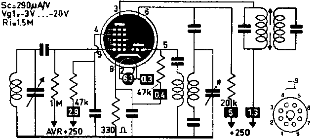

WOW !!
I think I solved the mistery 😀 😀
there are two 6J8 tubes
one is 6J8 the other is 6Ж8
as known J = Ж
but one, the 6J8 tube is a triode / pentagrid tube
the 6Ж8 is a pentode

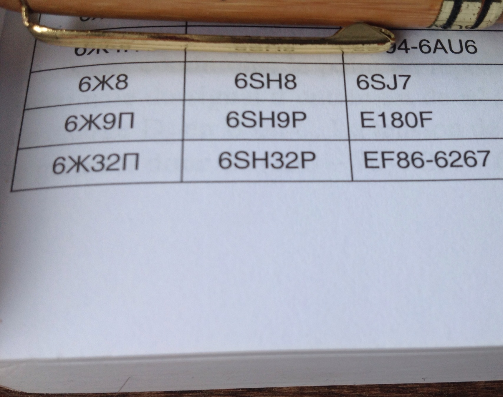

I would like to know if the russian 6Ж8 tube is a good substitute for the 6SJ7 tube
@ Kagliostro
From Francis Ibre book " Audio Tubes " Elektor |Publitronic
Yes 6SJ7 = 6Ж8 = 6SH8
Best regards
but 6SJ7 is slightly different from 6SH7

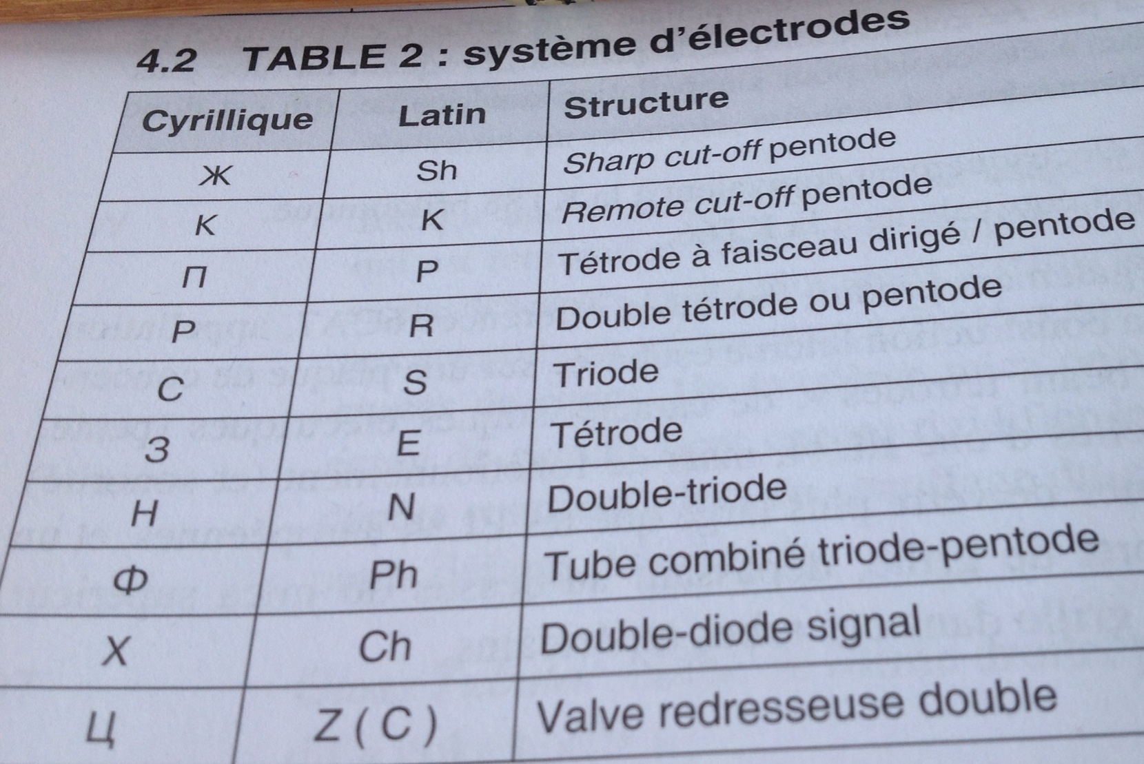

Cyrillic has 31 characters IIRC as opposed to 26 in the English alphabet and as a result there are several analogs used for the Ж character including "J" "ZH" and perhaps "SH" I generally use the Russian character when ambiguity exists or most commonly the J.

I'm not able to find info about 6SH8 you mention....
After book cyrylic Ж = SH in latin characters
Best regards
OK, I'm not a good connoisseur about cyrillic characters
I use this correspondence table that is on Duncan's tube search
TDSL Cyrillic characters
Many thanks for the info
