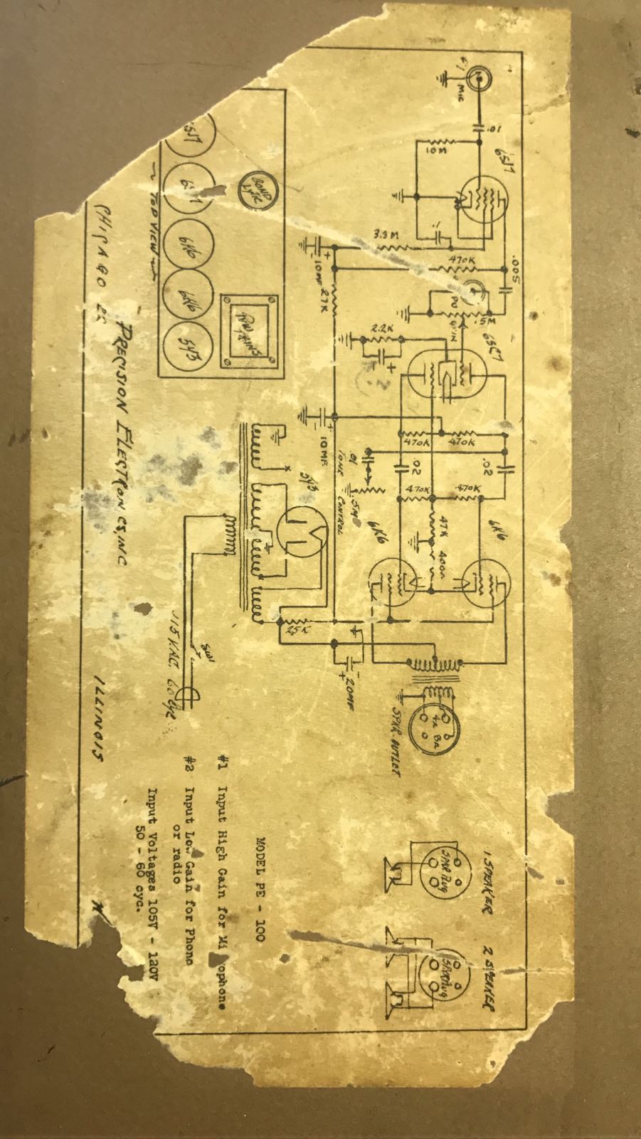

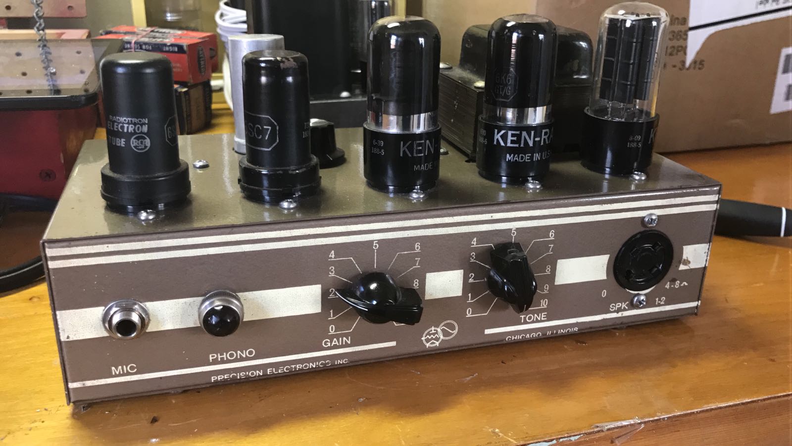

Hey guys, I have an precision electronics PA amplifier that I've converted for guitar use. It has a grid leak bias 6sj7 for the first gain stage. Then it uses a 6sc7 for a phase inverter and drives two 6K6's. The amp sounds great but it has very little headroom.
Is there a way that I can lower the gain on the grid leak bias 6sj7? The plate voltage is about 80v. There is a 10meg resistor from the input grid to ground. There is a .1 cap from G2 to ground. G2 is fed voltage through a 3.3meg resistor.

No, grid leak is for DC return from grid to cathode. Use 1MΩ as standard. To reduce gain with pentodes, reduce anode (plate) load resistor. Or put a preset between stages.
So let me see if i understand this correctly. Lowering the plate load resistor would raise the plate voltage, thereby reducing the gain of this stage?
No so. In a pentode, gain is apx. gm * Rl, independently of plate voltage. Gm is mainly governed by screen (g2) and control grid (G1) biases. So reducing plate load resistor effectively will raise anode voltage, without any future complication.

So I reduced the plate load resistor from 470k to 235k. It seems to have a negligible effect. Input signal from guitar is about .5v.
Dave is wright, perhaps grid leak of the following stage is too low to represent a real reduction. Try a 100KΩ. Warning with high voltages in the circuit‼

Old microphones were much weaker than modern guitars. The 6SJ7 gives gain of 100, but never expected even 100mV input. A benchmark target gain for this stage for general guitar use might be 20. Also a plate voltage which isn't slammed, so it will take large inputs.
There IS a reason some early guitar amps used grid-leak then shifted to cathode-bias mid-1950s. Guitars are stronger than grid-leak.
You can triode-strap the 6SJ7 with cathode bias and get a gain about 16. Use 470K or 270K RP, snip 0.1u, strap G2 to P, add 1K RK, shunt 1Meg across the 10Meg, and optionally short-out the 0.01u cap. Like that is gain of maybe 8. Be prepared to add 10u across RK for gain of 16, but you may not need it.
Or consider re-connecting for a hi-Mu triode. In octal, 6SC7 is a classic, and you already have one. As a 1st stage, just use one side. You can steal RP and RK from any 12AX7 plan (close enough); or steal from the PE's 2nd stage RP=470K, Rk=3.9K (for one). A single hi-Mu Octal is the obscure 6K5, sells for $7. Need a top-cap clip.

Grid leak bias is completely unsuitable for guitar amps. You need to convert that to a cathode biased stage, with a 1M or 470k grid reference resistor to ground.
One other thing about 6SJ7s, is they will still develop a DC voltage at the grid, which will make your guitar pots go noisy. The fix for this is to place a 0.1uF cap between the grid and input jack.

That's correct. For a guitar amp you need at least one gain stage before the PI. Overall the less you change this amp the better. The one input that any straight to the PI would have been for a record deck with a ceramic or piezzo tranducer, which have a very high output relative to a guitar pickup. FYI I used to design just amps for my day job. 🙂
Also what have you got against distortion? I know tastes vary, but it seems a shame to have a board amp that won't distort at all. Typically, the aim is to have clean/distortion tones that can be controlled by the guitar volume control as well as how you pick the strings.
Sent from my phone. Please excuse any typpos.
I would also strongly recommend all suggestions to triode strap or place NFB around the 6SJ7, as the non linearity of these pentodes provided a really sweet guitar tone, that would be a huge shame to lose. I recommend checking out Valve Wizzard Merlin's page on how to design pentode gain stages, to set the gain level to what you actually want, while preserving the pentode tone.

I'm going to try triode strapping the 6sj7. I think this is the best option.
