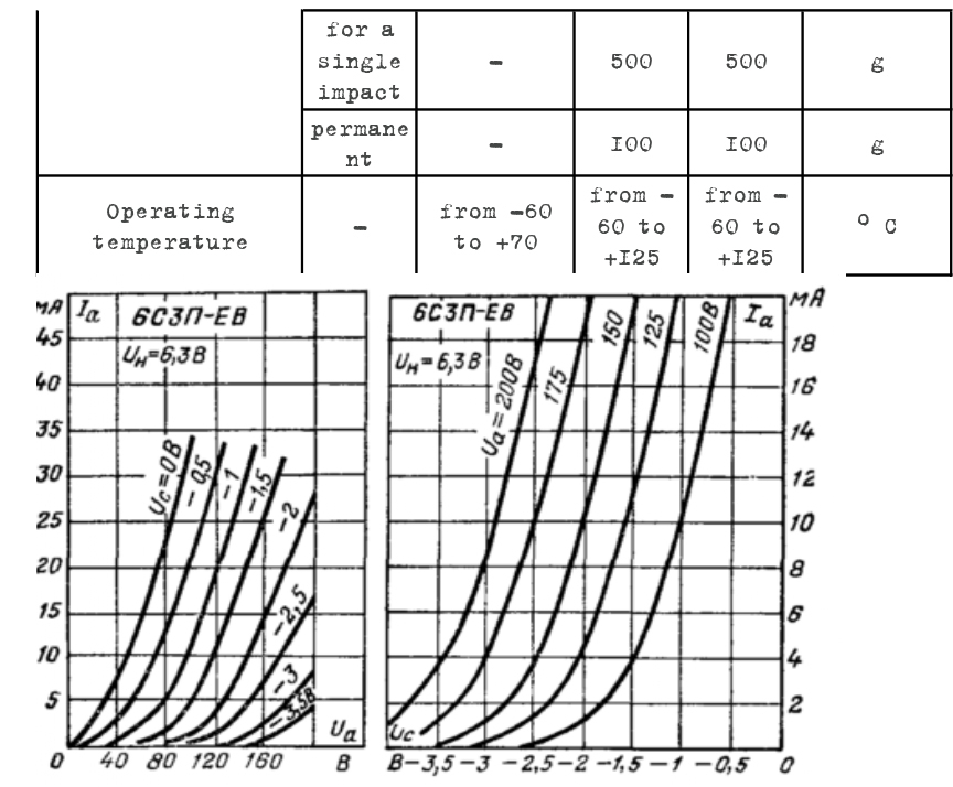

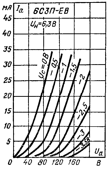

The Russian 6S3P-EB tube seems to be a good candidate for Cathodyne PI. It has high gain and low plate operating voltage to allow direct connection. See charts attached.
However, I could not find any reference to this application. In fact, I can't find many applications for this tube on the Internet. Are there any reasons this tube is not popular for audio? Availability? Microphonic? Poor sounding?

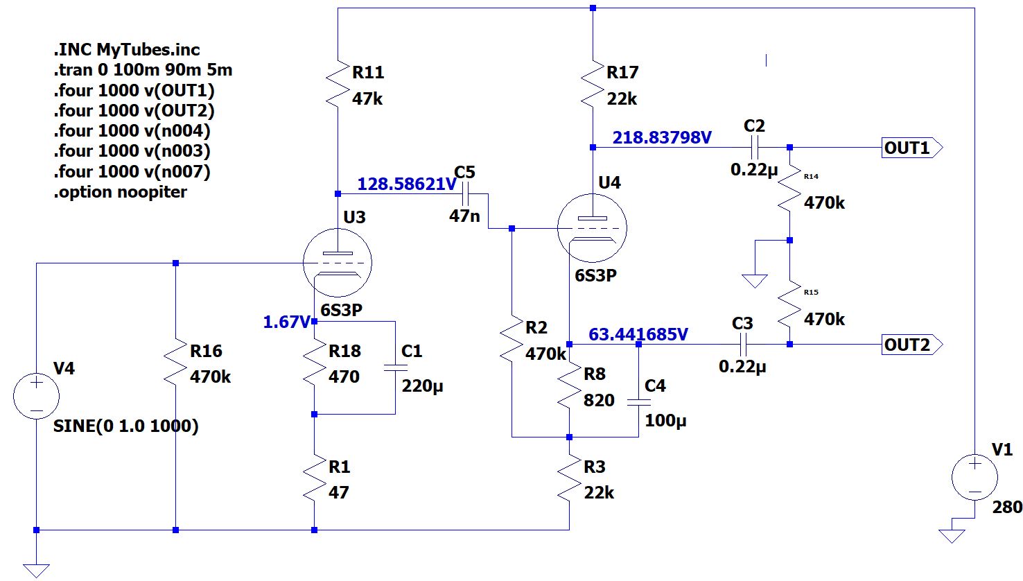

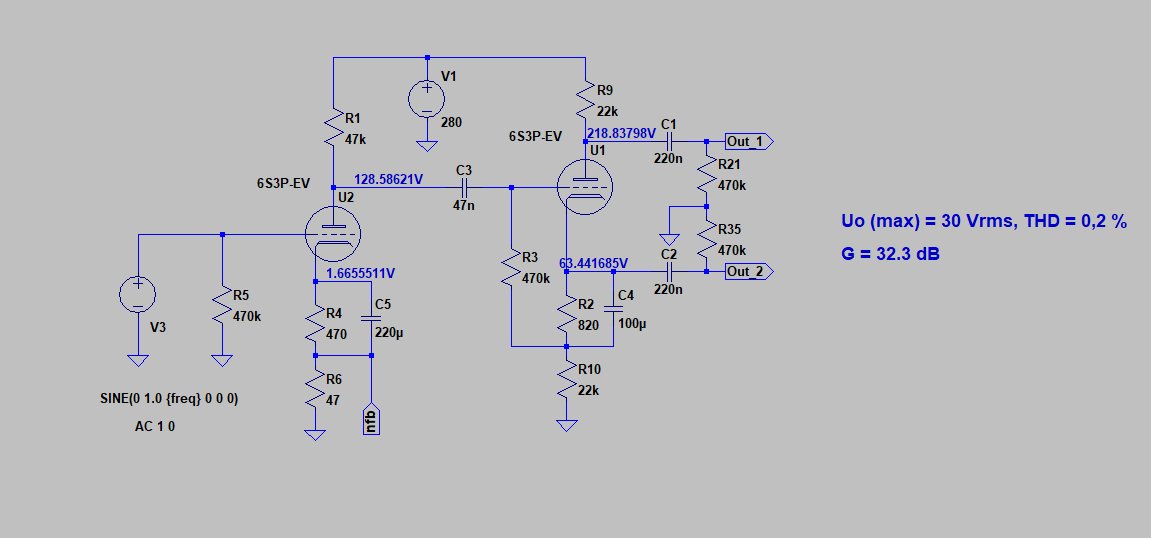

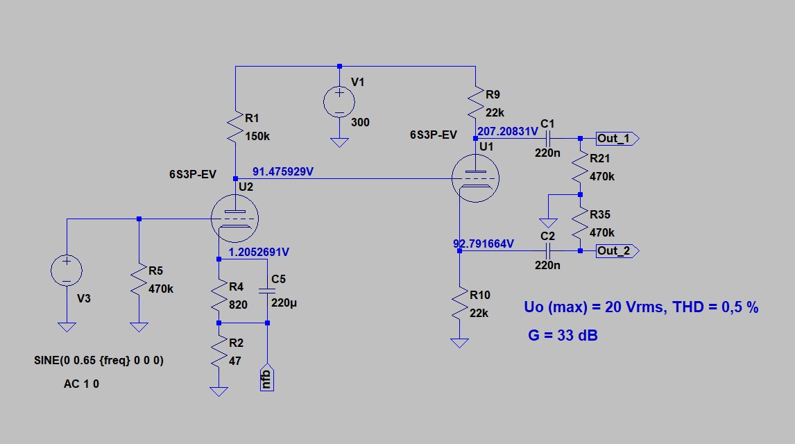

How about two tubes direct connected...
That is possible, but direct connected amp/cathodyne is a compromise because the voltage amplifying stage biases the phase inverter.
However it works fine if the output stage does not require very high drive voltage.
This could be one circuit to start with.

6S3P (6S4P) is a great tube, not microphonic at all, great sound, long life and easy to supply. The difference between 6s3p and 6s4p is that 6s4p is designed for ground grid connection and has a different pin layout.
I used 6s4p with a grounded grid in I / V conversion in my DAC and as a cathode follower, sound much better than the ECC88 I used before. Now I use 6HM5 for I / V conversion.
A friend uses 6S3P in his phono preamp and I can only say that it sounds incredibly good, clean, noiseless, great dynamics. 6S3P (6S4P) likes slightly higher currents, from 10 to 15mA.

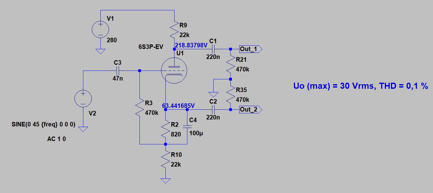

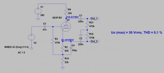

As a reference here is ac-couple version. With 280 V as +Ub it can deliver 1.5-times (30 Vrms) bigger drive voltage with lower THD.

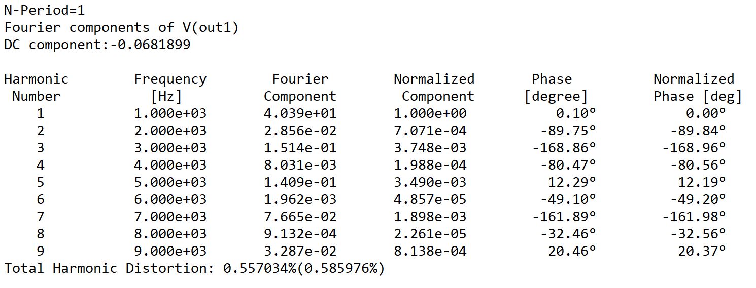

Hi Artosalo, I set up a LTspice simulation on the suggested circuit. I got the same voltage and gain as yours. Looks like we used the same model.
However, the THD from my simulation is 0.557% instead of less than 0.1%. See attached. As I am not well versed in LTspice, I did my simulation at a fixed frequency of 1000 Hz. Can you please explain how did you get the less than 0.1% THD? Thanks.

We used different tube model. Mine was 6S3P-EV:

Anyhow, the simulated THD is often indicative, not accurate.
