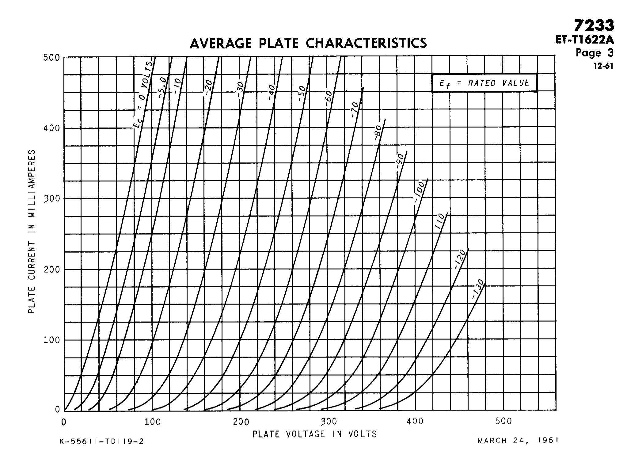

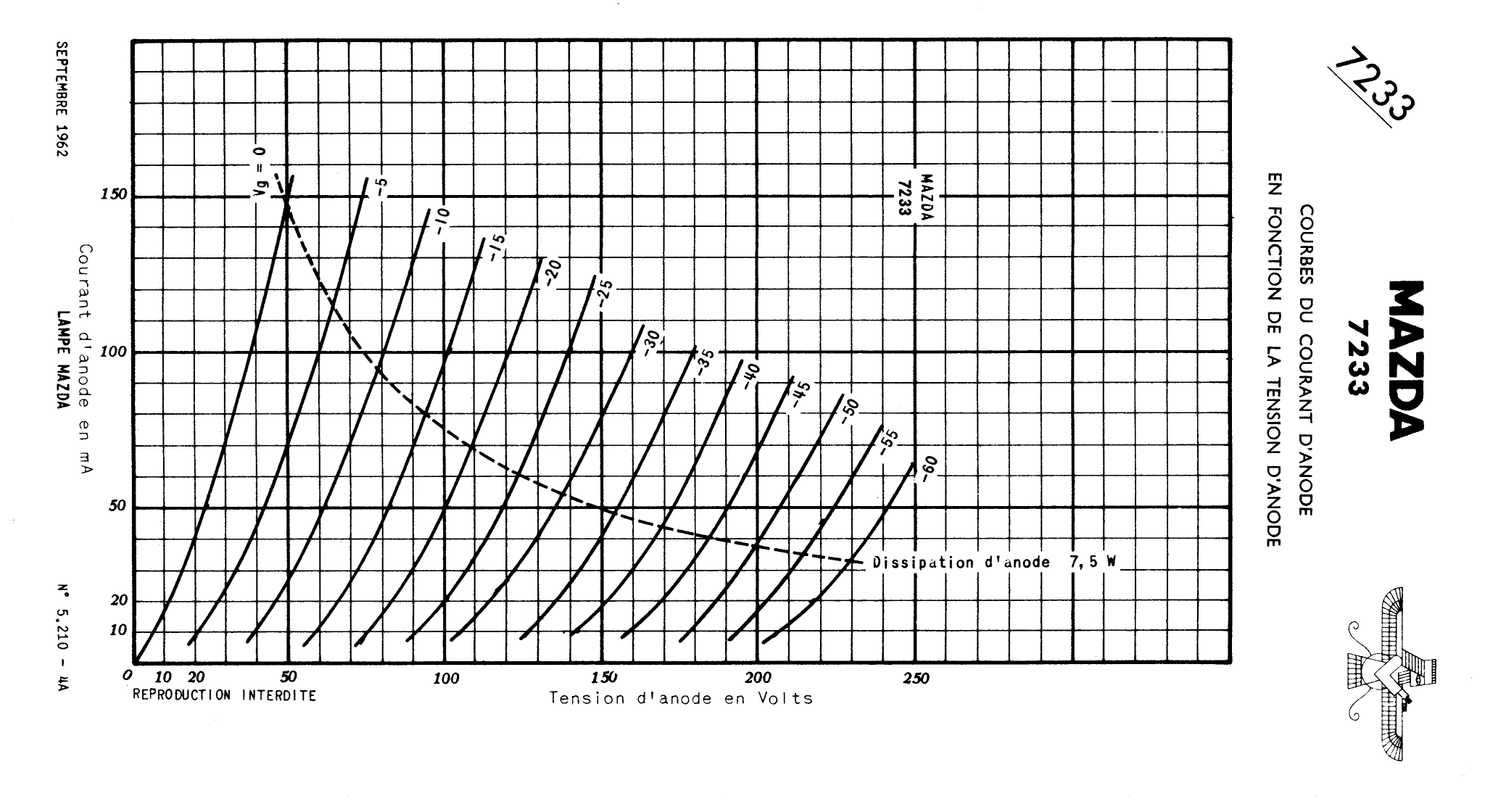

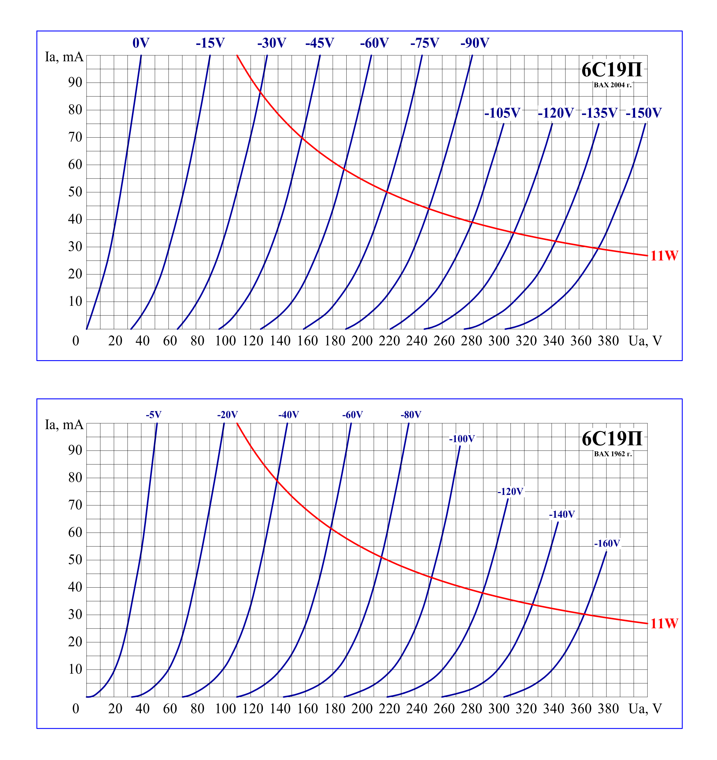

Hello Everyone 🙂
I am about to build and test the low mu preamp design of Mr. Pete Millet. I have made contact with him and he have helped me with some questions about using 7233 single triode tubes instead of 6AS7 double triode. (Thanks Pete 😉)
But it is actually a little hard for me to find the 7233 triode.!
Now - I know about the russian equivalent 6S19P or 6C19P.!
Still I don't have the knowledge to understand the datasheets for these tubes to find out if I just can plug in a russian 6S19P instead of the 7233 tube without any changes in the 7233 tube circuit.?
The only thing I can see and understand is the recommended resistance in grid leak circuit: 7233 = 1M and 6S19P = 0.5M
And maybe something about the pinout, but that is no problem for me🙂
Can you guys tell me something about this matter.? I will be very happy 🙂

6s19p is not so different from half a 6AS7; maybe slightly higher ra and a little bit more linear? I presume you can understand the pinout on the Russian data sheet?

First beware of the pinout differences. Plugging a 6S19P into a 7233 socket will cause a direct short across the heater supply which in my case caused the 6S19P to shatter!
Other than the pinout issue the tubes are relatively similar. In my cathode follower amp they both worked about the same.
How is that? Looks like they have the same heater connections, but pins 8 and 9 are reversed.
You are right. I don't remember the details, or exactly how the socket was wired, but somehow two of the multiple plate connections got across the 6.3 volt 10 amp heater winding of my power supply and the tube shattered.
I had breadboarded a cathode follower output stage that had a 9 pin socket and I tested the 6S19P, the 7233, the 6S4, the 12B4 triodes and some pentodes like the 6CW5 and some unmarked Bendix tubes. The 6S19P and the 7233 were the best performing tubes. The 7233 is about $10 each although I had several pulled from scrap HP test equipment, but I got a box full of 6S19P's from an Ebay seller in the Ukraine for $30.
