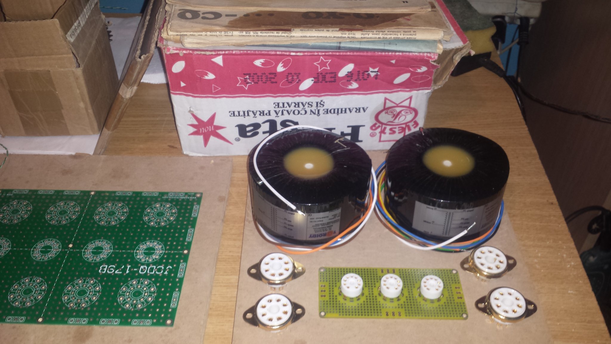

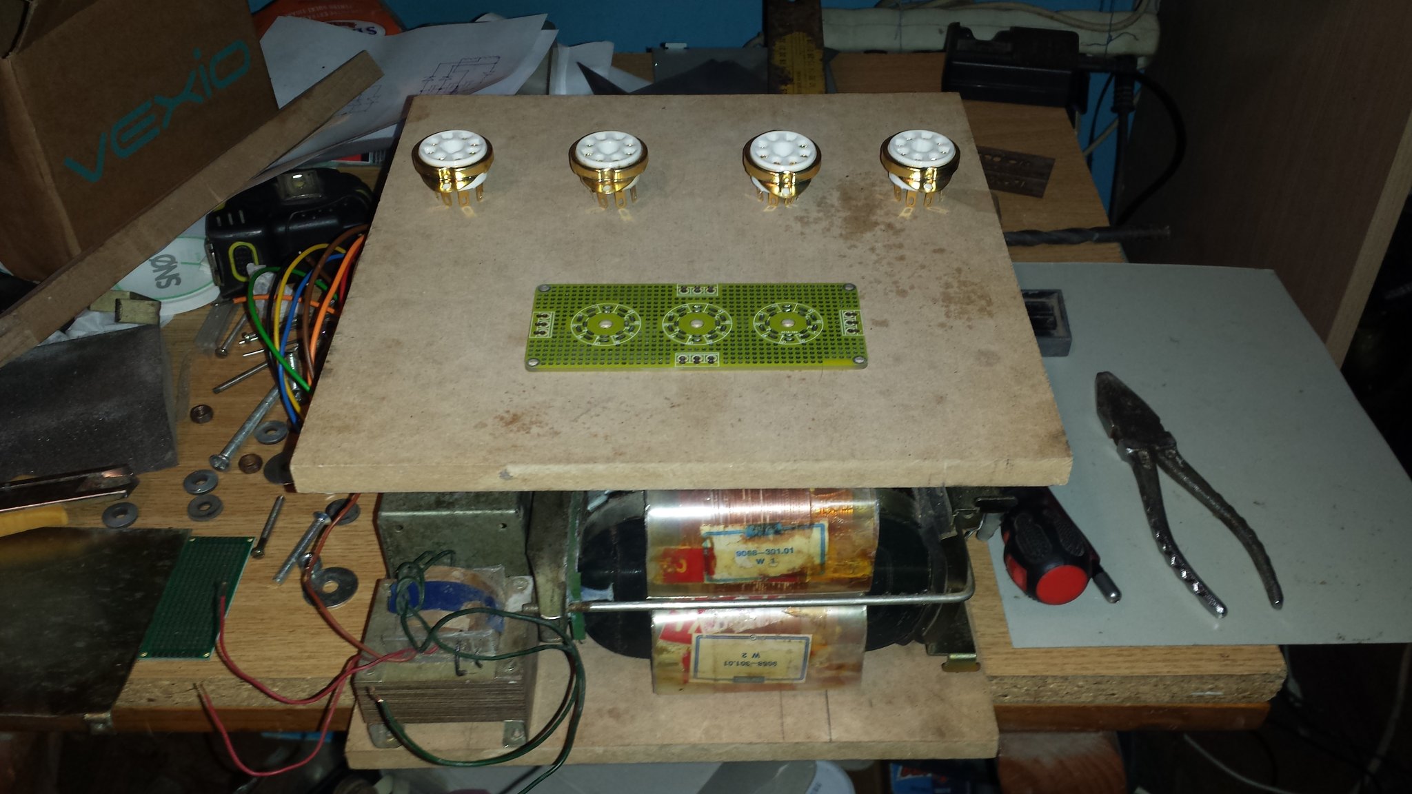

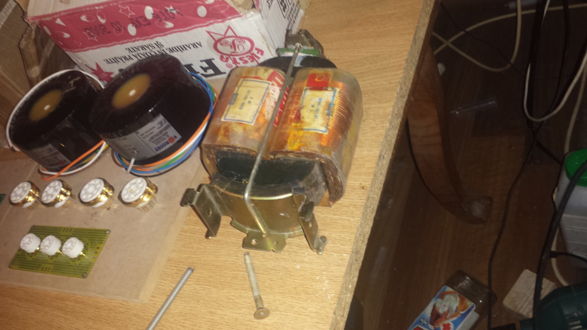

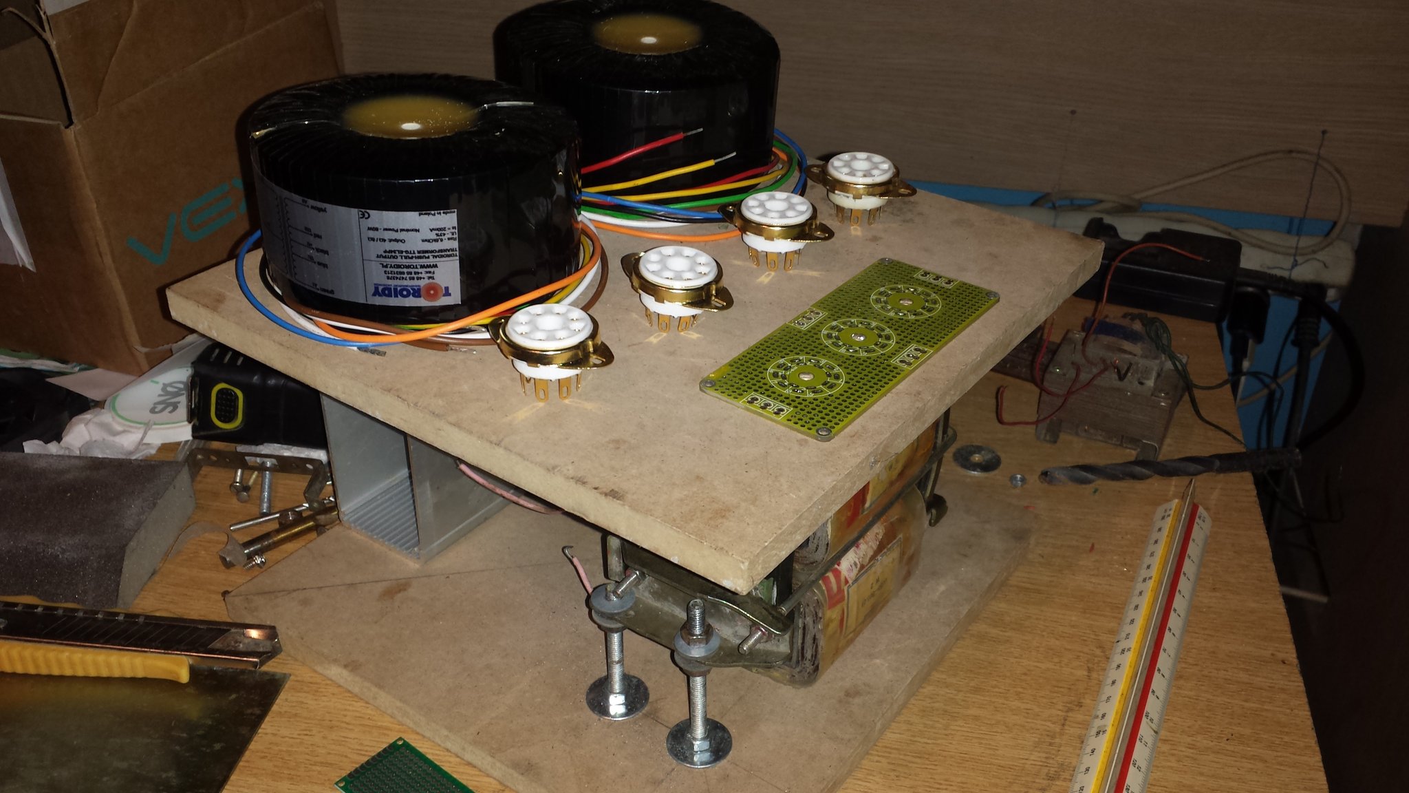

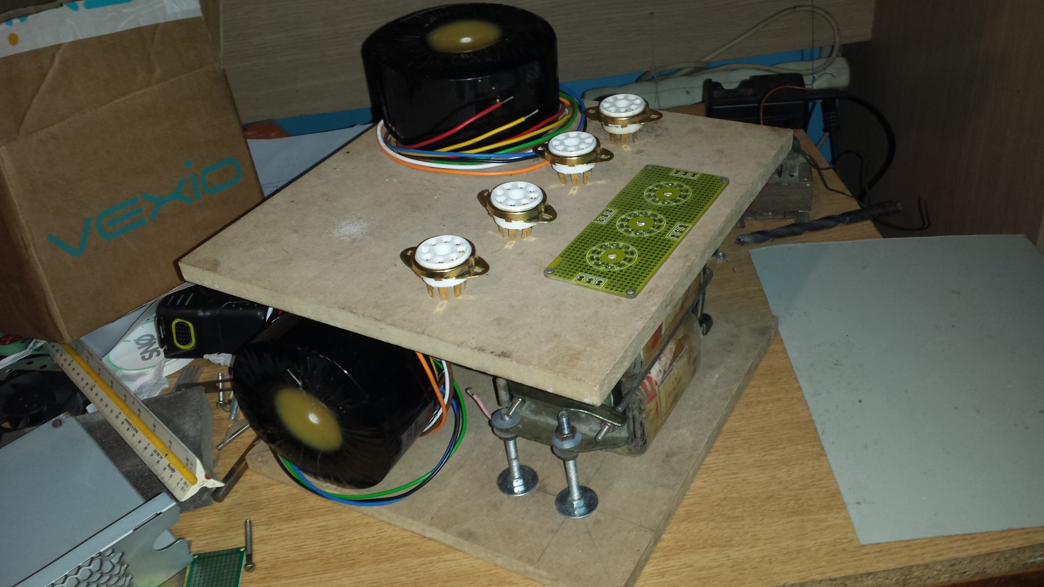

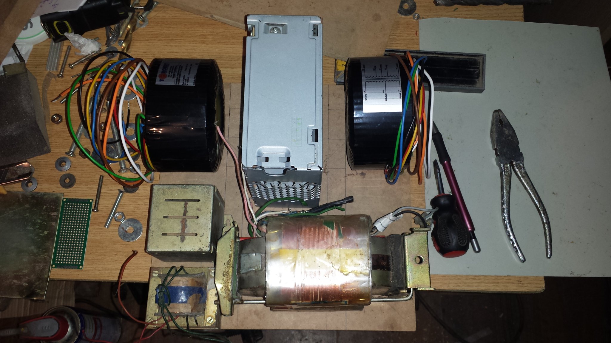

This are the transformers sockets and pcb's trying to make a layout...I'll be using the small yellow pcb for now...the green one is nicer but I have chassis mount sockets and I will not buy other components until I build something, later I will replace/make another pcb...I have boxes of components for all sorts of projects sitting just like this one...because..well "I need other pcb mount tube sockets...or I need to buy something"

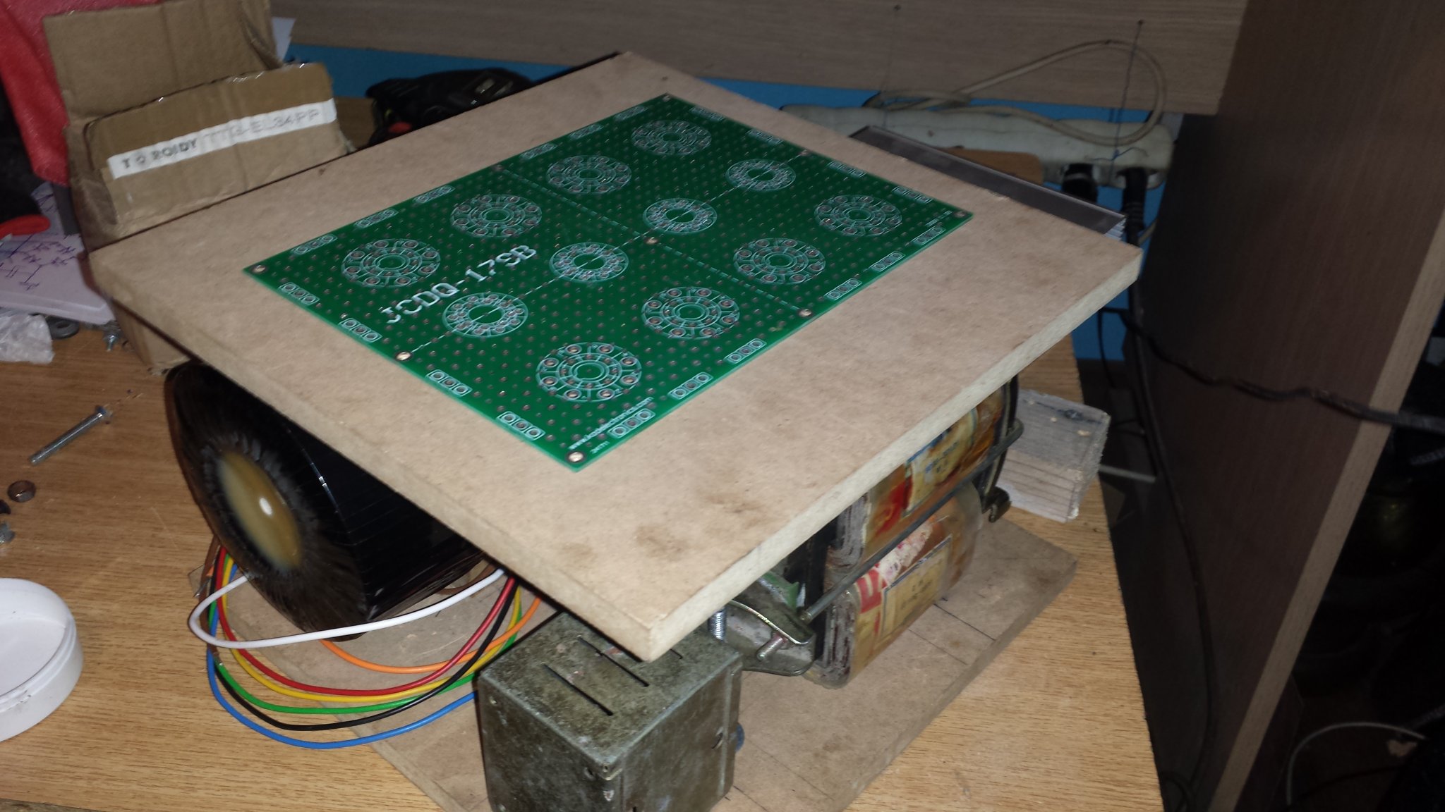

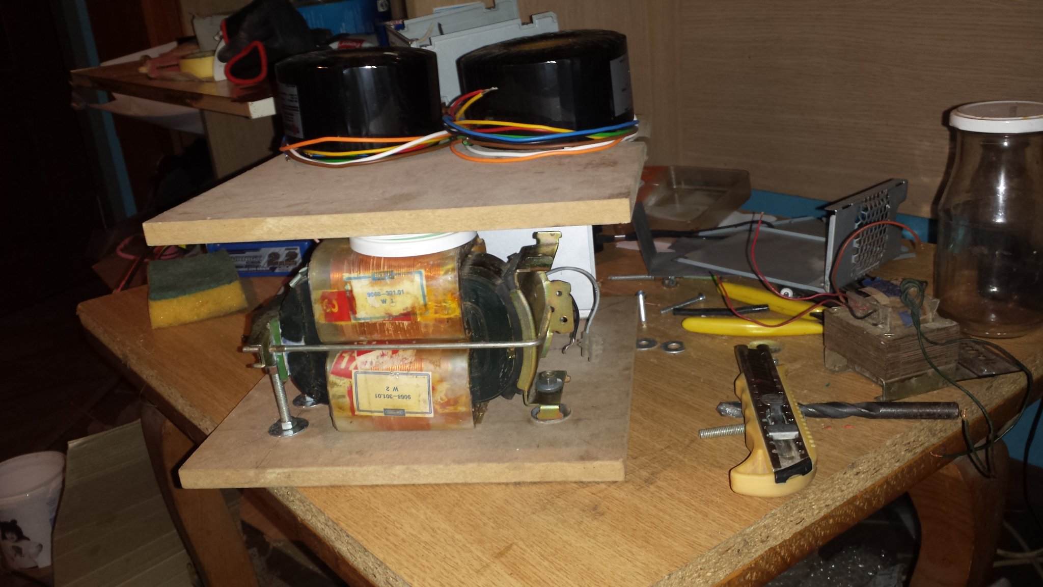

I had these two square MDF plates 25x25cm...they were for something else but I will use them for the current iteration of the chassis.
I have another unfinished 12 year project just like this one...a nice CNC machine 99% all components sitting there unmounted...I guess It's about time for that too 😀 ...as soon as it will be done and I figure out LinuxCNC I will make a proper enclosure for the amp....maybe put an SMPS supply instead of that bulky transformer, I saw some SMPS PS's on aliexpress I don't know how good they are but there is one that looks promising.

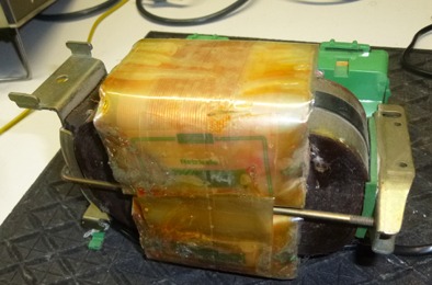

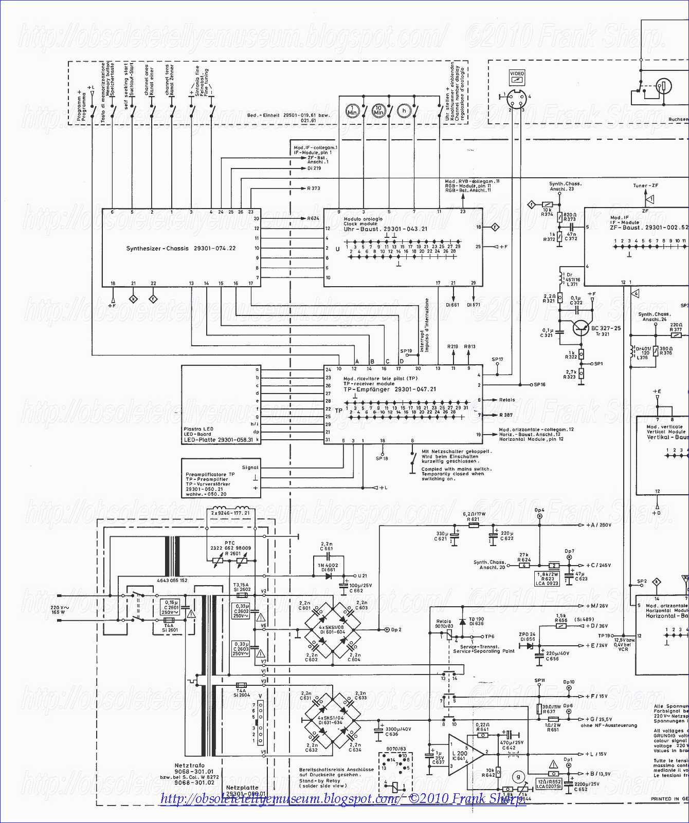

The transformer is 220v in 220v out and another two 10v windings so I will use a voltage doubling rectifier and I also plan to regulate the filaments supply and bias of course. For the bias supply I have another small transformer about 60vac

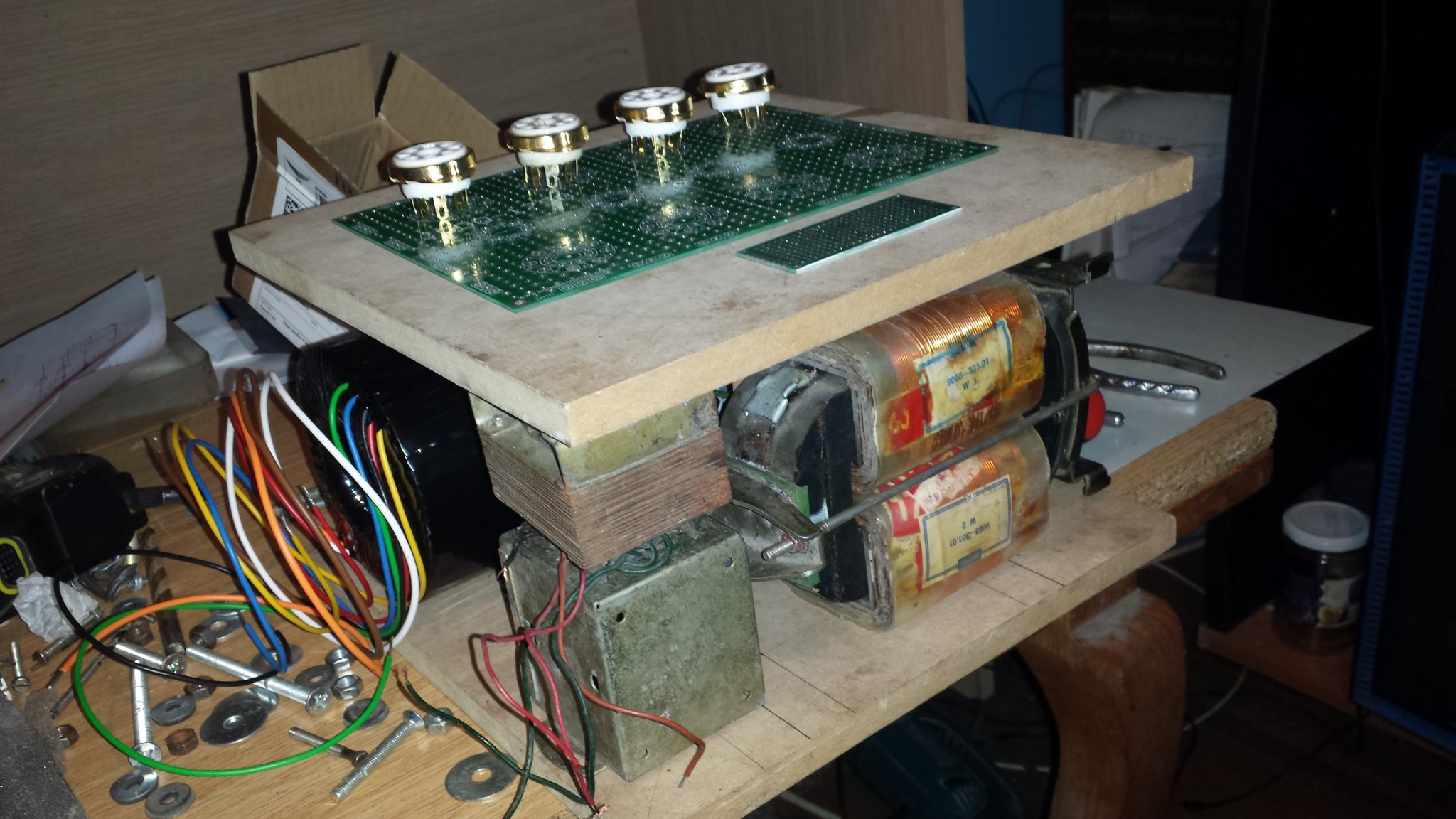

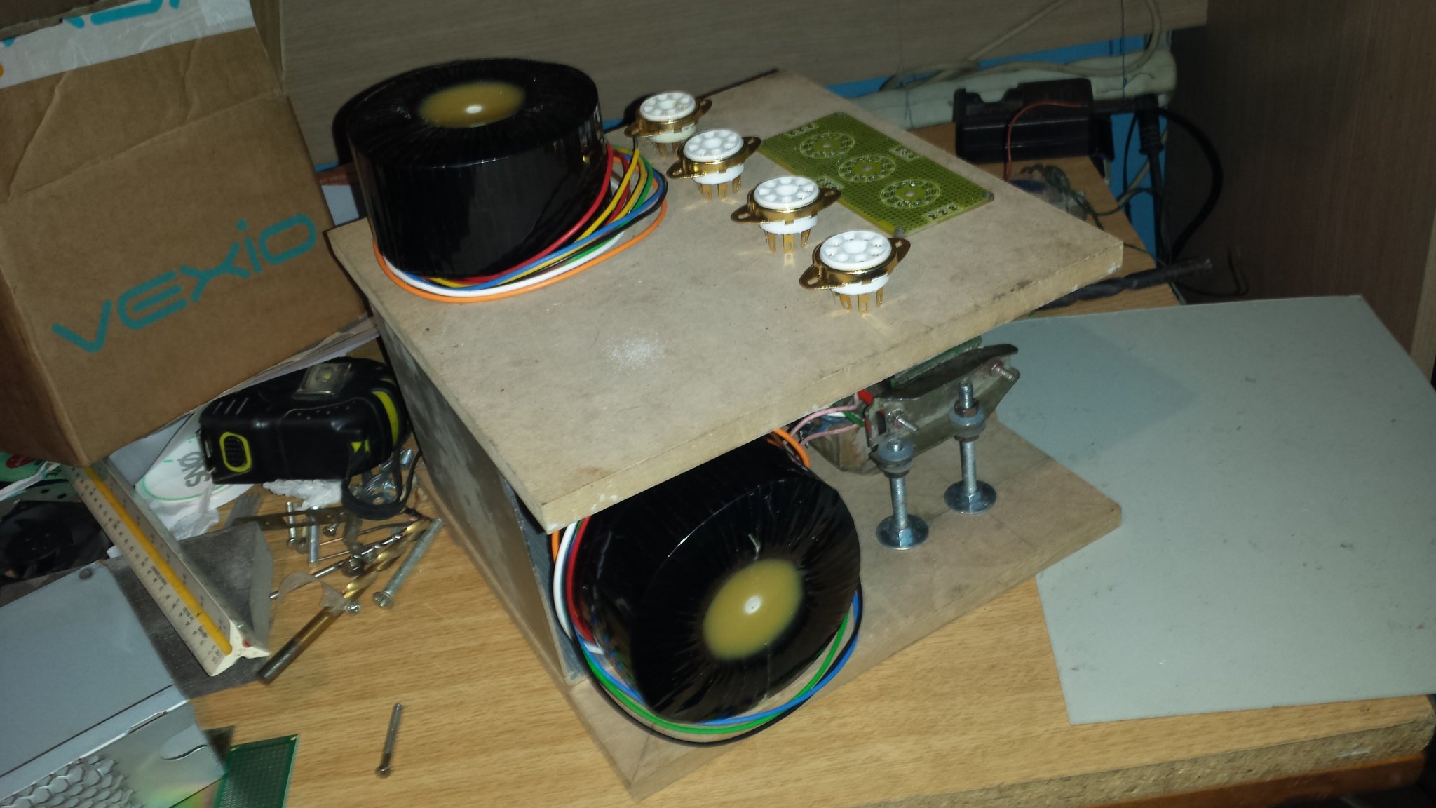

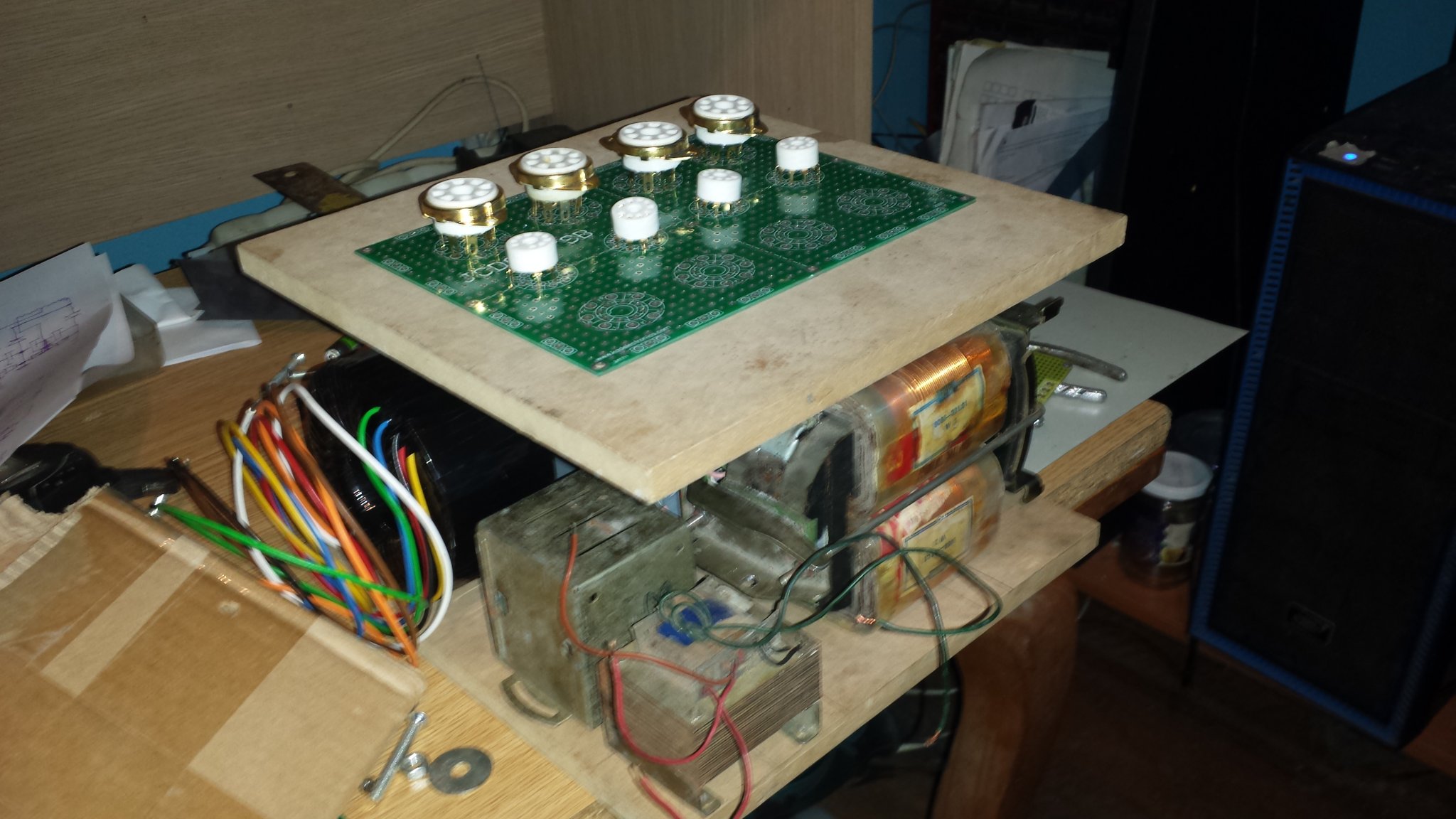

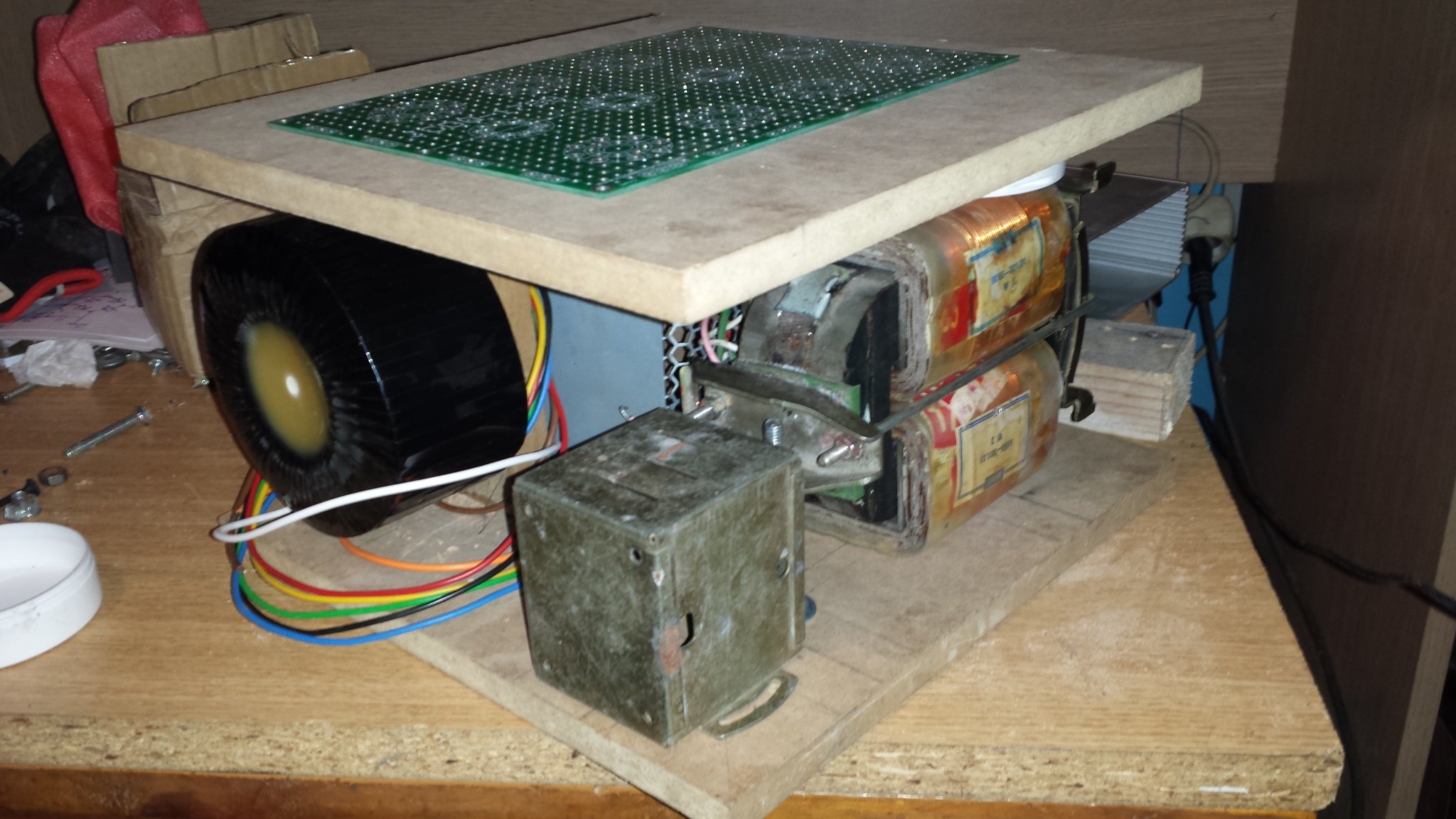

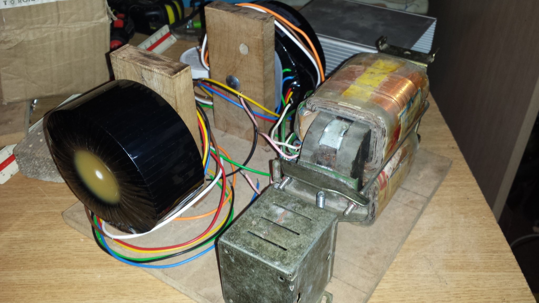

I pondered a little about the chassis and transformers placing after I first mounted the power transformer...first plan was to put the power transformer in the front below and the output transformer on the top plate in the back to put as much distance as possible between them, but the space for tubes was getting tight and there was a lot of unused space below the top plate, so I moved all transformers in what will be the amplifier body, with all the tubes sitting on top

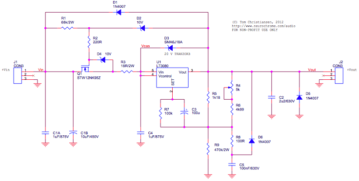

Regarding the power supply I have an LT3080 for a regulator I found here on diyaudio "the 21st century maida regulator" a floating regulator design...that's what I'm planning to use. I gutted a SFX PC power supply to house the high voltage components. I am kind of "afraid" of going unregulated...I have read some here and there about proper wiring and grounding needed with a "classic" tube amp design with non regulated power supply and I don't want to have to deal with all that. Also I will have about 610V after rectification with a voltage doubler and I have to drop that to below 500V...from what I've been reading about this tubes they can take 500V and maybe above
So regarding the bias supply..if the B+ is regulated than the bias should be regulated too. I have read some things about leaving the bias unregulated but that was for unregulated B+...so from what I understood either you regulate all supplies or leave all unregulated.

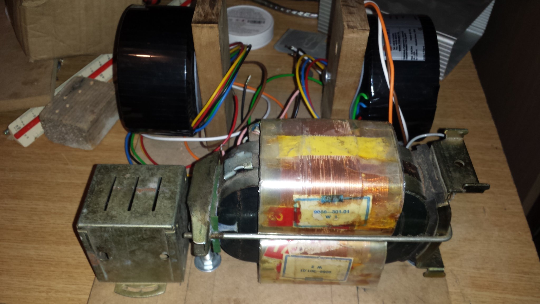

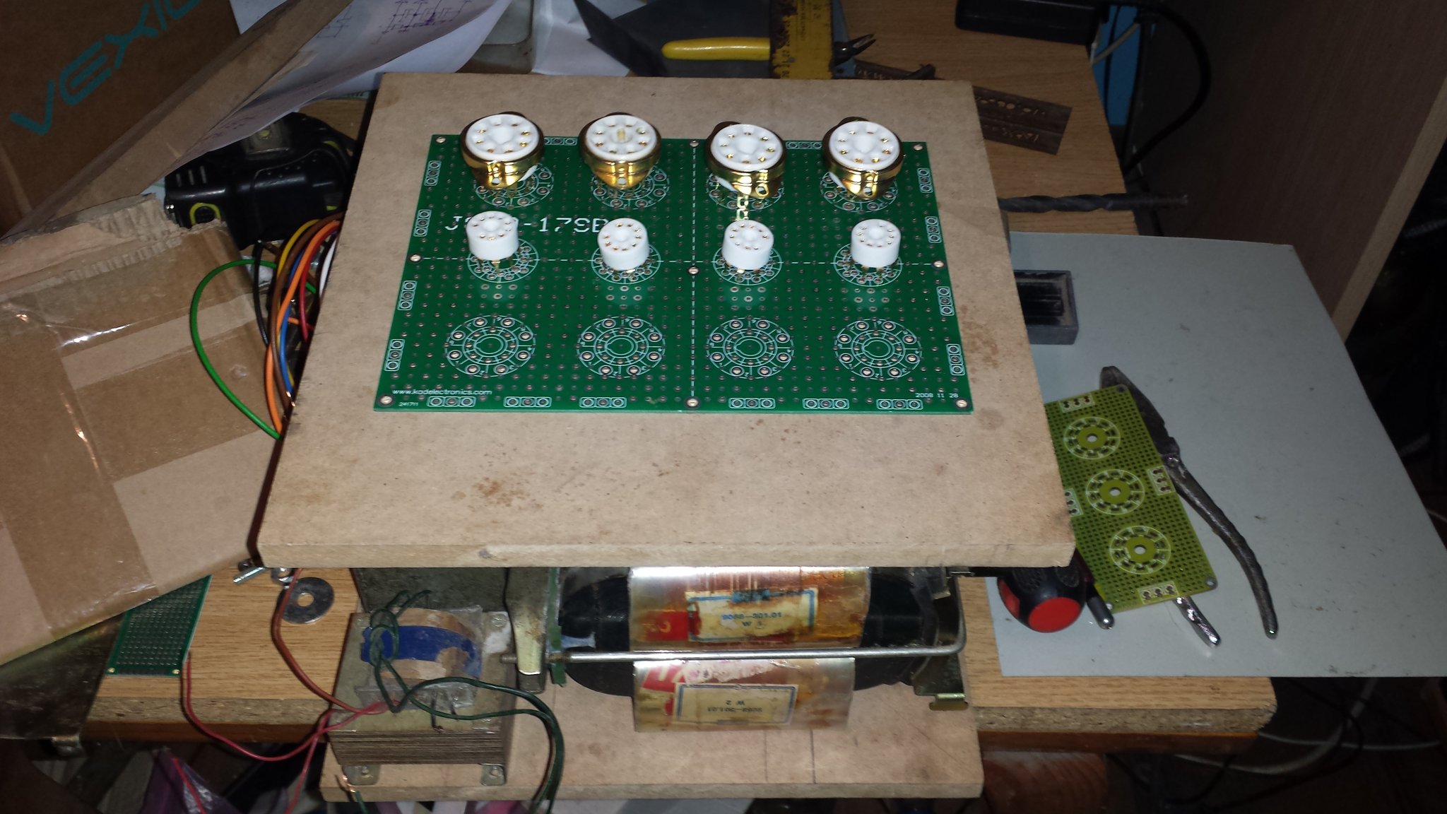

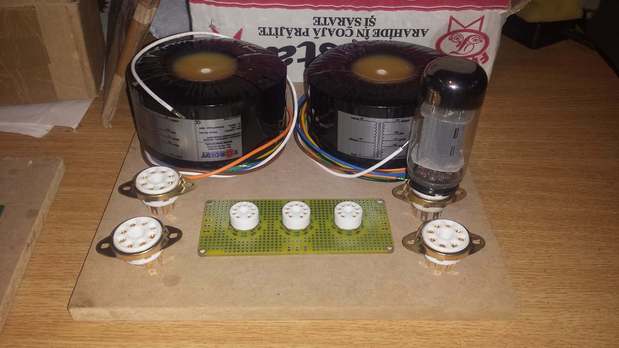

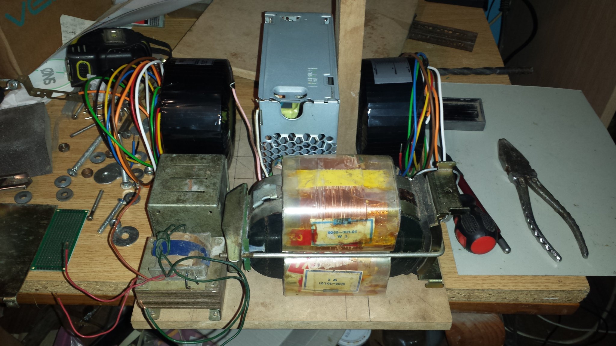

This is how I have set up the transformers, OT's are the 6.6k "EL34PP" ones from Toroidy, and in the front placed all power supply transformers...there will be 3 like in the in the last picture: the big one for B+ and filaments and the two small ones one has the 60vac for bias ant the other has two 20v windings suspended from the top plate...this will be used for a dual voltage supply, I plan to experiment with using an opamp for the forst stage/phase splitter, I have an OPA4228 and I have read some good things about using opamps for phase splitter/frst stage.
How I'm thinking about this amp...make it a sort of "testbed amp" with adjustable supply, and in the end with that green prototype pcb that has 8 octal sockets and 4 noval and some other small type in between...4 of the octals are for the power tubes, the small sokets for pre valves and the other 4 octal are also for "pre" tubes like 6SL7 wich I also read good things about their sound....or the the russian version. But in the first iteration I will mount the sockets I have directly on the top plate with spacers and use the small 3 noval sockets PCB. That's because my octal sockets are chassis mount...I will get PCB sockets later. I kind of want to leave it "open ended" I see many interesting configurations...maybe I want to see what is the difference in how they sound...

Having all voltages regulated is a good option too, of course. Please consider that the classic LM317 has better PSRR than the LT3080. There are also several designs based on Maida type regulator with the 317 chip, including an example in their datasheet.
Mircea
Yes but I already have the LT3080. I have a habit of ordering components for all sorts of projects..then leaving them unused. Like lots of 100uF 400v caps...they were for a welding inverter/high current source...I was crazy enough to plan such a thing...research it...order 120 euro worth of components...actually it's a good thing I didn't build it I'm sure it saved myself lots of time and frustrations. So now I will make use of what I have.

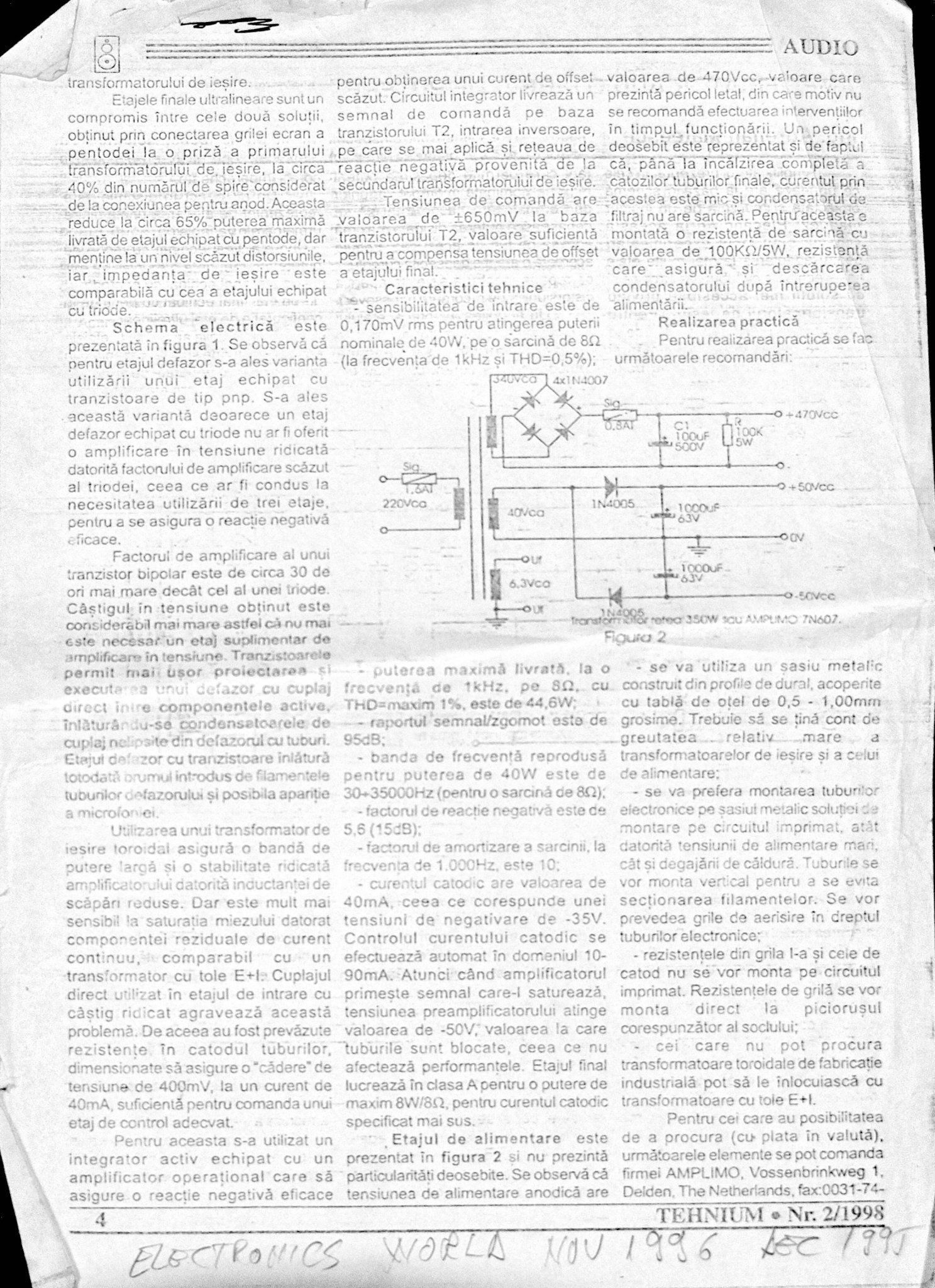

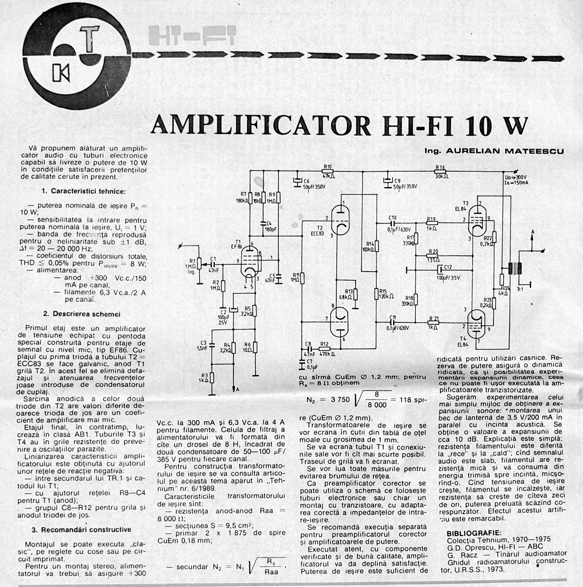

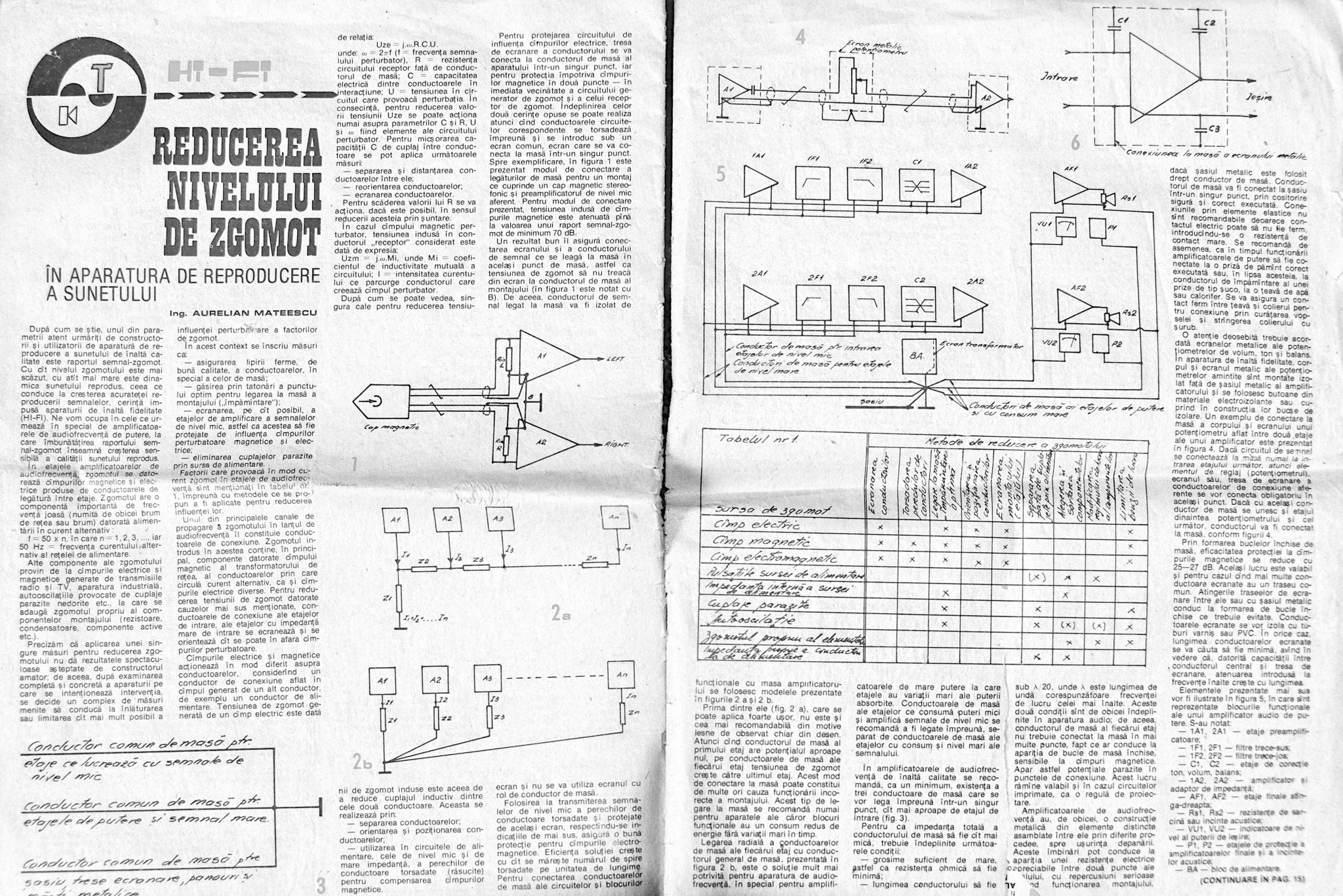

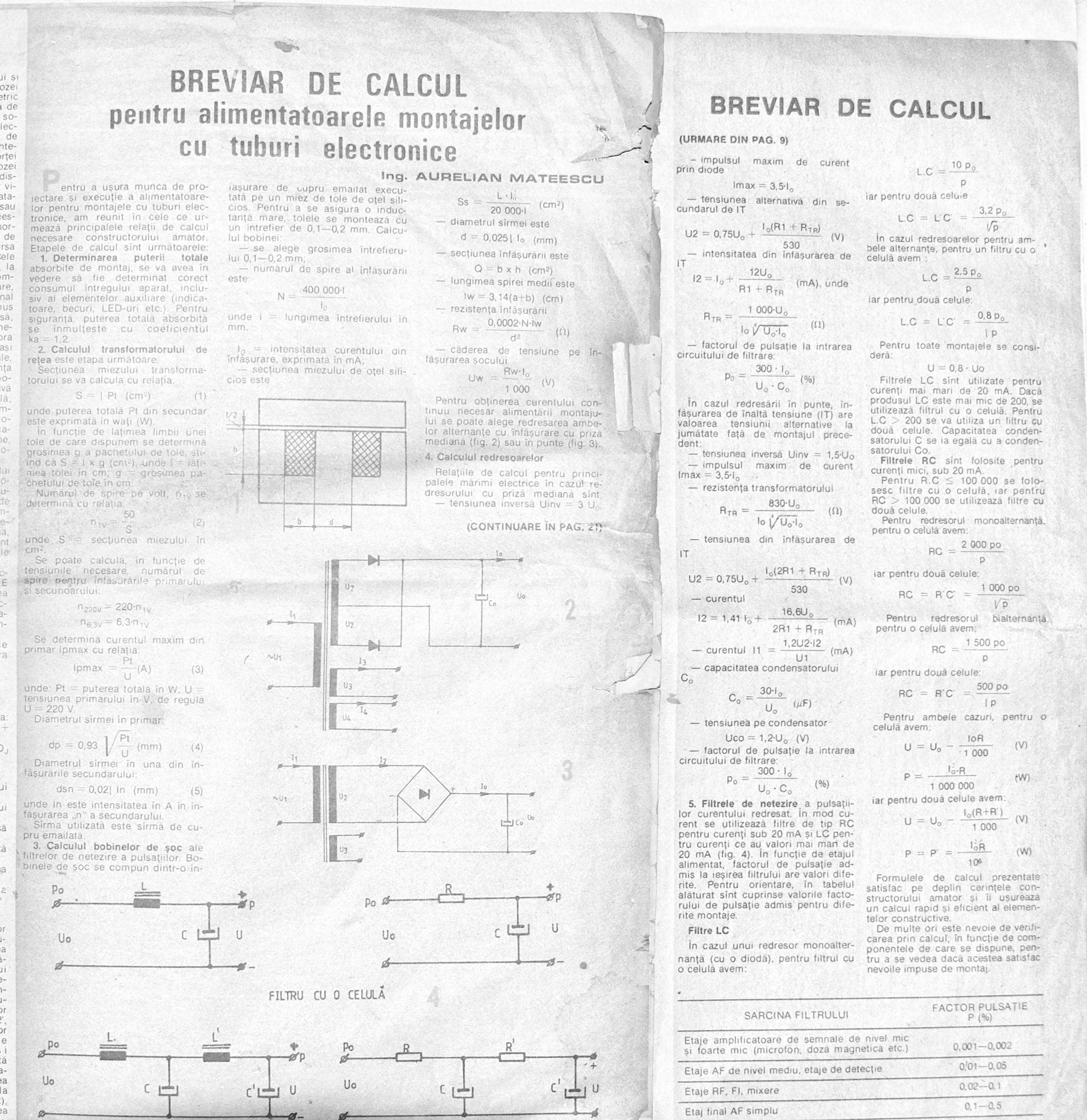

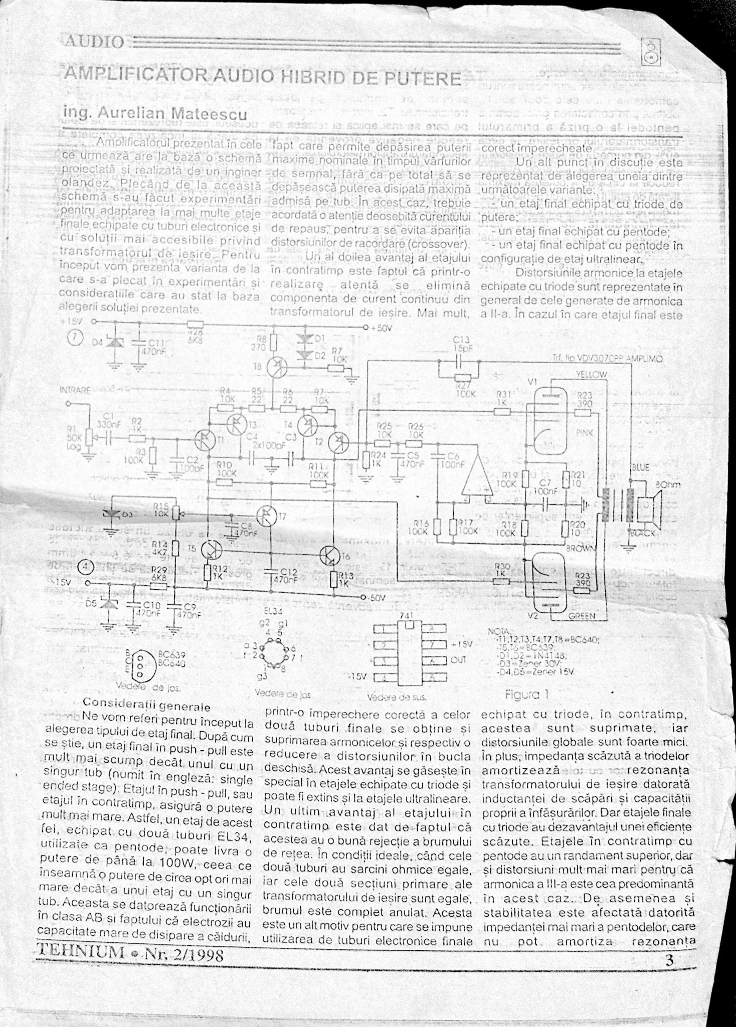

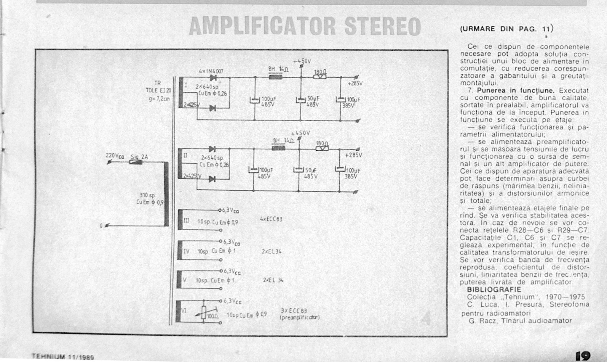

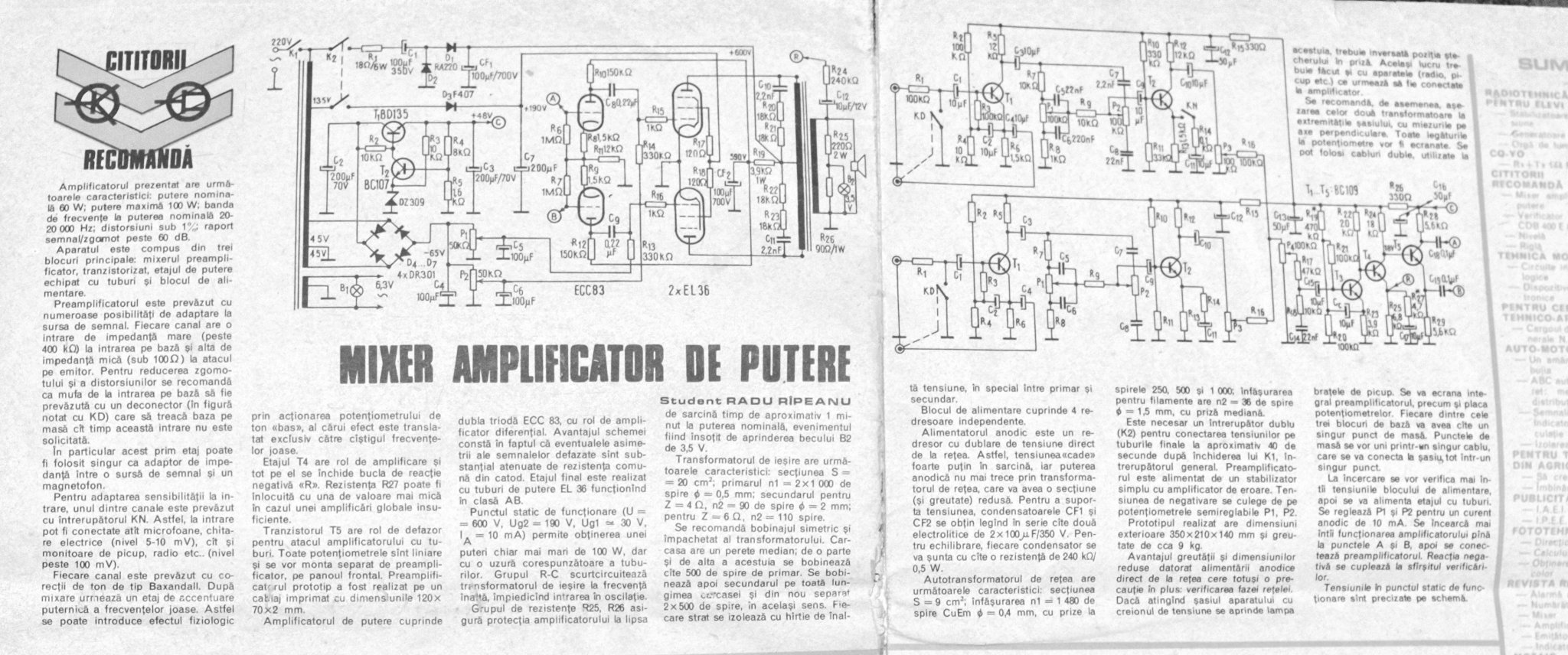

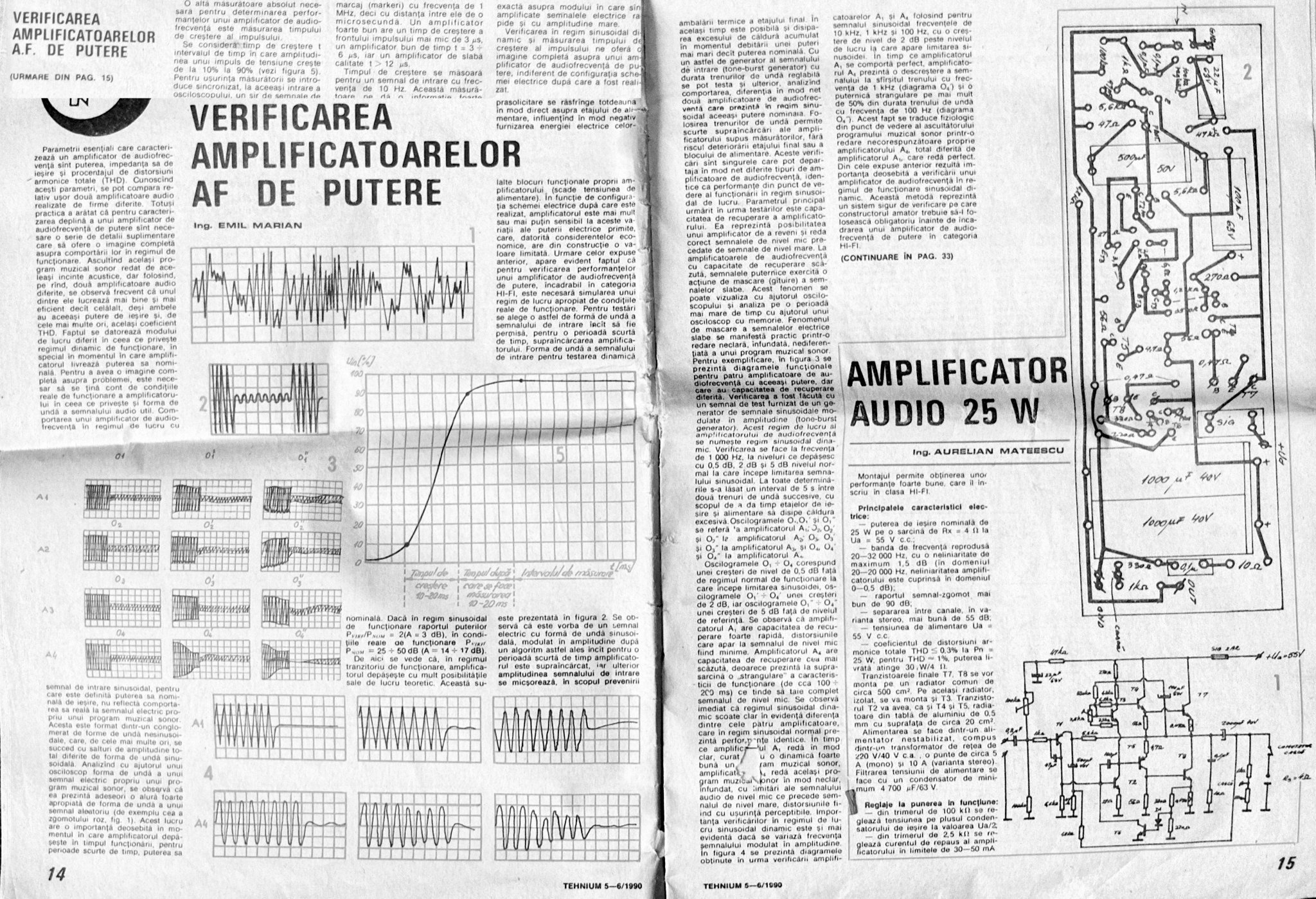

I took some pictures of the old schematics and articles about amplifiers, grounding, noise, power supply...these ones not so old actually some were published in the 90's by an engineer that was publishing really interesting schematics at the time..some higher performance ones. They are in Romanian ...so only useful for those who understand them. The hybrid amplifier was catching my attention at the time.

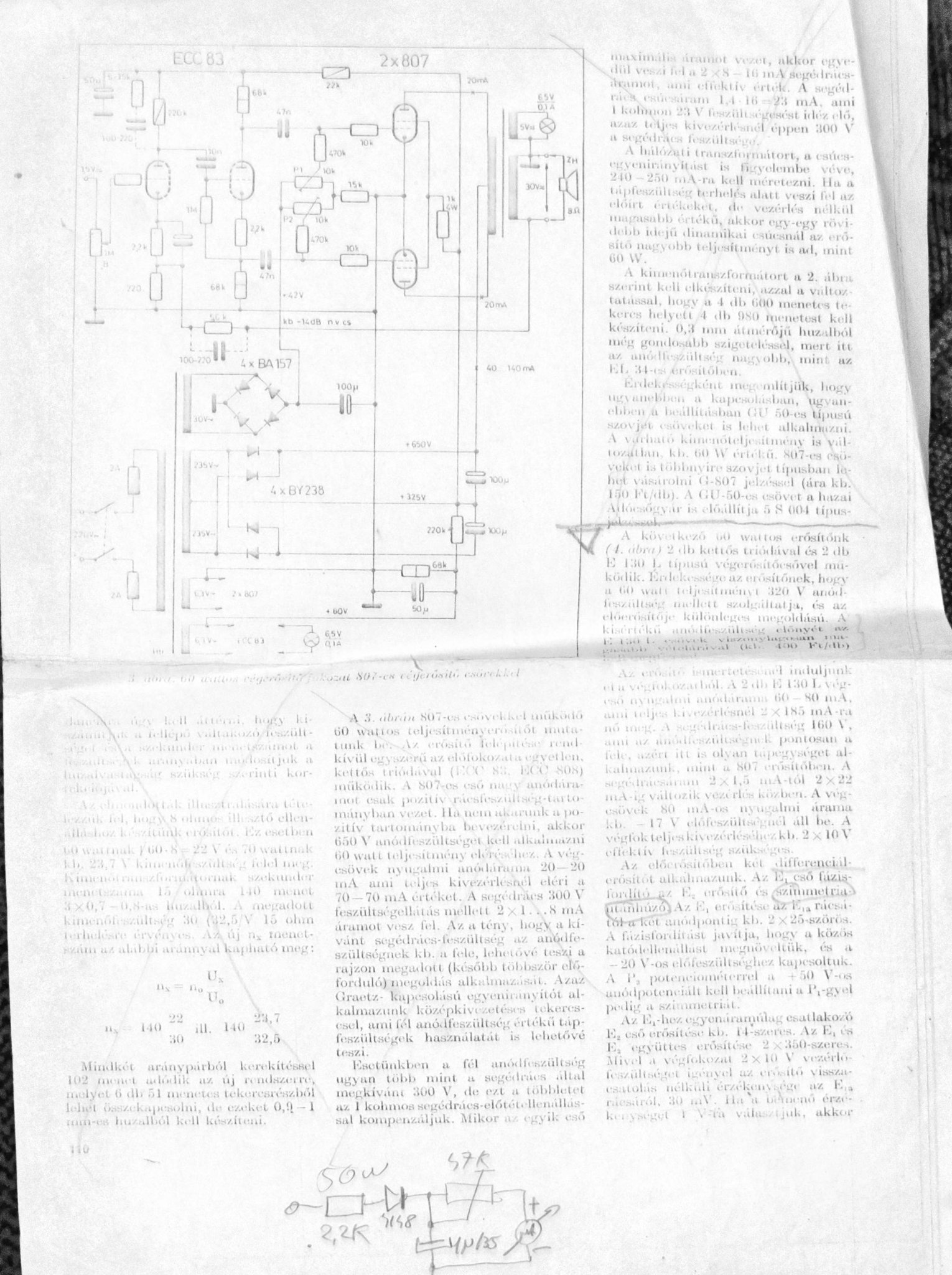

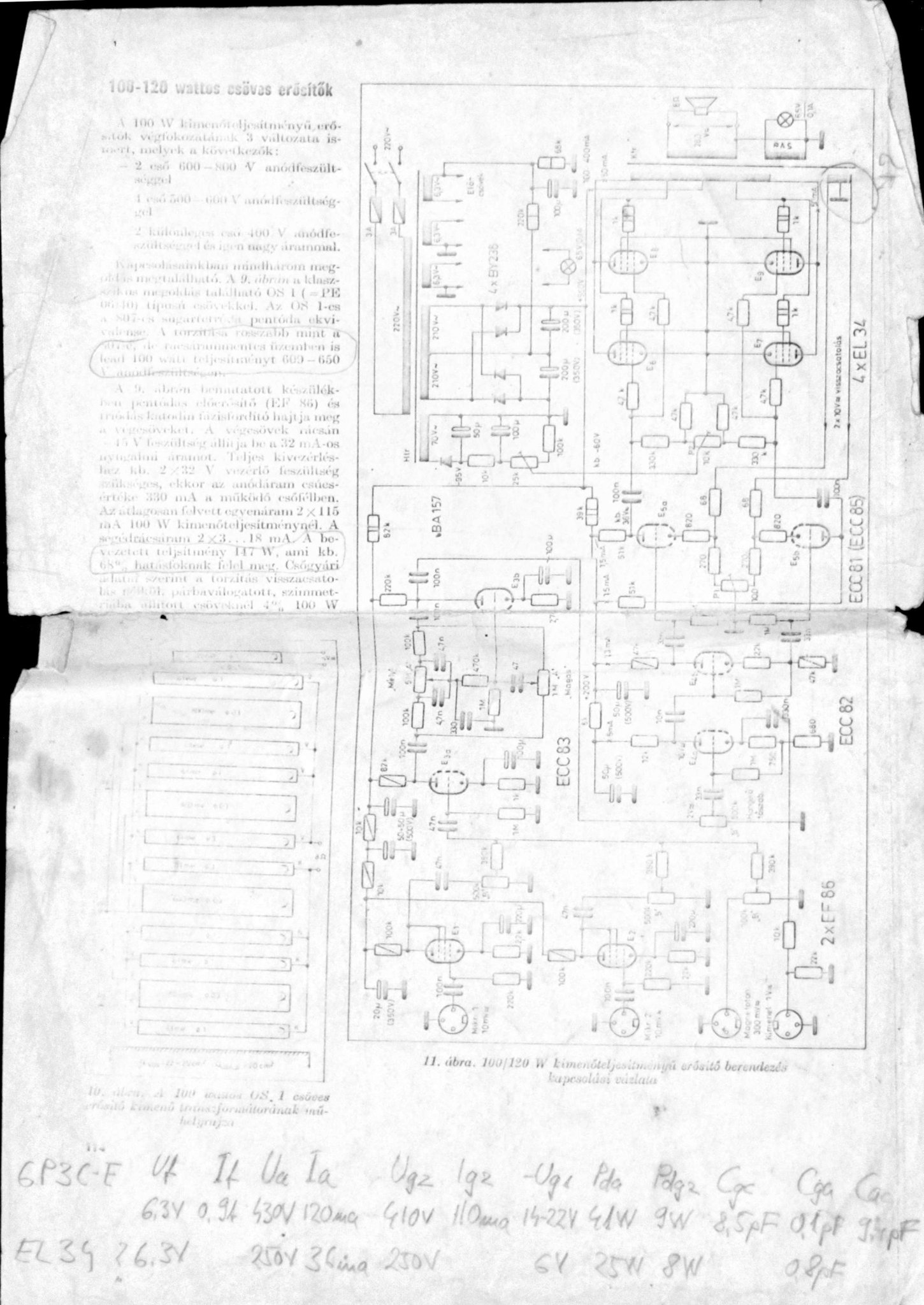

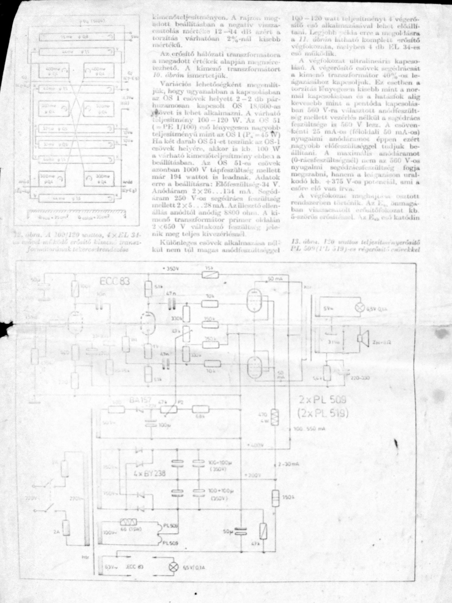

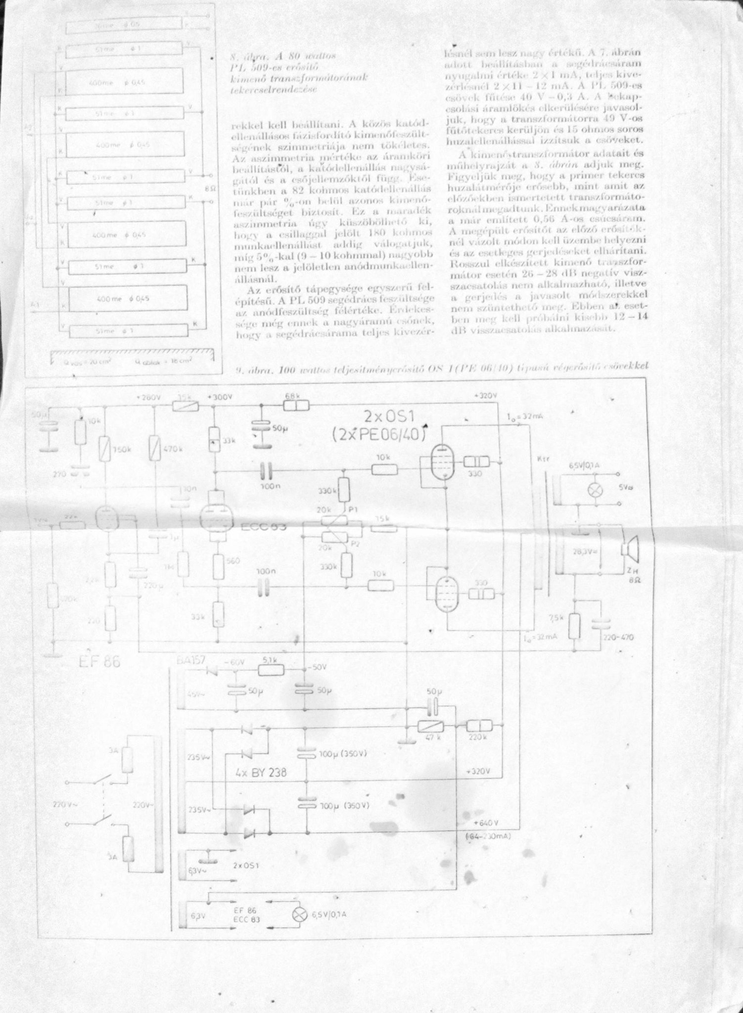

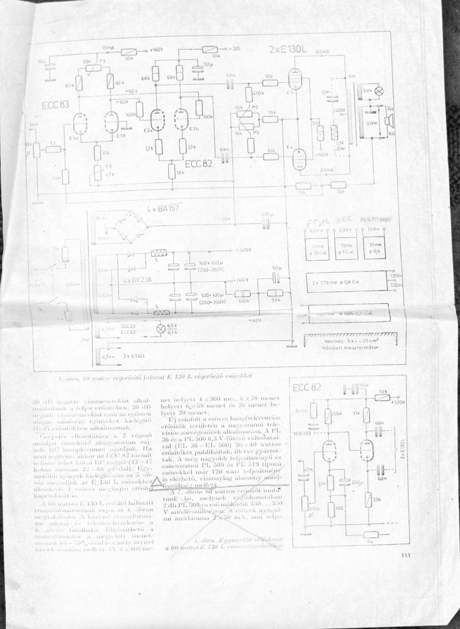

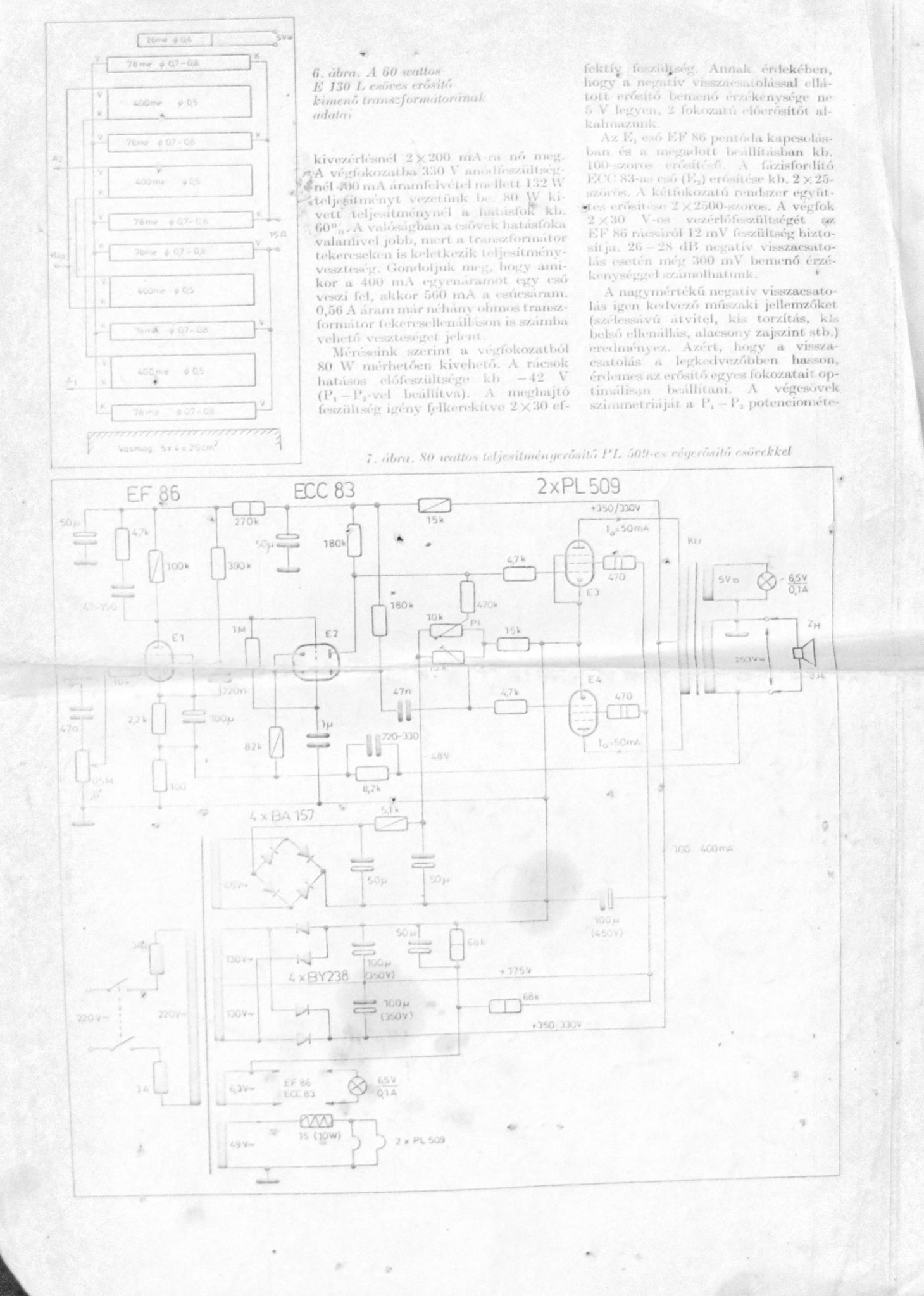

And here are some Hungarian schematics I scored at the time. Again...only useful for those who understand them. There are some interesting things there...from looking at the schematics... I don't understand the language so the order may be wrong. The original paper is a very pale xerox copy...if anyone is interested maybe I could try taking better pictures
I don't really plan to use these schematics...just posting them. I'm sorry I don't understand the text I'm sure the articles are informative..

There are some "specs" there on the first "Hungarian Amp" hand written for 6P3C-E I don't know where I got those..seem totally wrong I remember I was not finding the tube in any catalog I could lay my hands on...so I noted that...probably another tube.. I don't remember where from...it's so good we have the internet today 😀
