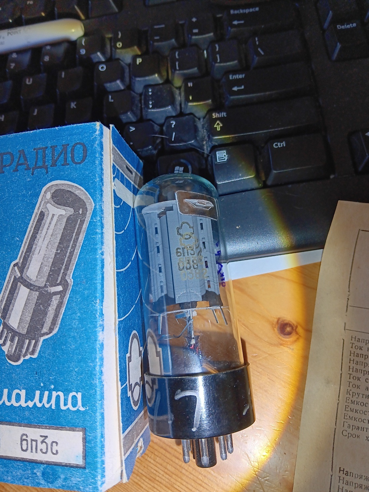

I have a set of new 6Π3C tubes (not 6Π3C-E mind you). I gather they are 6L6GA ish. Do you think I could substitute these at that plate and screen potential without shorting them? I have some 680R cathode resistors to dial down the current some.
Any local knowledge regarding these 6Π3C tubes would be appreciated.

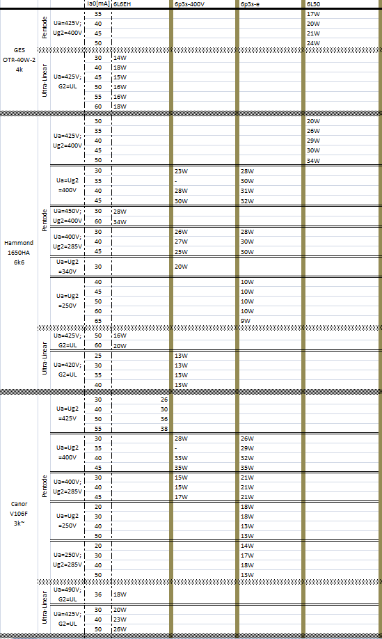

The 6N3 is a standard version, though maybe lightweight, of a 6L6GT.
Voltages are not the problem, the thickness of the anode plus overall area and the cathode coating is the difference along with the smaller glass bottle.
The anode dissipation is around 19W whereas the GC dissipated up to 28W.
Perfectly serviceable for replacements if peak power is not required; 6L6 pair = 45W and 6L6GC 65W, in push pull as a pair.
The anode impedance is the same as is the bias voltage. They will work quite happily up to 700 volts on the anodes, as the GC and 5881 do.

And Yeah, we’re talking about the 6p3s. It’s not the coined based -E version.

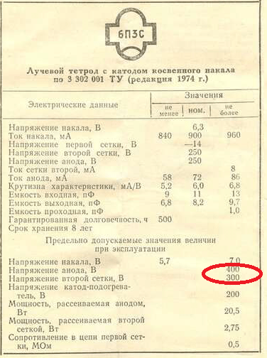

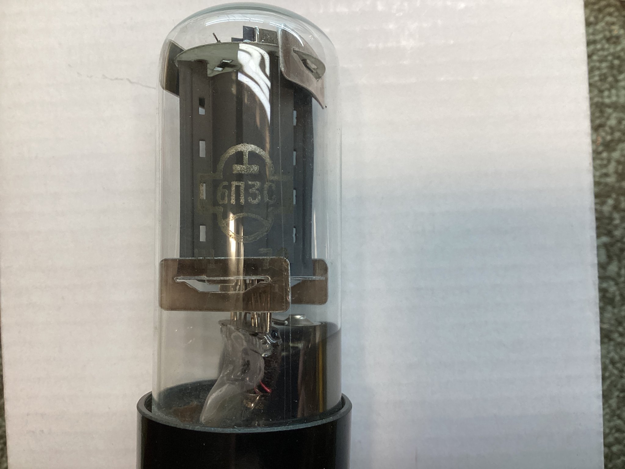

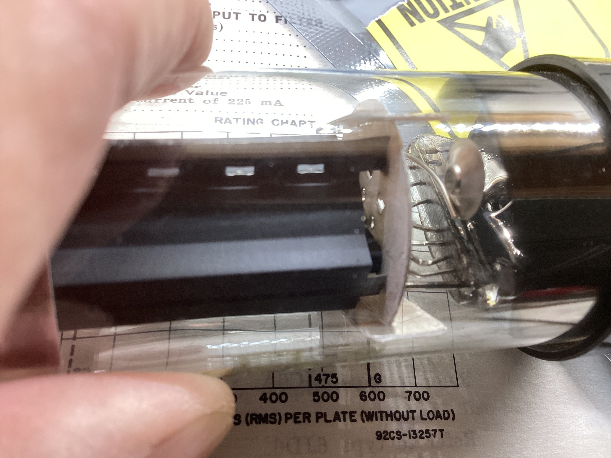

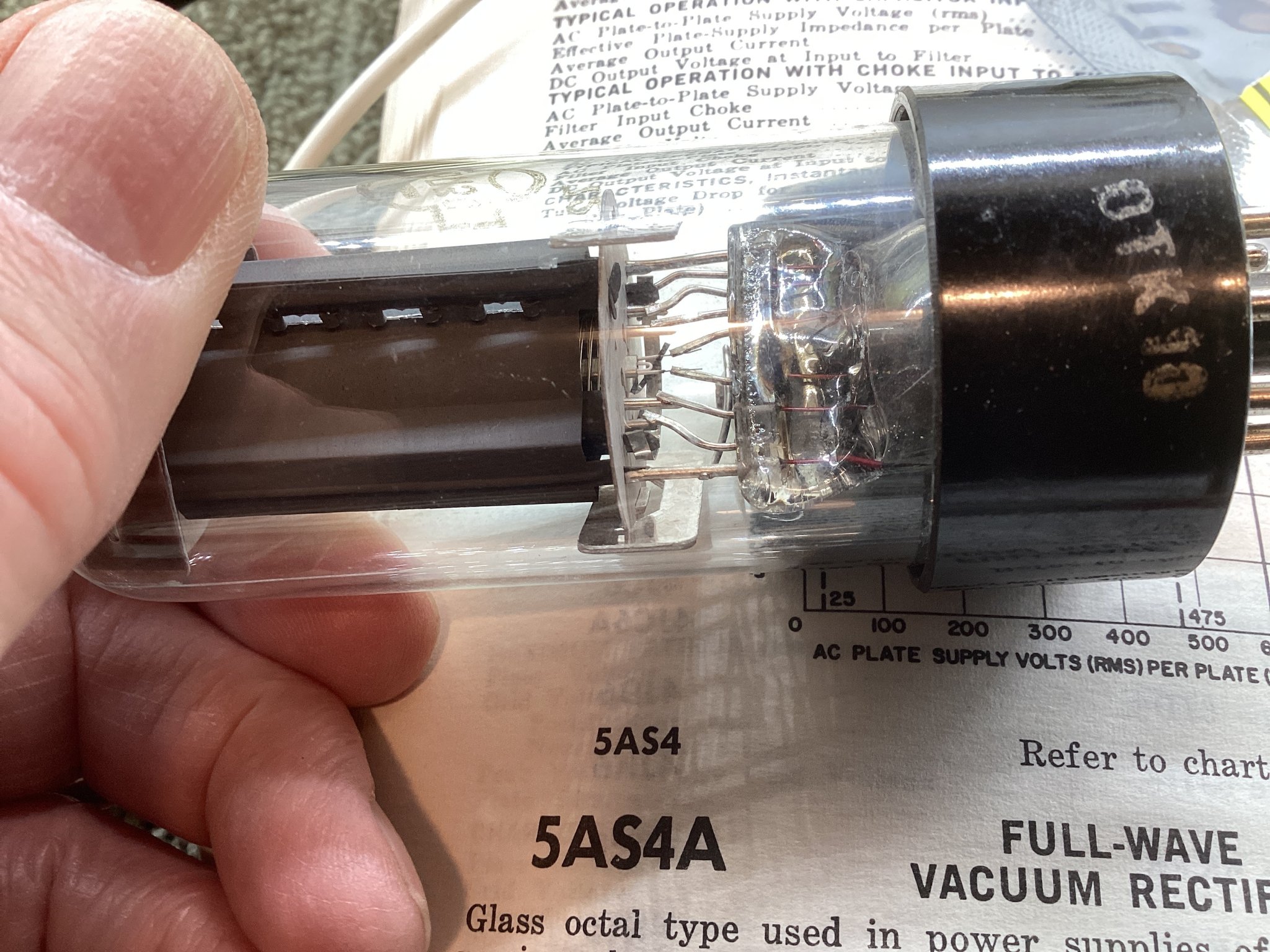

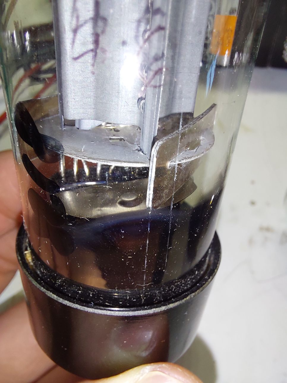

The Russian 6p3s-e has a thin coin sized base and the standard non e has a thick base. The standard is like a 6L6 and the e is like a 5881. You can use the e version in place of the 7591 if it is not being drive too hard at too high of a voltage. They are good sounding tubes especially if they are from the 70s or 80s OTK stamped units.

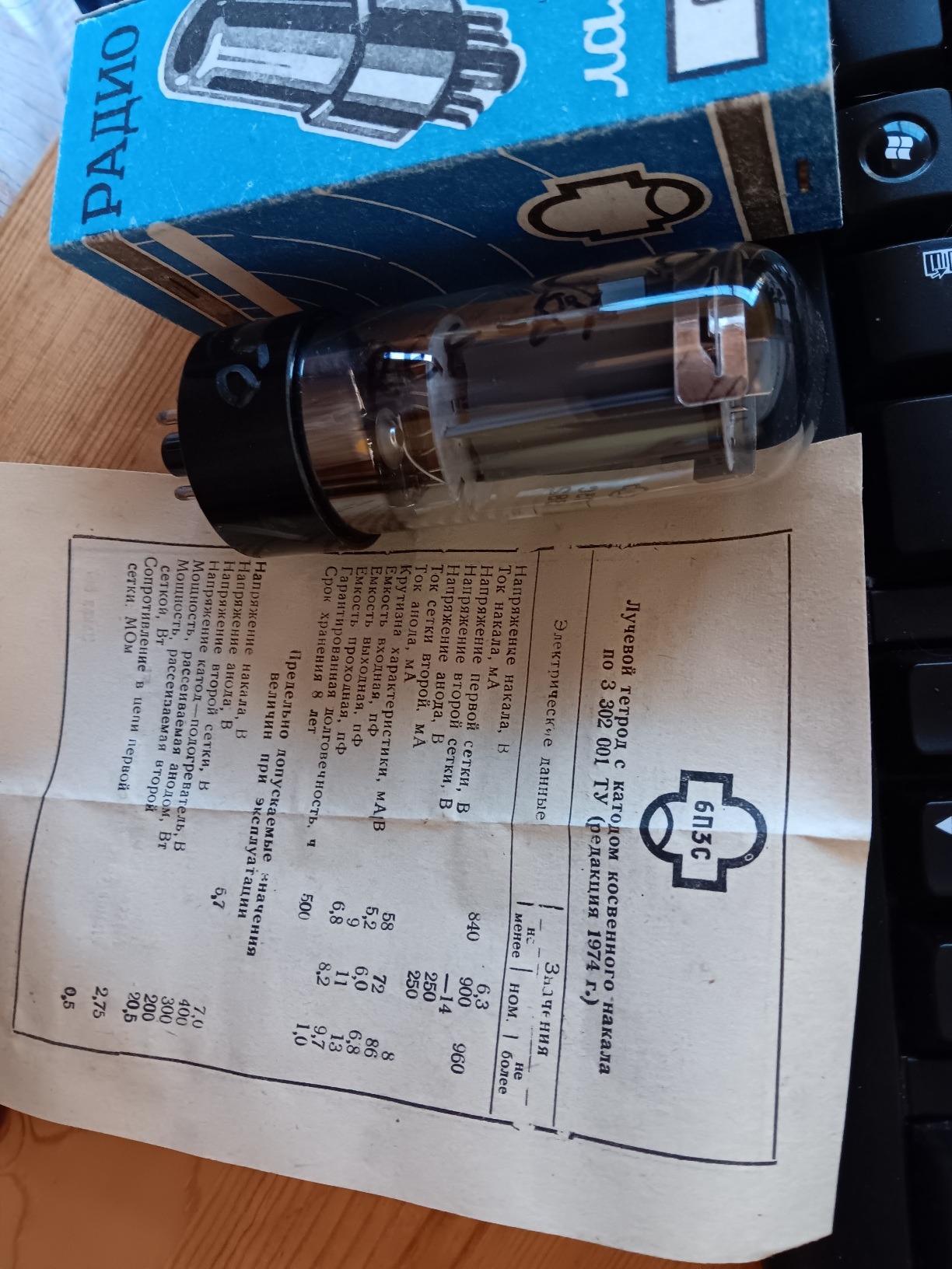

In addition to the Radio Museum link grataku offered, here’s a LINK to the datasheet from Frank Philipse. I can‘t be sure of the actual translation, but I see 250 as a grid 2 spec. The plate might be that low too.
So there’s perhaps only one way to find out. Today I adjusted the screen regulator down to 250v, left the plate at 500 and let it run with a bypassed 680R resistor. The cathode runs at about 22 volts. Plate and screen dissipation should be about 15.6 watts. I don’t see any signs of distress yet and the wave forms look no different than the 6L6GC on the scope under load. If they survive for a few hours I’ll give it a listen.
From the Russian datasheet:
Maximum anode voltage: 400V
Maximum G2 voltage: 300V.

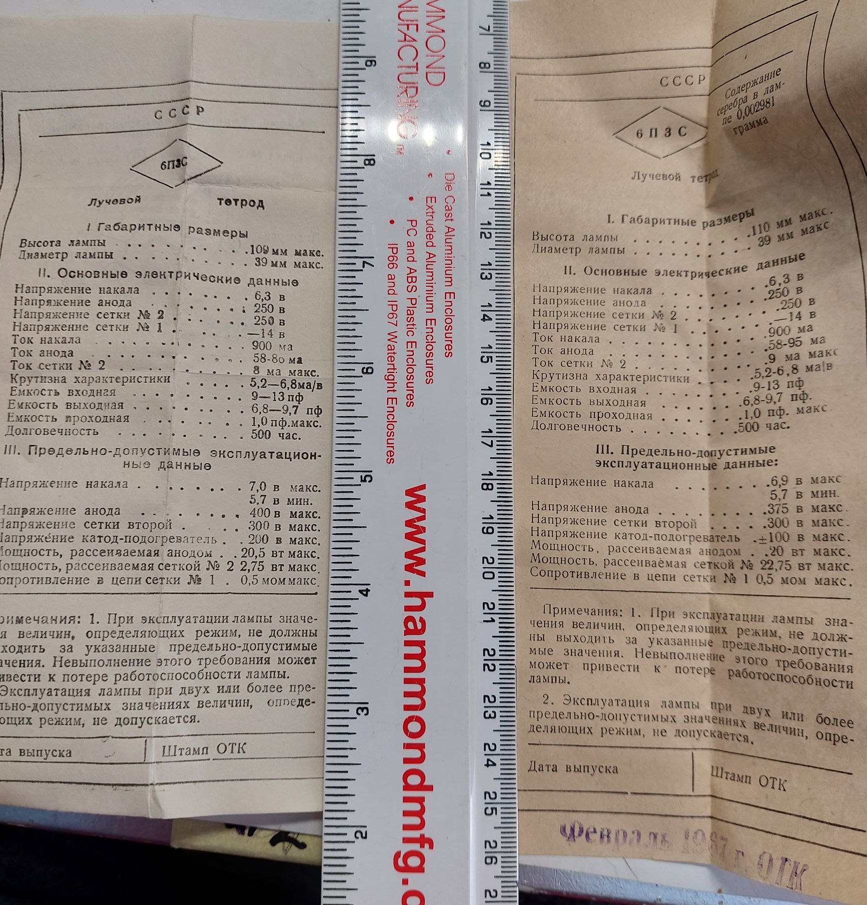

I have seen Russia data sheets setting G2 maximum of 250V and some data sheets stating G2 max is 300V. Keeping in mind it was common practice in tube data sheets long ago to specify the maximum voltage allowing for normal 10% line voltage variation it seems reasonable to push the screen some using a regulated supply. Some people may differ in opinion.

6p3s are 2 version, one with Ua max = 400V and another one 375V.
That is interesting.
Makes we wonder if each soviet factory set the specification for the tubes they made of any one type.
There is a certain honesty in this. Is this why many soviet tubes were packed with a data sheet for each tube?
As we know tubes made in different western factories were not all the same yet everyone pretended the exact same data sheet applied.
Here are the operating points for a 6P3S in triode mode.
It is useful for picking a bias level for any one screen voltage as the plate current does not vary a lot with moderate variation on plate voltage.
So pick the screen voltage you plan to use and them look for a grid voltage a the chosen screen voltage that have the plate current you want.
In your case a 480 ohm cathode resistor per tube may run a bit hot at nearly 20 watts. Very close to the 20.5W rating.
