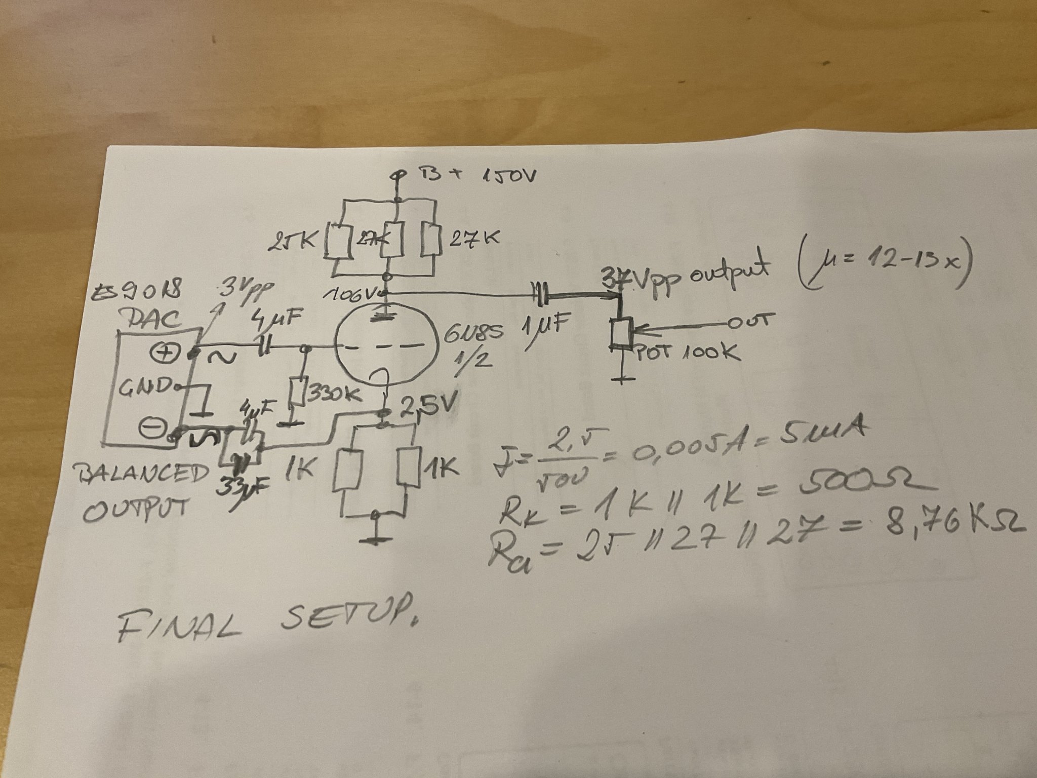

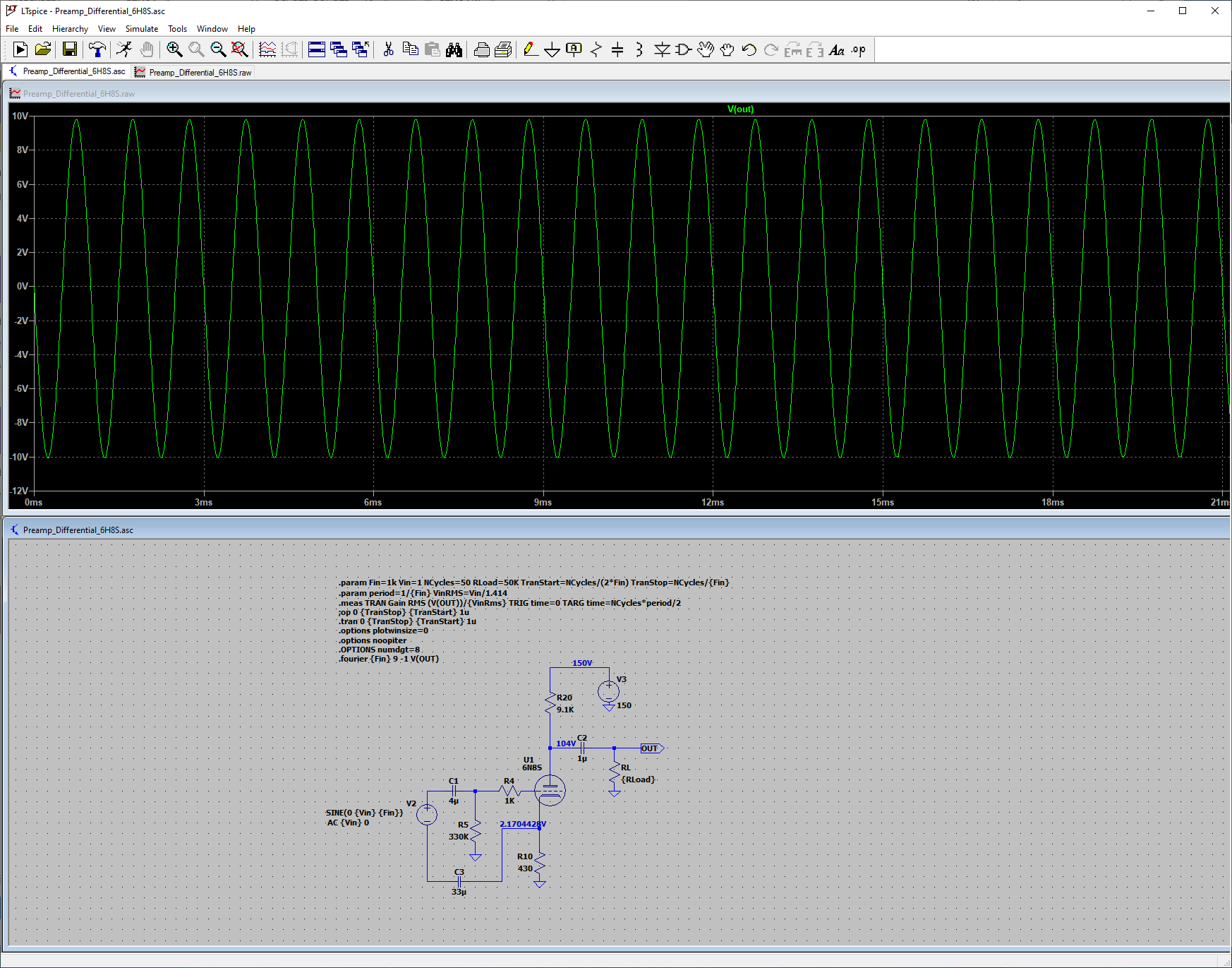

Hello,

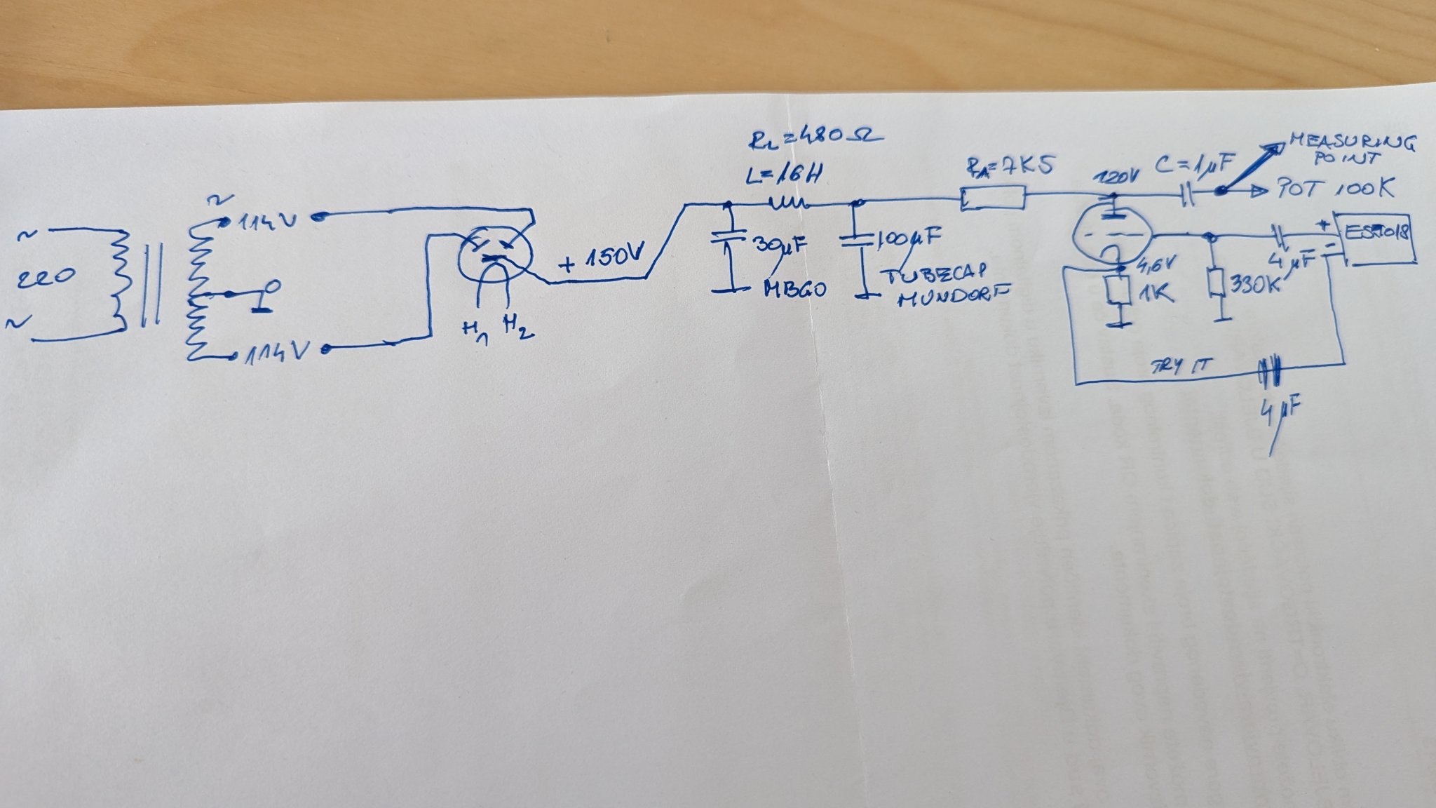

I made a DAC with a 6N8S tube output and I don't know why there is such a drop at lower frequencies? The power supply is 114-0-114 VAC through the EZ81 tube and the filter is CLC: EZ81-C30uF-L16H/480ohm-C100uF. Ra=7k5, Ua=120V, Ug=-4.6V, Rk=1K, Ia=4.6mA.
The DAC is ES9018 (voltage output 1Vrms=3Vpp) and input to the grid is via a 4uF capacitor. Without grid stopper. Output capacitor is 1uF, connected to 100K pot. I am attaching the freq. characteristic.

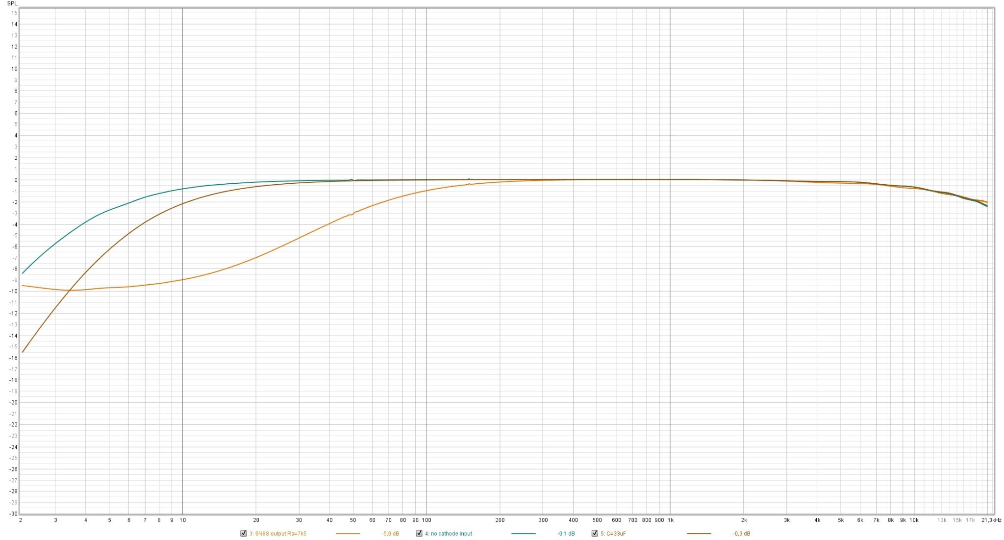

Does anyone have an idea why there is such a drop on low freq. (100Hz=-1dB, 50Hz=-3dB, 20Hz=-7dB)?
Thank you.
