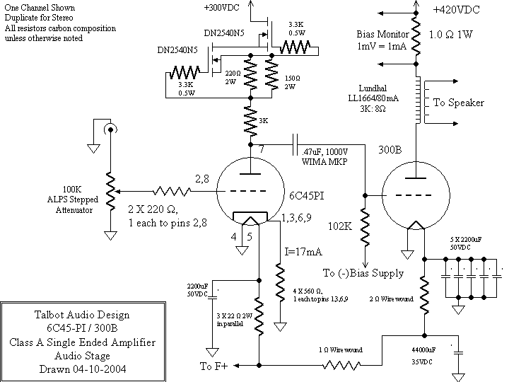

Similar Idea
Built a similar circuit using a 6C45pi as a driver tube and the results are very nice. I await my Mundorf Silver Oil caps which should arrive next week. Present coupling cap is a Wima MKP.
THe use of a CCS may be something you would like to consider as well.

What is CCS ?

CCS
A CCS is a constant current source.
There is one in my schematic connected to the plate of the 6C45PI.

I am quite pleased with the CCS that is on the schematic above.
The 6C45PI is very quiet, I would call it very open and detailed, like someone took a pillow off the front of the speakers. The only problem is 6C45PI tend to oscillate, if you use them for a gain stage be sure to tie all grid leads back through resistors and the same for the cathode leads(see schematic). I have had better luck with Reflektor 6C45PI tubes than with Sovtek 6C45PI tubes.
The best thing is for you to go for the sound you are looking for, don't be afraid to experiment. If it sounds good to you and the parts are run within thier operating parameters, then there is no need to change it. The carbon comp resistors have no magnetic conductors or end caps, which to me seems to effect sound more than what the resistor is actually made of.
Sound a bit too bright
The sound may be a bit bright because of the passive components.
I use Mundorf Silver and oil caps, and carbon comp resistors and the balance seems just right.
My driver tube is a 6N45PI with a CCS and no bypass cap on the cathode, but otherwise our circuits are very similar.
