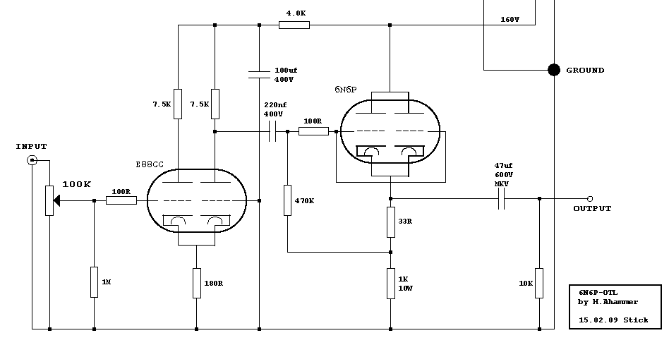

Looking for a substitute for 12B4 in this headphones amplifier the 6N6P seems a candidate. Would doubling the triodes and Va=150V, Ia+Ia=36mA be a suitable operating point? The original circuit uses a 20:1 turns ratio OPT to obtain low output impedance. Would a standard 5K:8ohm OPT do?

attached schematic based on the "low voltage amplifier" using E288CC by H. Ahammer. He confirmed that substituting 6N6P should be doable...
It is OTL though :-(
