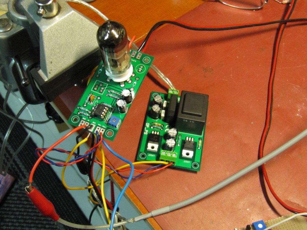

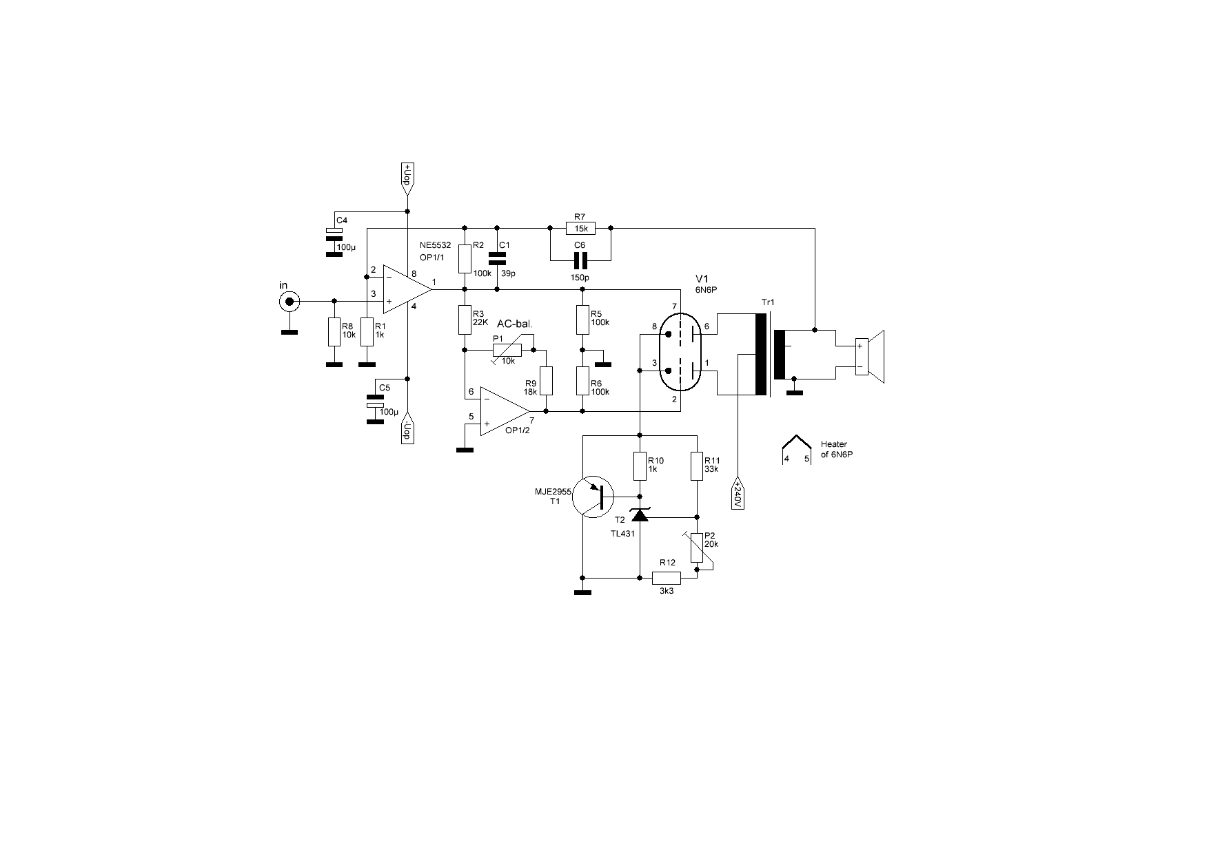

I have not tested 6N6P with A2 drive as SE, but built an AB2 amplifier. Normal AB1 gives some 3 W,
AB2 8 W with a single 6N6P. Attached a schematic and photo of that amplifier.
That's very useful and interesting, thank you! Was that 8W peak or avg? That's a lot for just one 8W (4+4) bottle. What was the quiescent current and OPT impedance?I once measured 6N6P and 6N6P-I with grid current up to +5 V. Attached the test data.

Was that 8W peak or avg? ... What was the quiescent current and OPT impedance?
- Average power
- 35 mA total
- 10k
Attached my test memo. Just ask if all not clear with that document.
That's very useful, thank you!
- Average power
- 35 mA total
- 10k
