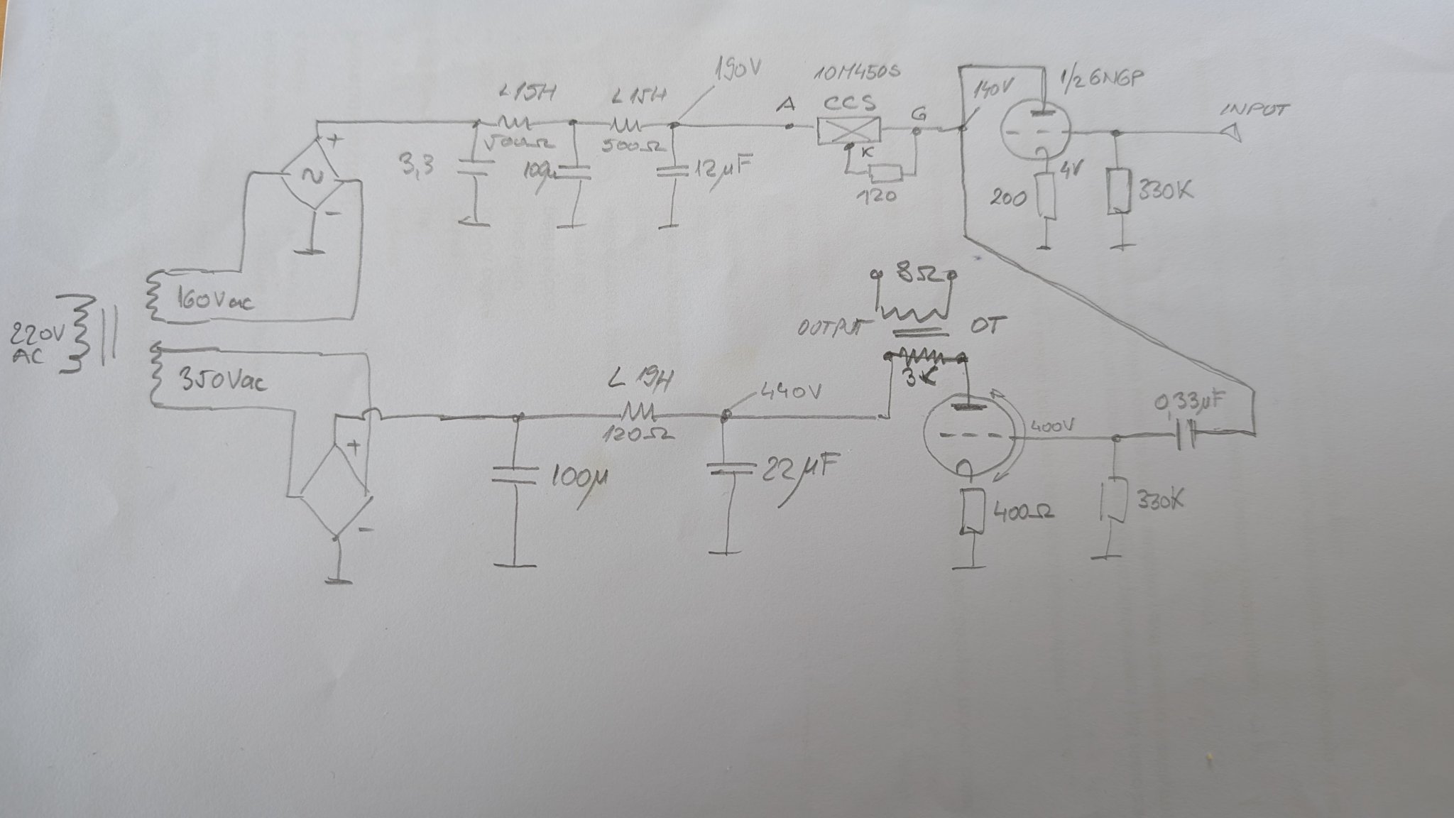

Hello,

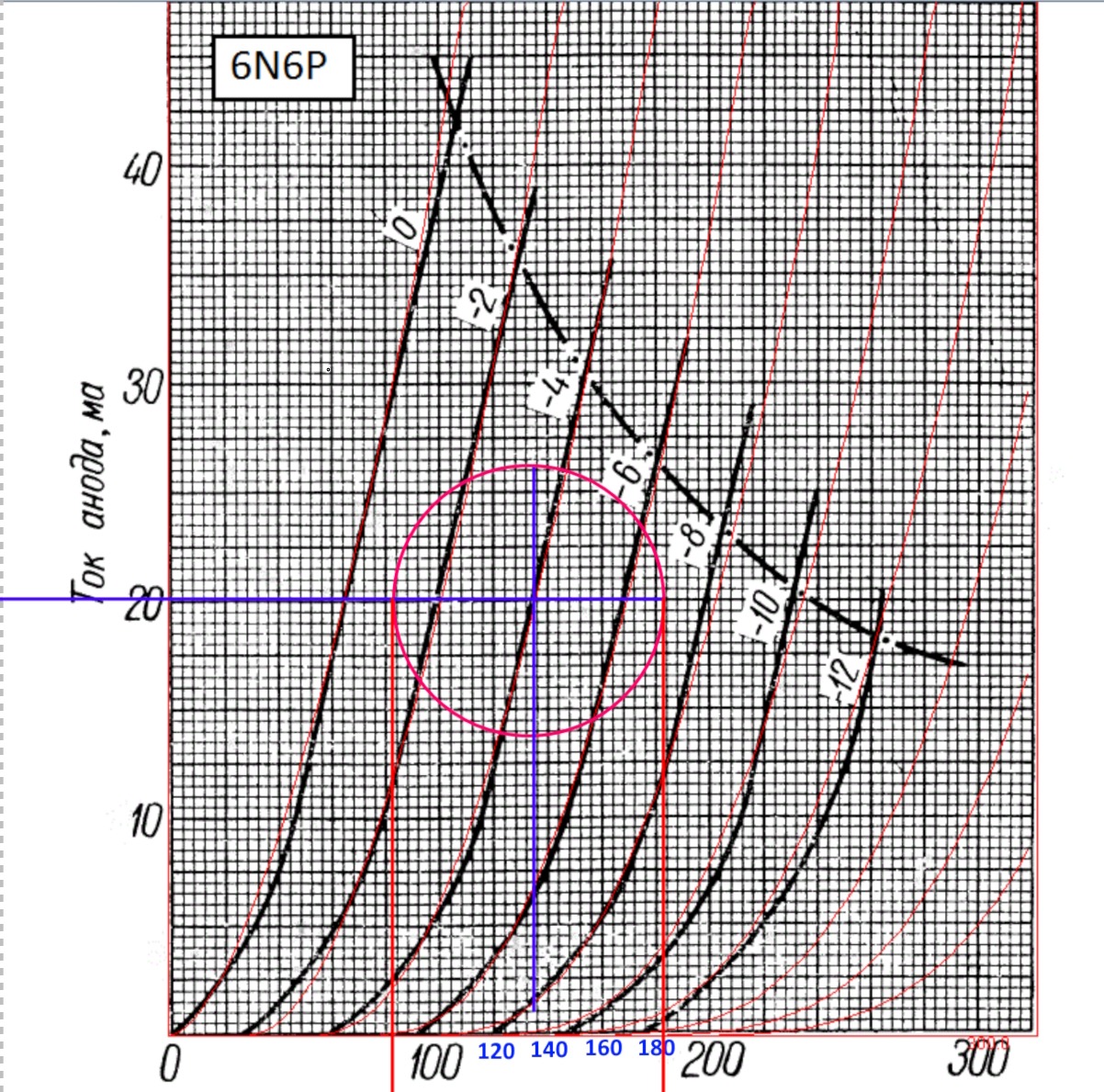

I'm for advice about 6N6P tube configuration loaded with CCS 10M45S as driver in SET amplifier with KT88 (triode mode). KT88 Q-point is Ua=390V, Ug=-40V, Ia=100mA and for driver 6N6P Ua=140V, Ug=-4V, Ia=20mA, B+=190V. Shematic and graph attached. I was expecting that driver will provide swing +/-40V plus +/-10V headroom, total +/- 50V = 100Vpp. After installation and power up measuremets for driver was a lot different than expected:
B+=188V, Ua=150V, Ia=20mA, Ug=-4V. Voltage drop on CCS is 188-154=34V
Problem is that I only have 60Vpp swing and after that is clipping. Output power only 10Vpp@8ohm = 1.2W. How to setup a Q-point with CCS that will be something like data on graph? Also I'm limited with power transformer source to 160Vac for dirver line B+. Can I use any other configuration without CCS to achive 100Vpp swing, except choke load? Maybe different driver tube? Or is it only solution to rewind this sec. winding to cca. 200Vac?

You have only 34V on the CCS so that's the limit of excursion on pos swing.
You need to lower Va, one way to do is increase the tube bias current so Va drops, getting more headroom across the CCS.
Or increase B+ while keeping same tube bias current /Va, that will also increase headroom across CCS.

How to calcuate current required for Ua=max 140V using CCS since CCS is dinamic resistance or how to calculate B+ required for qpoint 140V/20mA?
Reduce the 200R cathode bias resistor until you measure Ua = 140V.
Or until you get symmetrical clipping, indicating maximum swing. The only way to get more swing would be to raise Ua and/or reduce Ia.
Why such a low supply voltage anyway? I made the same mistake on a 6n6p headphone amp and got clipping when my mains voltage dropped at certain points of the day.
But you already have 350V in the unit.
You can R-C that down to anything you wish.

Your original operating conditions on the 6n6p are perfect; a shame to compromise that when the fault is the C+ being too low.
I would steal your 400V B+ and go to the CCS, perhaps with a little filtering.

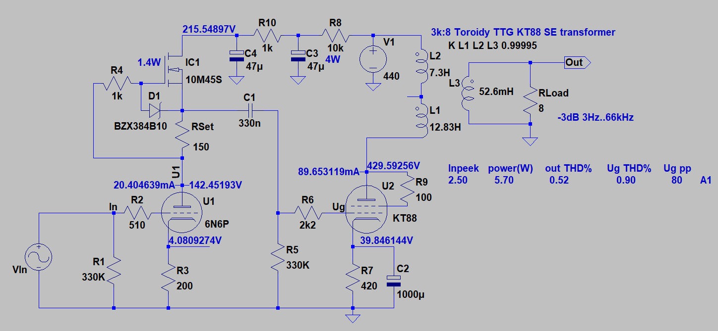

As @zigzagflux wrote, use B+ and filtering to power CCS.
Sample:
p.s. you original 10M45S sketch is wrong, the gate/stopper/ resistor is missing.
Sample:
What is the purpose of R4 and D1?
I don't want to use 350Vac (500Vdc at 1st 10sec.) supply because caps in driver filter are rated 450V. I'll need to use zener diode and 10K to decrease this voltage to cca 250V.

Where does the 10k come from? Have you calculated how much current the stage draws, how much current the zeners need, and if 10k is the corrcect value for the drop?

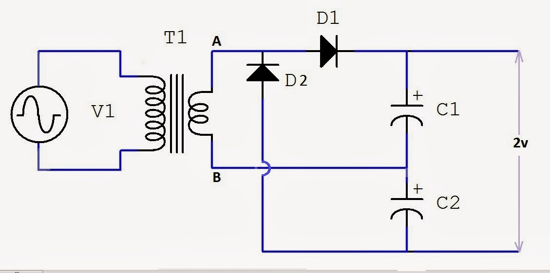

Assuming your power transformer's 160VAC winding has sufficient current rating, why not use a full-wave voltage doubler on that secondary? That should give you about 300VDC B+ for the 6N6P. That way you could drop at least 50V across the 10M45S and it would work better. It would also stay within the 450V rating of your capacitors. But the 160VAC winding would have to have a high enough current rating for the task.

With a ccs plate load, stage gain will approach the triode's mu. Mu for the 6N6P is about 20, so let's say you get 18x gain.
The grid bias is -4V.
18*4 is 72V peak.
KT88 grid bias is -40V.
That means it will clip with about 40V peak signal applied.

Without the R4 gate stopper, the Ixys device probably start to oscillate.What is the purpose of R4 and D1?
The D1 zener isn't absolutely necessary, but protects the current source device (G-S voltage limiting).
