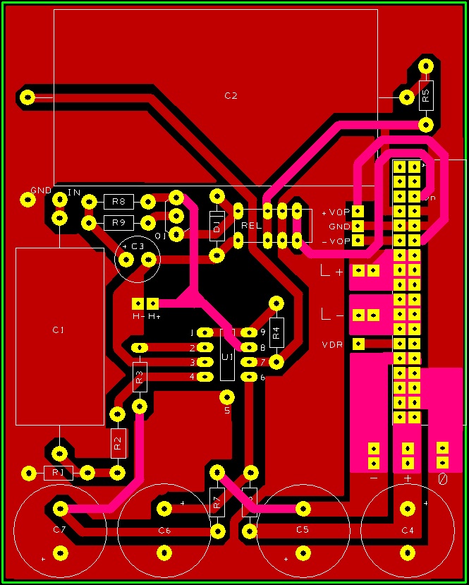

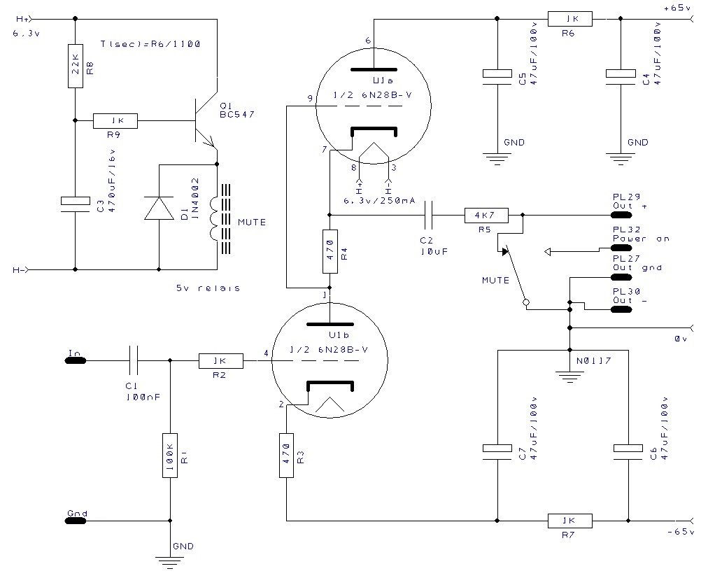

6N28/6H28 tube balanced preamp for Purify
Here schematic and PCB design(incl. gerber)for the unbalanced purifi preamp.

  • 6n28 buffer pcb 2.zip

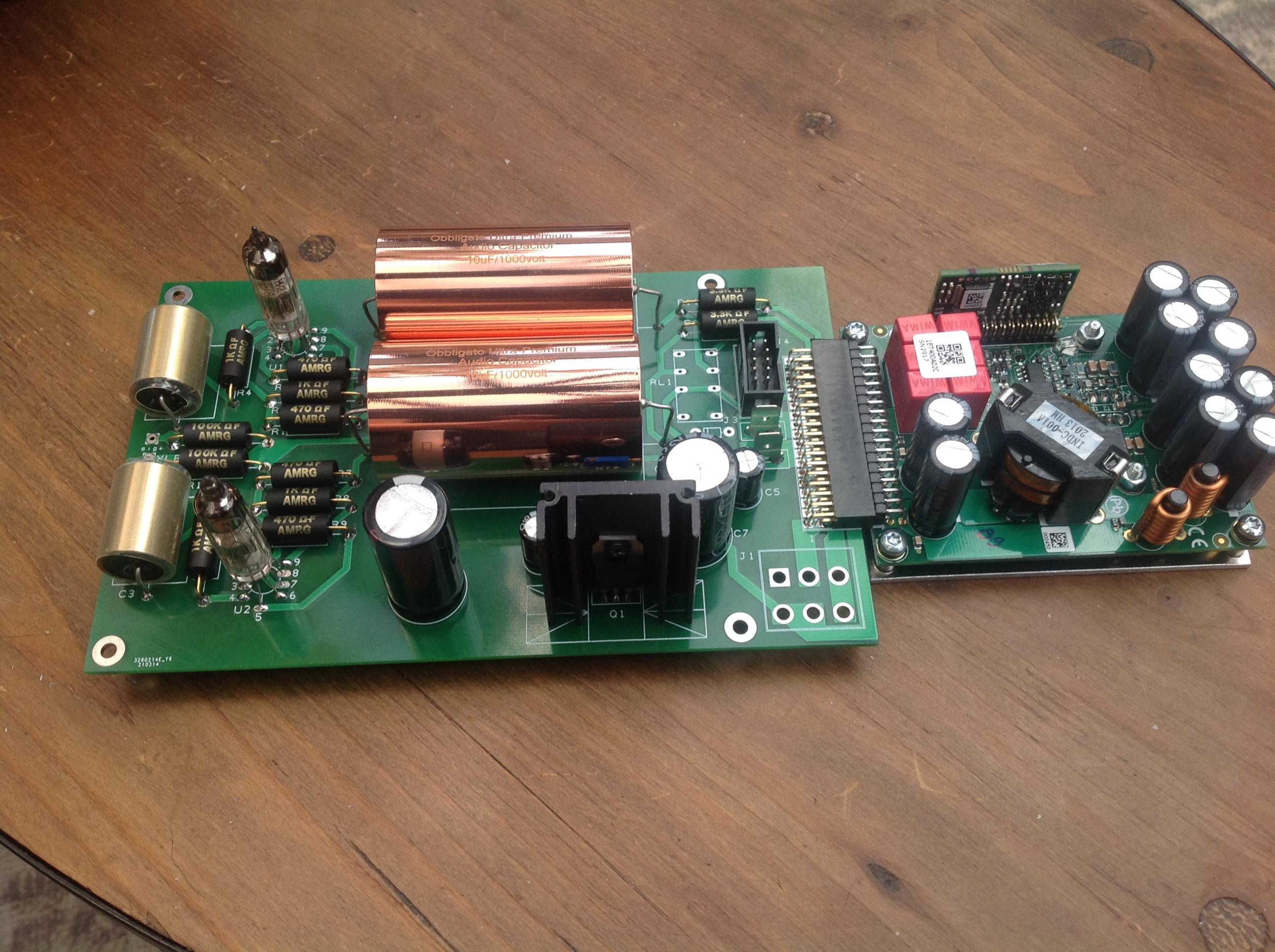

Sneak preview.
Just missing a view parts.
Material cost one channel with obbligato and amtrans about €100, With standard parts about €50 a channel.

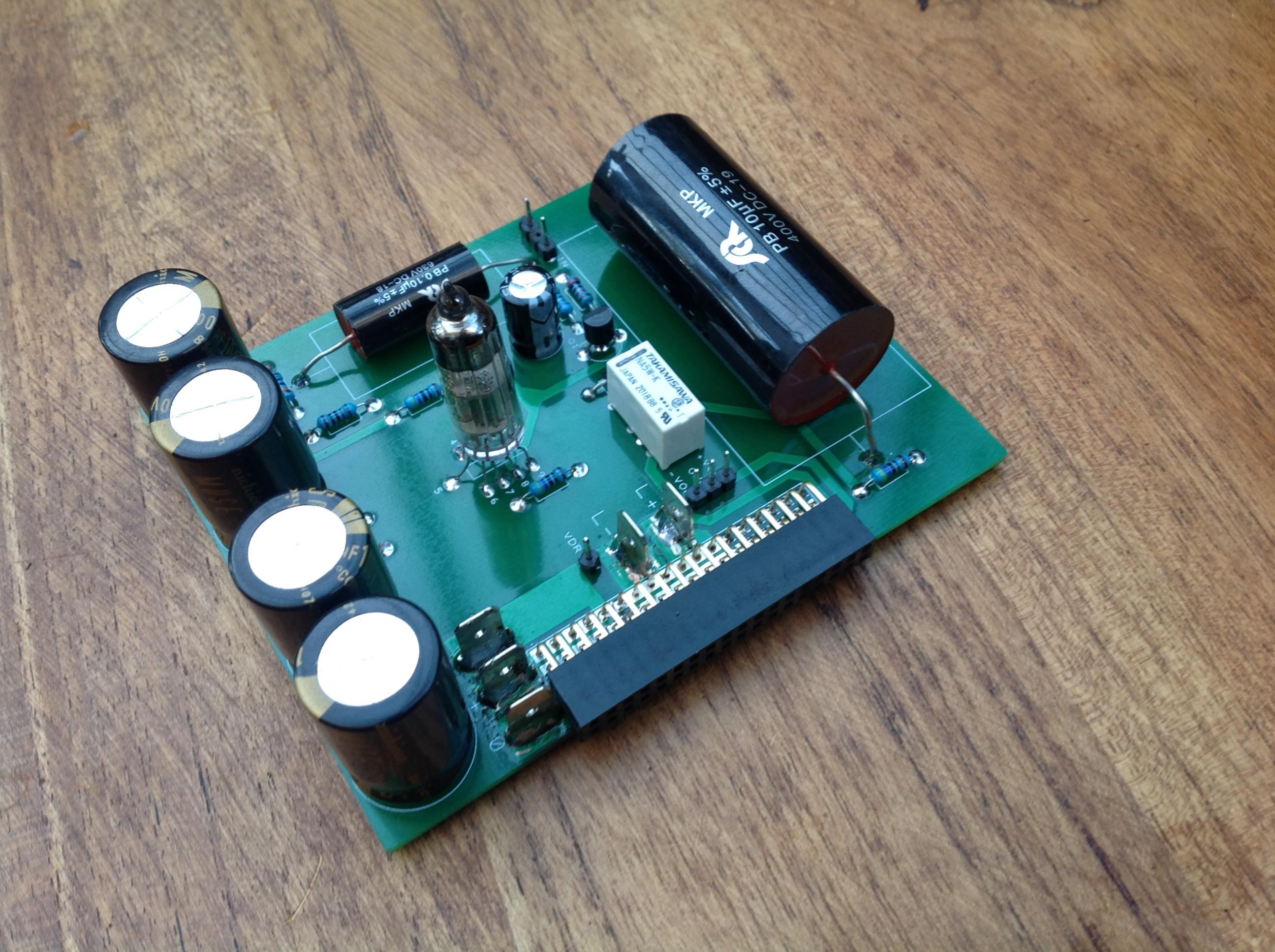

No spares but ordering 5 pcb's at jlcpcb is just €13 with shipping.
The unbalanced version sounds much like the eval board with little nuances different. Less analytic, different staging,
For the balanced version you must wait until i have all the parts. I also shall measure freqency respons, phase shift and distorsion of the two versions.

Looks like the output prior to the coupling cap is near 0Volts DC. If you used an opamp servo you could eliminate the coupling cap. This would require a relay or solid state switch to protect the output from DC.
I've been building balanced tube preamps with direct coupled outputs since 1989. I can tell you that they do benefit from getting rid of the coupling cap and a good class D module has plenty of resolution to hear the improvement.
I can confirm, the SQ often increased drastically when you drop the input capacitor. If you do not want to change an existing amplifier, it's often also a great improvement if you swap the input C to a better quality one. The improvement on LM3886 amps by removing the input capacitor and adding a DC servo was phenomenal. On many Class D amps the DC servo isn't possible though because of how the amplifier ICs work, that means the suggestion can maybe improve some amps but does not apply to all.
The removal of the input C got some considerable and effective improvements on a lot of amps but (unless you've add a DC servo or adjust the bias on P/P precisely) can also be dangerous because of the DC offset, which may fry your speakers but can also overload the output transformer (not sure if that's the correct term, not a native speaker, sry).
Actually I was referring to the output coupling cap(s). I've been running a tube preamp that has a direct-coupled balanced output, using a servo control to maintain 0 Volts DC Offset at the output. During warmup some DC voltages are generated until the tube warms sufficiently to pay attention to the control voltages generated by the servo. But these voltages tend to be low and my class D amp (which also has an input servo to deal with DC offsets at its input) has no troubles with it. So it presents no danger to my speakers if I start up the amps before the preamp.
