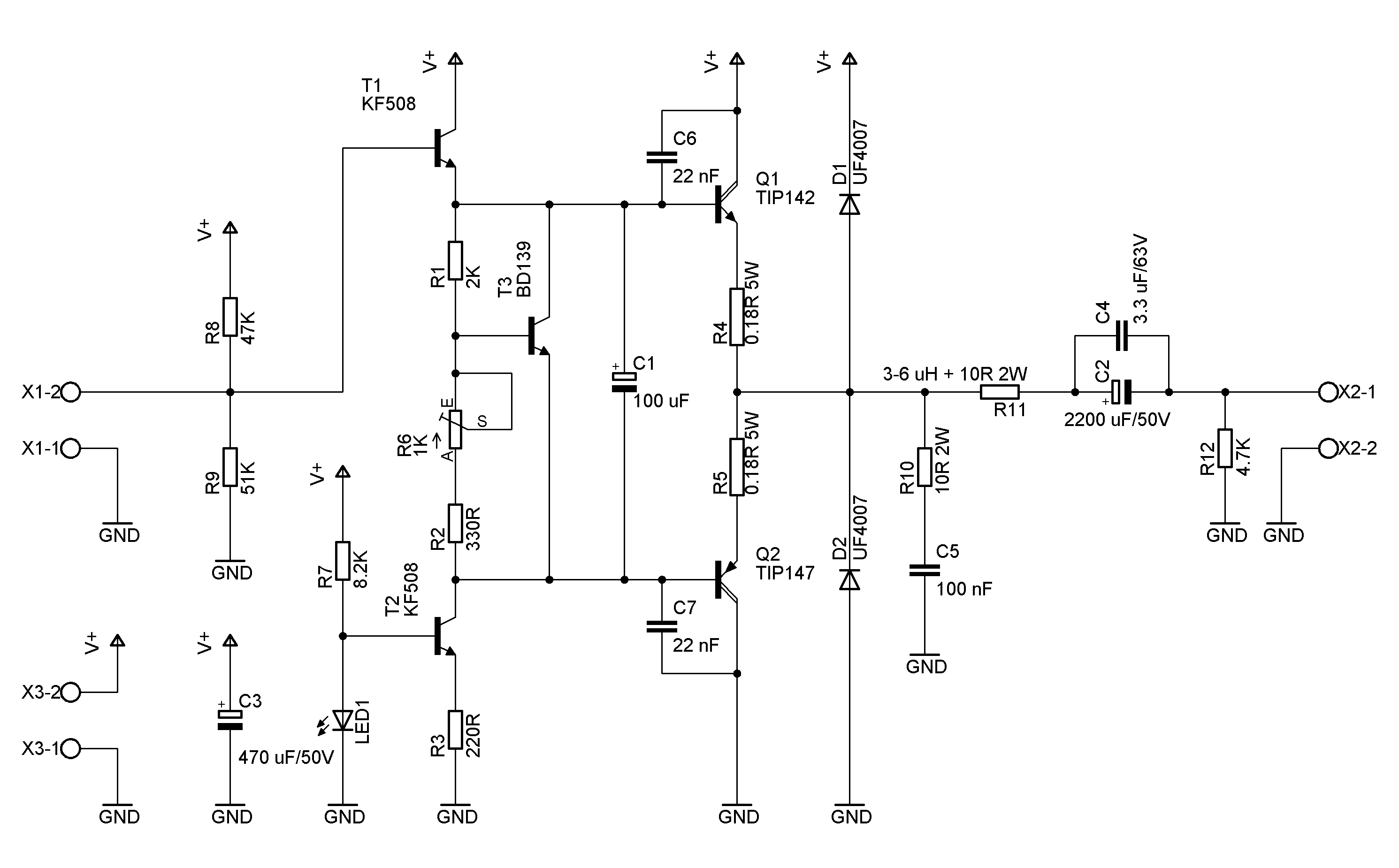

Tauri, give this output stage a try. You're using AC coupled output and a bunch of capacitors throught the amplifier as it is so the only difference is that this one is tested and works .. and it's dirt cheap 😀
For desired output power adjust your supply voltage and key components (such as C2 and C3) accordongly depending your anticipated load (speaker impedance).
48V or so DC should get you into 30W into 8R output per channel power range so 60W total. Component values indicated here are for lower power.
T1 & T2 can be replaced with any medium power (few hundred miliwatts of dissipation) NPN types with decent beta (100 is good, anything more is even better because R8 & R9 can be increased to lessen the AC load on tube).
R11 is not just a resistor, it has 10-12 turns of roughly 1 mm diameter enamelled wire wound around it.
LED1 is the cheapest (= low brightness) red color kind.
Once powered up, tweak R6 until you get few tens of milivolts across R4 and R5.

I can't say I follow this scheme allright.
1)What is the purpose of T1, T2 and T3 ? I mean, I see that signal is going to T1, and then to T2(wich in my eyes is the phase splitter)
Are they setting Q1 and Q2 biasing points ?
2)Why do we need LED1 and the diodes later(D1,D2)?
3)Also, I don't get it where Q2 gets its negative voltage?😕 What is marked as GND is common wire what is connected to chassis of the amp. How can there be voltage ?
No negative voltage supply used. This design runs on a single positive supply.
T1 is an emitter follower provides high impedance load to the tube driving it. It also sets the dc voltage on the output stage to midpoint.
I recommend you get Morgan Jones "Valve Amplifiers, 3rd Edition" it will explain a lot of things including some basic stuff about semi-conductors. Fun read too.
T2 is a CCS providing a fixed high impedance load to T1 - this is good for linearity.. The LED provides a voltage reference to the base of T2.
The diodes D1 and D2 clamp the output so that back emf from the speaker cannot damage the output transistors.
T3 is a vbe multiplier which is used to set the quiescent operating current in the output stage. (Q1 and Q2) Mounted on the heatsink it will provide some thermal compensation by virtue of the transistor's negative vbe thermal voltage coefficient.
Incidentally this circuit is one of several RIGHT ways to do it - a good design.

Arnulf circuit has no voltage gain of its own, so still needing triode up front.
Yes, this is the output buffer for tube front end, zero gain of its own. Its purpose was to eliminate OPT cost and shipping hassles from equation in order to encourage more people to delve into the wonderful world of tubes, it is a part of an article (a tube solid state hybrid).
Thanks to kevinkr for great explanation, I forgot to mention that T3 is supposed to be mounted on same heatsink as Q1 & Q2. I have it dead-center between both output darlingtons.
C3 is there just to take care of transients, PSU is on another PCB and has its own filtering capacitors which are significantly larger than C3 (2200 uF per ampere of anticipated peak current or larger) ! There simply is no room for larger capacitors on PCB for the buffer.
Perhaps I should also mention that this buffer fits onto a rather small (8x8 cm) single-sided PCB with zero jumper wires or vias so it can easily be etched and drilled at home.
