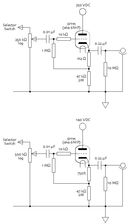

Hi tube-nuts! I have spent endless hours looking for simple but good line-amp designs, preferably using 6N1P tubes. All I have to show for it so far is gigabytes of downloads and a massive telephone bill. (And a fair amount of confusion!)
Can anyone suggest something not too difficult? I am a newbie to tubes, but I know without any doubt this is the way I want to go. Gain can be anything from unity to about 5x. I am replacing my passive pre and I have just enough gain with it at the moment, but a bit more would also be okay.

Hmmmm...
Too much gain from the mu-follower probably and unity gain from the WCF.
Somewhere inbetween there's that nice SRPP circuit which will do nicely provided you build it a nice PS and don't use too long and too capacitive interconnects. Never too bright an idea anyway.

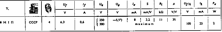

Make sure you look at the correct datasheet for the 6N1-P. There's quite a bit of rubbish being spread over the net about that one....

6N1P are beautiful in mu-follower or Loftin-White CF stages

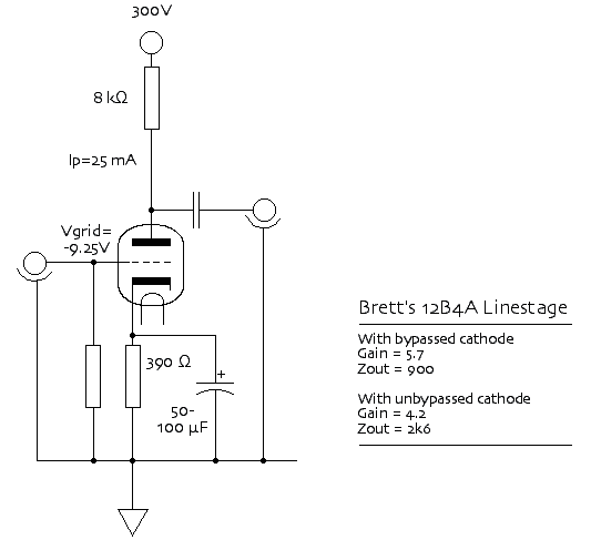

A simple grounded cathode circuit with a low-mu triode like the 12B4 is reputed to sound good. If you are willing to use transformer-coupling (which is of course more expensive because of the transformer), olden-day 1930s triodes like the 56, 76 etc are also reputed to be good-sounding.

The 12B4A is a great option and will give the specified performance at modest cost, cheaper than the OPT option. I've posted my variation on that theme several times before on this board. Using such a high mu triode (6N1P) to try to get a stage with a 0-5x gain is not the best choice imo/ime.audiousername said:hihopes,

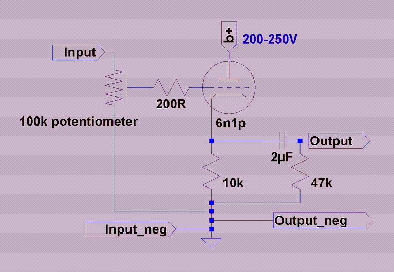

Nothing wrong with a 6n1p. If you don't need more gain..just go for a 6n1p in cathode follower mode.

I've added a little example of what you could try. It's not tried and tested...just a ballpark 6n1p cathode follower..Build it and tell us what it's like...
One more thing you should ground the filament both sides with a little 100R resistor.

4) I have downloaded 3 6n1p spec-sheets (2 of them Russian and English side by side). How do I know which are the correct specs?

If the English one is one from Svetlana then that's the one with the overly optimistic data...
Here's one I believe is accurate:

My personal recommendation would be for Brett's 12B4 circuit. I reckon it would work (and sound) a treat with a good power supply! (unless of course you have power amps which can't stand the 900 ohm source Z, which since you were using a passive attenuator, I assume you don't)
