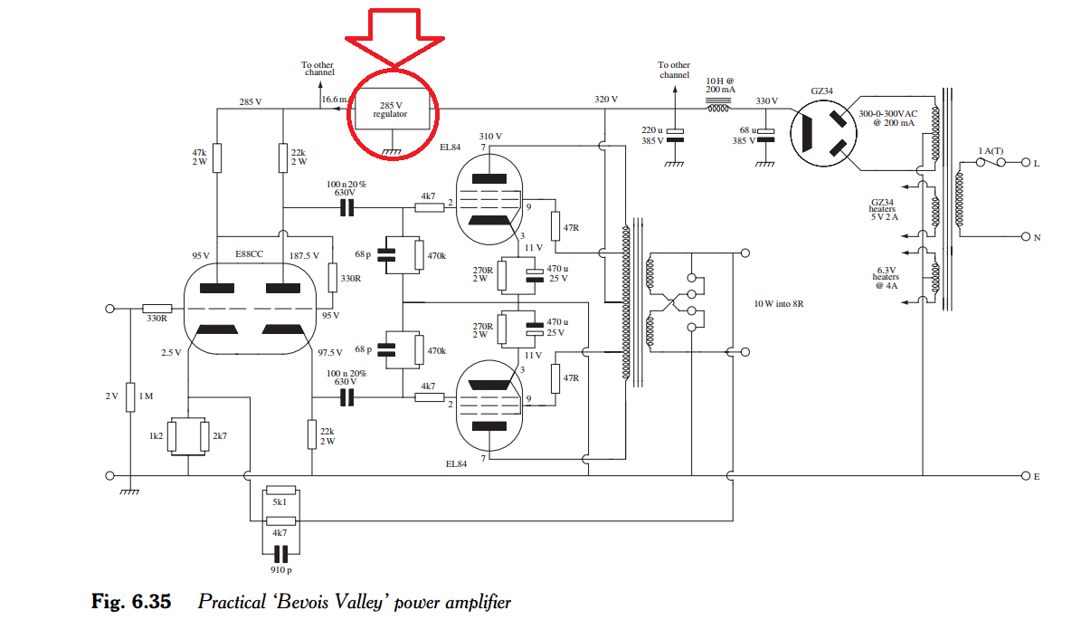

In addition to the previously mentioned Merlinb (Valve Wizard) cathodyne, a favorite version of a push-pull EL84 amp using that type of driver circuit is Morgan Jones' 'Bevois Valley'. It's on page 454 (figure 6.35) of his "Valve Amplifiers" 3rd Edition.
Valve Amplifiers - Morgan Jones - Google Books
You can see the schematic in the preview linked above.
6N1P isn't the same as an ECC88, but it's in the ballpark.

Thank you so much Rongon,
Do you have high voltage regulator to drop B+ 320VDC to 285VDC as in the book?

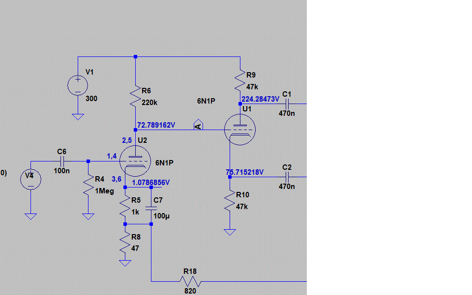

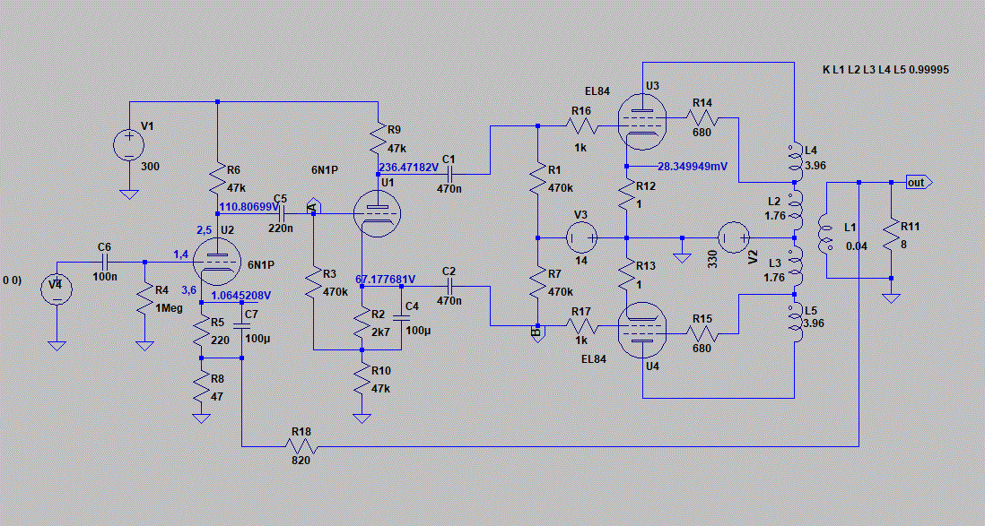

This is an UL circuit with 8k output transformer. Output power is 15 W with about 1 Vrms input voltage. Less than 10 dB GNFB is used. Fixed bias output stage gives higher output level and lower THD.
The above 'Bevois Valley' needs modifications to voltage amplifier/cathodyne if 6N1P is used.
Thanks! This could be an alternative to "El cheapo" amp style . I already have many 12AT7 (or ecc81) to make an LTP but 6N1P tubes are not expensive.
