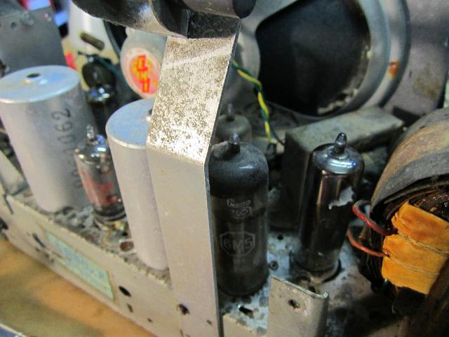

Anyone had experience with this relatively obscure valve?
I think its an EL80, or an EL41 in a different package
I picked up an old Kriesler radiogram from the side of the road, still in working condition (turntable missing), with schematic on the back(built 1970), good 6" full range speakers.
The amps are 1/2 a 12AX7 driving a 6M5, about 3-4 watts. It has an interesting bias circuit, 'back' bias (Aitken amps has an article on this on their site), basically derived by lifting the power trannie CT above ground with a resistor.
I'm thinking of converting it to Cathode bias, and using both sides of the 12ax7 in series to make a little guitar amp, similar to a Fender champ, unless there's a collector with something to swap in the Sydney area who wants to stop me butchering the unit.

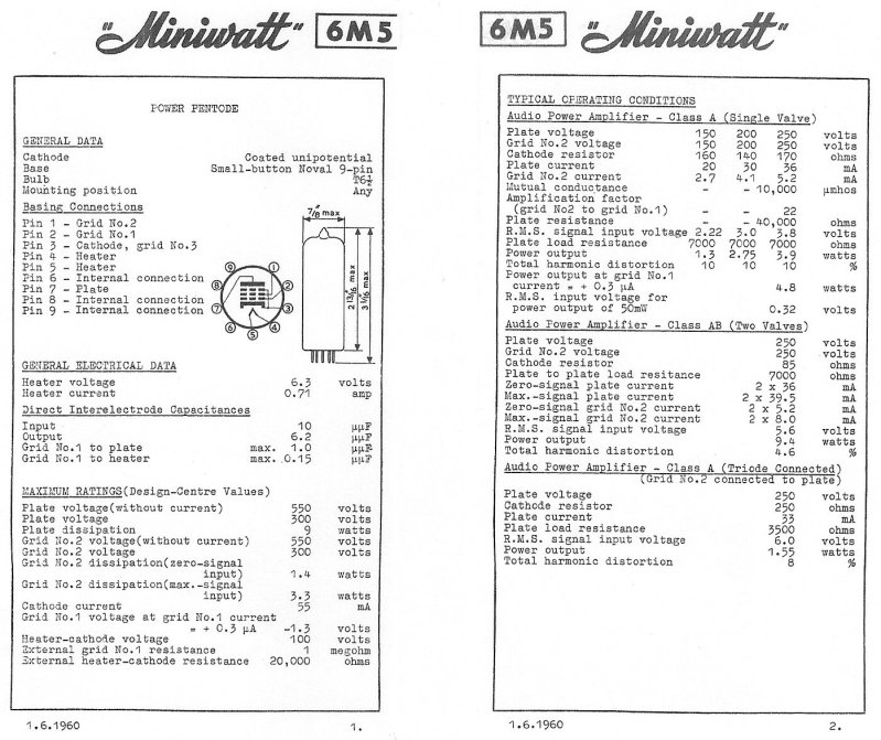

6M5
According to what I found the 6M5 is a Mullard valve and an equivalent of the EL80.

All the graphical information for the 6M5 in my data book is identical to that given here: http://tubedata.milbert.com/sheets/030/e/EL41.pdf Even the title of each page has not been corrected from EL41 to 6M5.
Thanks for that darryl_h, as that helps confirm. I didn't find that EL41 datasheet link, but another abridged version had the anode curves. The scottbecker site is down, which is where I normally go.
I can't identify any change in the optimal loading curves shown on pages 11 and 12 of your linked datasheet for EL41 (?), except for the dates - maybe they changed physical packaging, or moved manufacturing plant.

as the 6M5 and EL41/6CK5 tubes electrically are identical, you can also have a look at the data and curves of the pentode sections of the ECL86/6GW8 and PCL86/14GW8 respectively, which are almost the same.

The 6M5 (noval) is a EL41 (rimlock).
The E80L is allmost the same, don't know if a EL80 ever existed.
