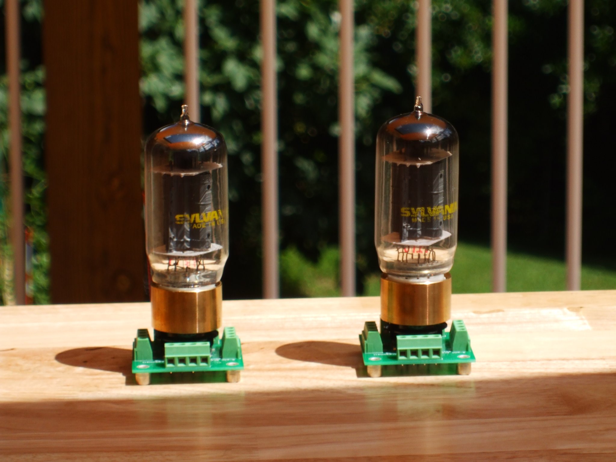

Some brass plumbing pipe skirts:

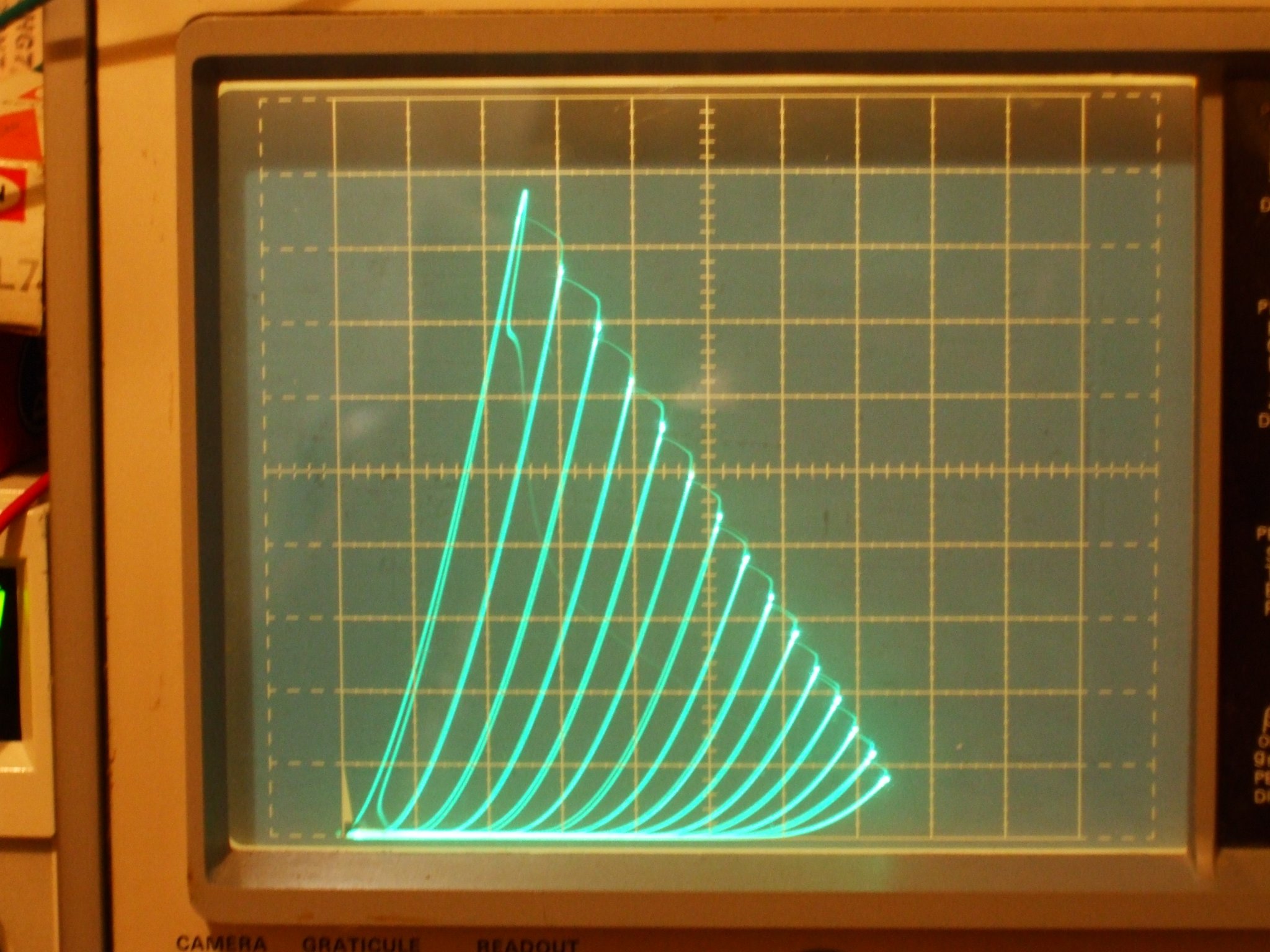

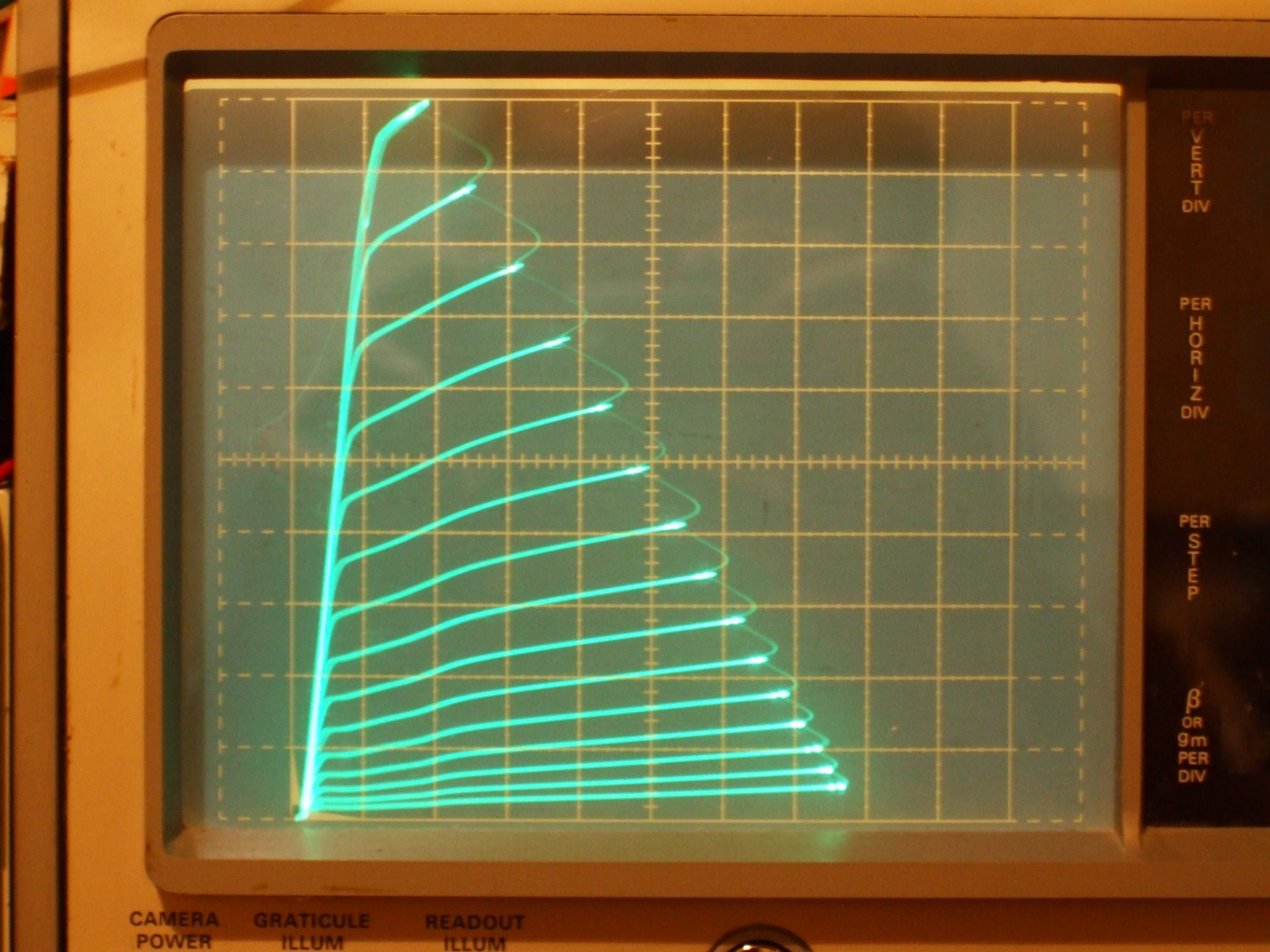

Some plate curves (Sylvania) 50ma/div Vert. 50V/div. Horiz. 140V screen grid, 2V steps grid1

--KV6 (gm 9500 @ 80 mA, mu 4 ) is close to a 6HJ5 (gm 10,000 @ 80 mA, mu 4.2 ). The 6HJ5 saw a lot of resistive Schade builds on the Pete Millett Engineers Amp 50 Watt Monoblock PC board. Using a 4.3K OT. And George took them up to 75 Watts and more.... Using a 3.3K OT.
http://www.pmillett.com/DCPP_MB.html
6HJ5 50ma/div Vert. 50V/div. Horiz. 108V screen grid, 2V steps grid1
Note: The Sylvania --KV6 has a little higher Rp than the 6HJ5, however the RCA --KV6 has lower Rp, similar to the 6HJ5.

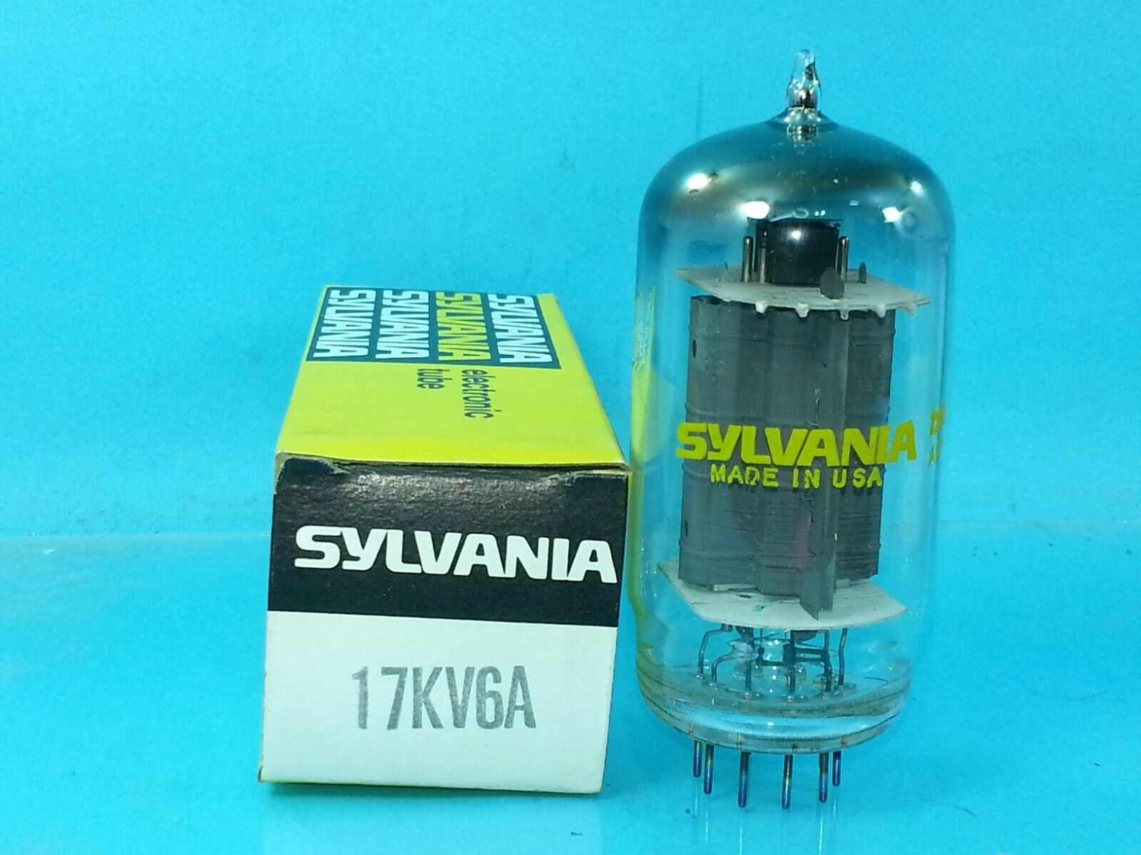

I don't have a Schade curve set handy for the 17KV6A, but 6HJ5 is close to the same tube except for slightly higher screen V.
Here are some curves that I have:
17KV6A in triode configuration: (50 mA/div, 50V/div, 6V steps grid1 )

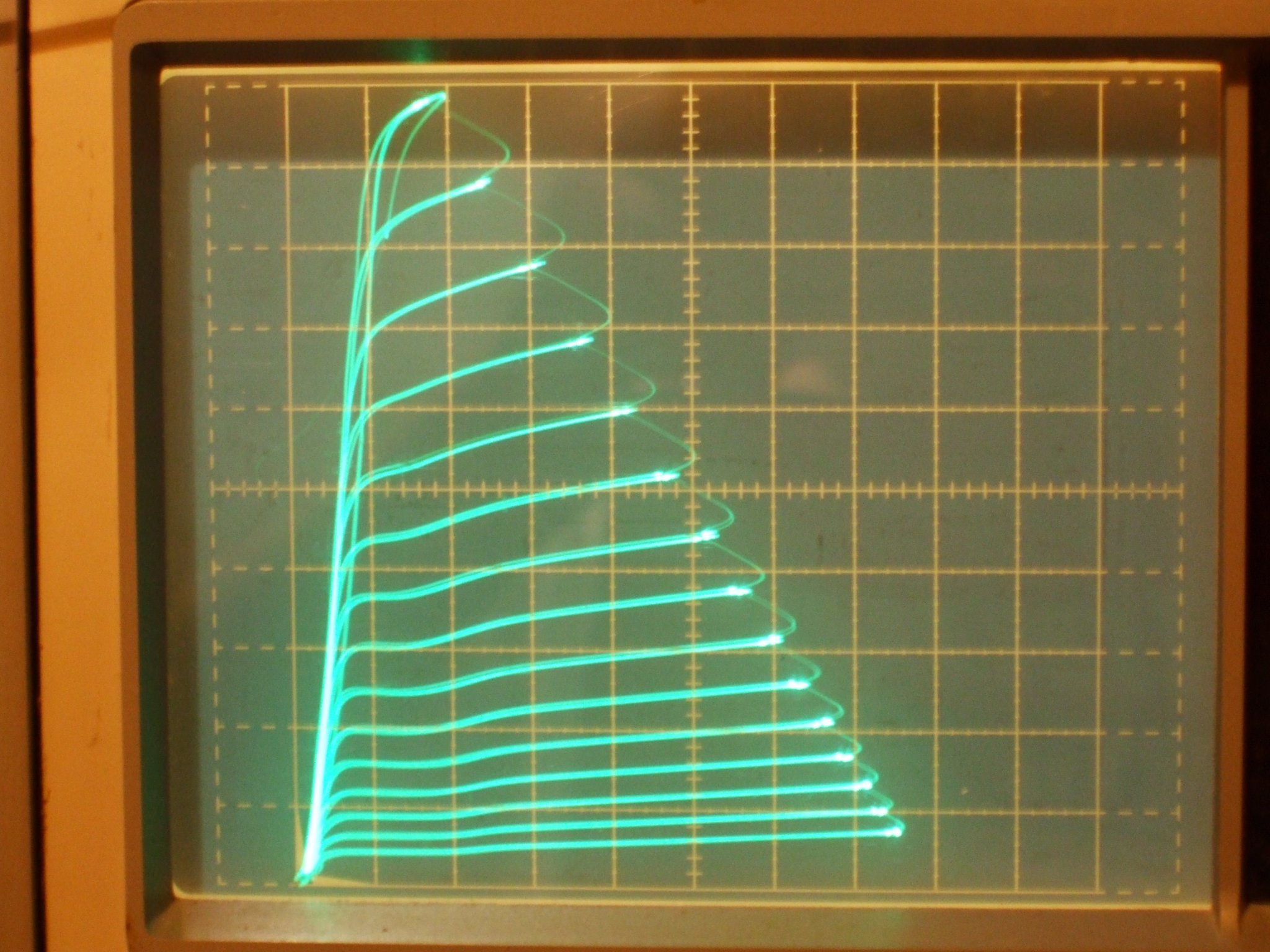

6HJ5 in triode configuration: (same setup 50 mA/div, 50V/div, 6V steps grid1 )
6HJ5 in UnSet: (6KV6 should be very close to this, nearly same gm, Schade resistors running the show ) Of course the mu will depend on the Schade resistor ratio. I have it set up for about the same mu 4 as native mode (for comparison ) (50 mA/div, 50V/div, 6V steps grid1 )
