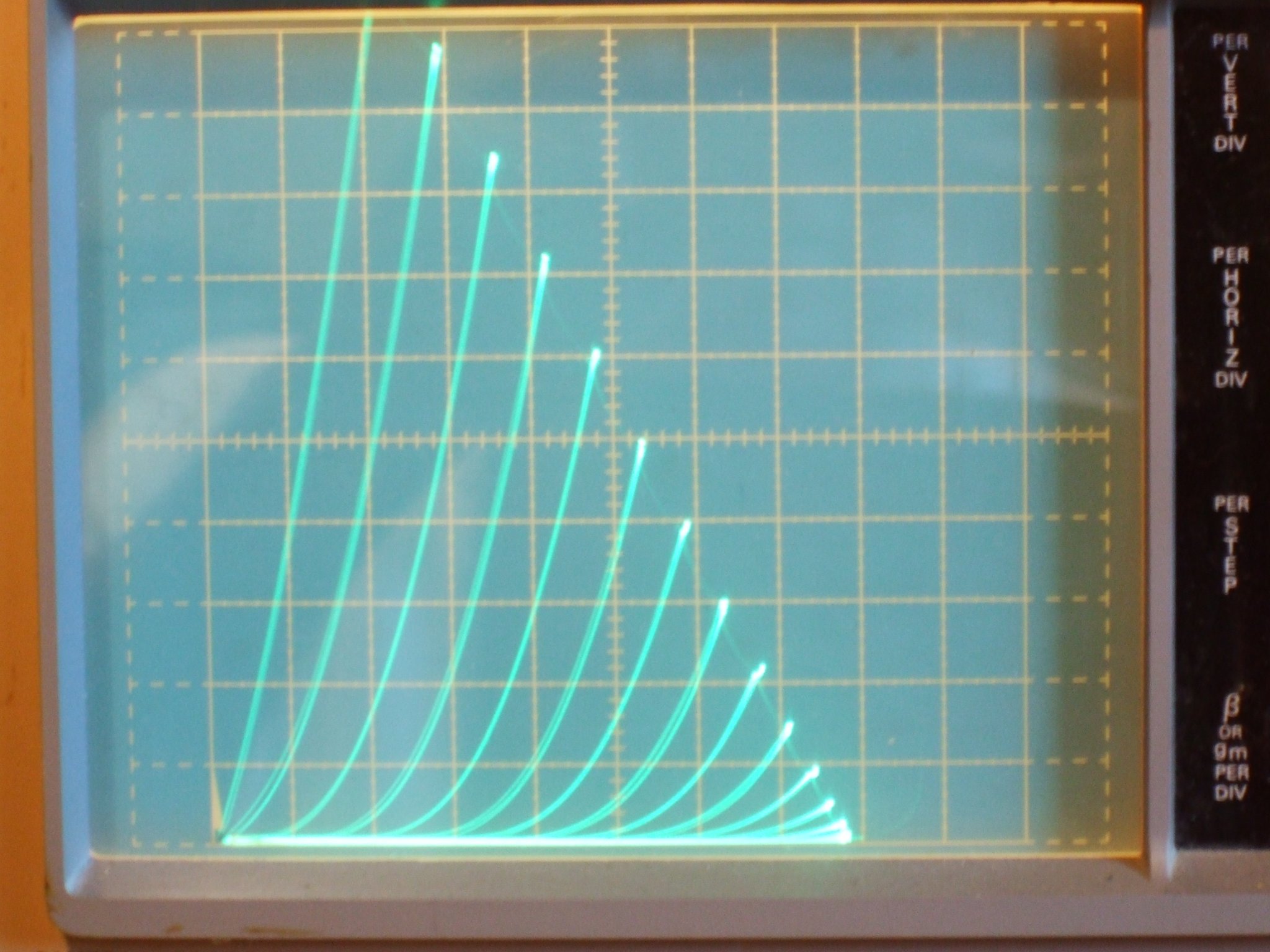

Here is a Sylvania 6KT8 pentode section in triode mode. 50V/div Horiz., 2mA/div Vert., -1V steps

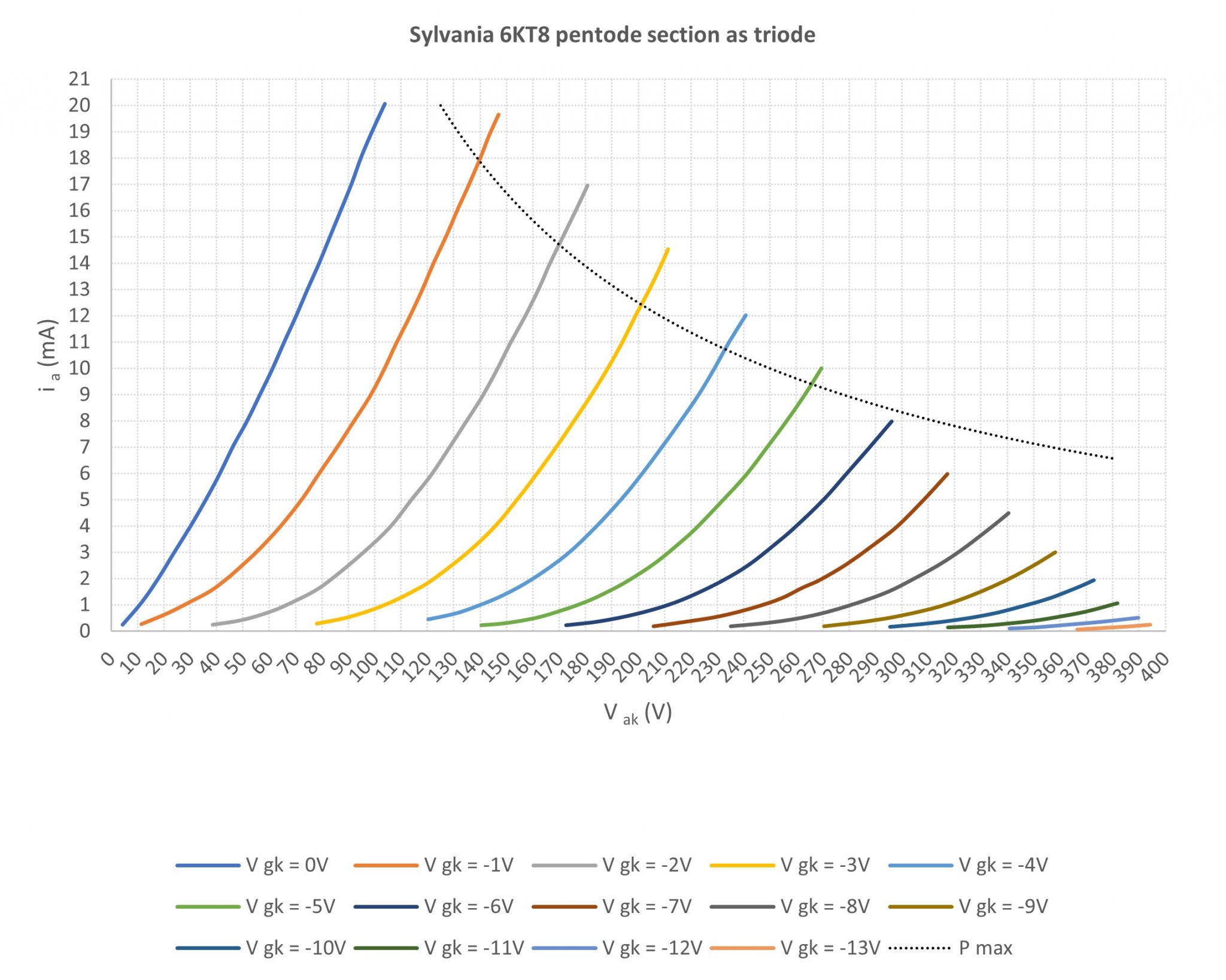

Thank you, Smoking Amp! I have taken your oscillograph, converted the traces to data points and loaded them into an excel spreadsheet (.xlsm fille attached).
At first blush, operating the 6KT8 pentode as a triode with Vak=145V, Vgk=-2V and ia=10mA gives:
  • fairly constant mu=-41 for +-1.5V swing; though
  • rp will swing from 4.4kOhm @ Vgk =0V up to about 5.5kOhm at Vgk=-4V;
  • with a corresponding swing in gm from 9.6 mS @ Vgk=0V down to about 7.7mS at Vgk=-4V
All that is indeed very close to the 6BN11 pentode when strapped as a triode, albeit with a lower maximum allowable plate dissipation of 2.5W for the 6KT8 compared to the 3.1W allowed for the 6BN11.
